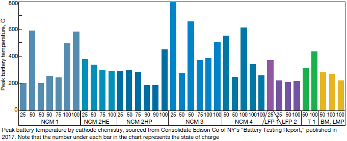

Still, GT experts will recognize some analogies to their facilities. For example, performance of lithium-ion batteries, the prevailing technology, is affected by ambient temperature. For GTs, it’s efficiency and output. Batteries, however, chemically and physically degrade; deviations from ideal operating temperature can have “severe consequences” on battery cell life (chart)—just think of your digital devices. Parasitic energy is consumed to maintain that ideal temperature within the enclosure. Assuring uniform flow of coolant around battery pack outer enclosures is essential, but a challenge.
