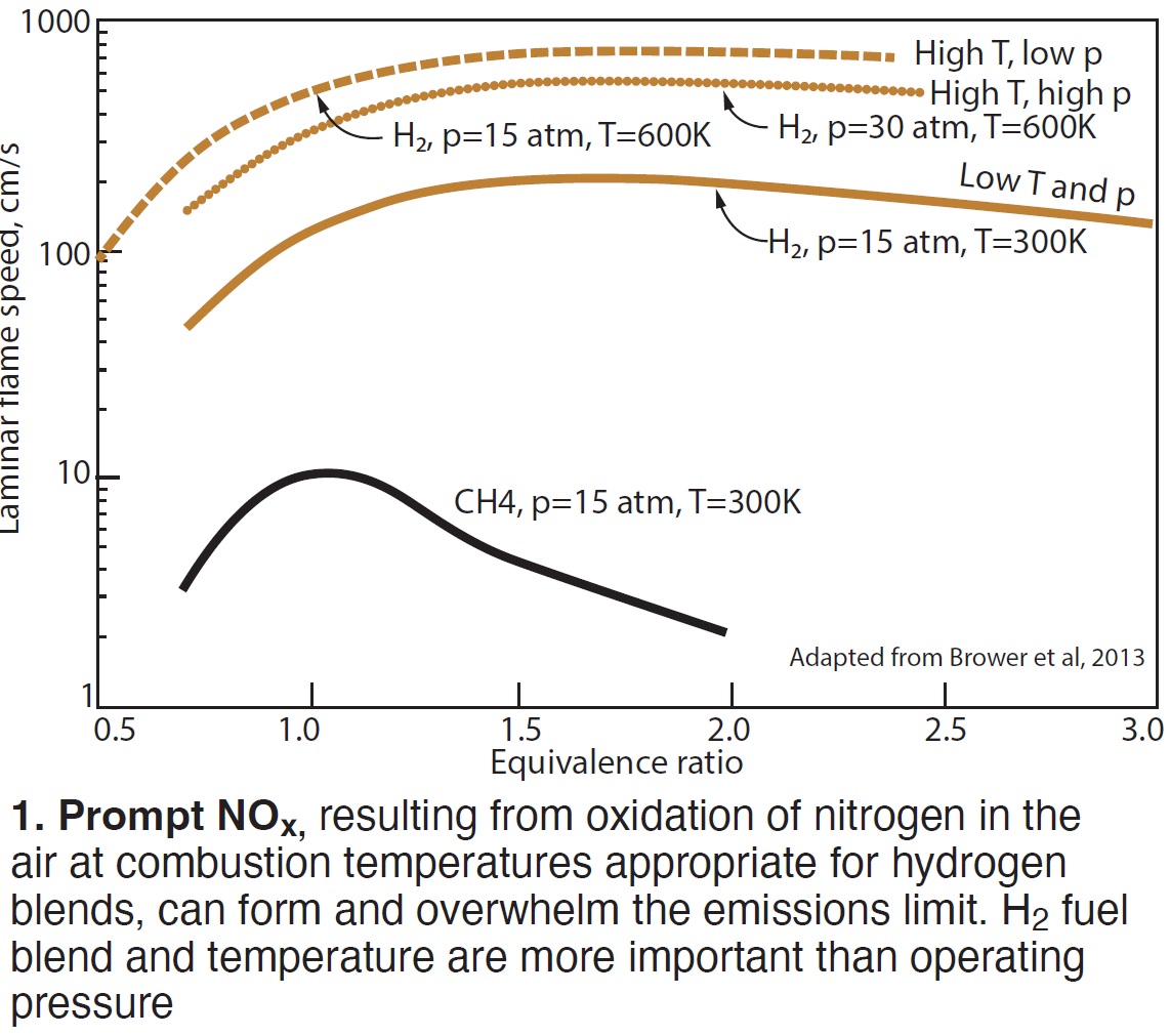

H₂ for Gas Turbines—a Technical Overview, Griffin Beck and Brian Connolly, Southwest Research Institute. Presenters dove into the intricacies of hydrogen combustion versus natural gas and other fuels. The fuel blend percentage and combustion temperature are more important than pressure, they stressed. Additional “prompt NOₓ” (Fig 1) can form from the oxidation of nitrogen in the air (as opposed to the fuel) at the higher combustion temperatures. H₂ can improve flame stability and extend the lean blowout limit compared to NG. But flashback hazards are amplified.

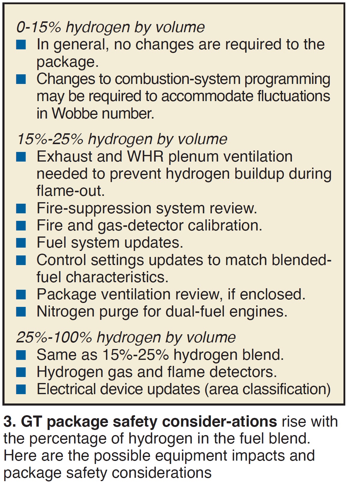

Impacts of H₂ Blending on Mainline Natural-Gas Compression, David Campbell, Enbridge. Up to 20% hydrogen blends raise the parasitic power consumption of the compressor by up to 25%. Thus, the GT consumes more fuel to maintain an equivalent amount of natural gas moving through the pipeline, raising the specter of more carbon discharged rather than less. On top of that, a 20% blend in the pipeline drops its energy content by 14.5%.
This is in addition to the equipment impacts (Fig 3) noted elsewhere—such as flashback, auto-ignition, and combustion instability. Presenter suggests that 20% blends in pipelines are probably achievable after review and equipment modifications, but 2.5%, ramping up to 5%, is a good initial goal.
