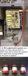

Adding cost-effective and noninvasive fire protection
Challenge. With our facilities’ fire protection system requirements becoming more stringent, including systems that were not originally designed with fire protection, it can be hard to find a traditional system that can be installed practically and cost- effectively. Cost, time, monitoring ability, fire-protection effectiveness, and ease of installation were all factors that posed a challenge on these legacy units.
Solution. Plant personnel researched fire suppression systems used in many industries and found a solution from Firetrace International LLC, Scottsdale, Ariz. This system uses a tubing detection system for fire that can detect and direct suppression to a specific point where a fire starts. Fig 1 shows the installed cylinders containing the suppression agent, NOVEC 1230, which is safe to humans and can be used on several classes of fires including electronics. Fig 2 shows the Firetrace line wound throughout motor control centers requiring fire suppression.
Once fire contacts the Firetrace wire, the bottle containing the suppression agent opens to dump its contents. This offers the ability to provide localized protection which is easily integrated into a plant’s annunciating system for remote indication of activation. Installation of the system was accomplished with a minimum of outage time.
Results. The Firetrace system provided both a practical solution to assure compliance with fire protection requirements, including NFPA, and enhanced safety for plant personnel and equipment.
