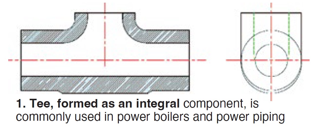

Henry leads off with premature failures of formed tees, stressing that we are looking at intersections designed and fabricated according to ASME B16.9 standards, Factory-made wrought steel buttwelding fittings.

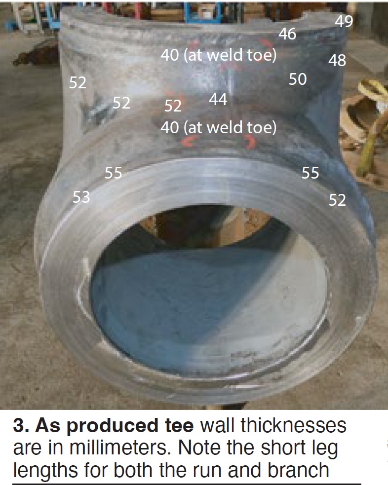

The webinar focuses on the branch-type configuration commonly used in power boilers and power piping. These are geometrically complex components (crotch, branch, etc). During manufacture, it is absolutely critical to keep geometry and thickness consistent (Fig 1).

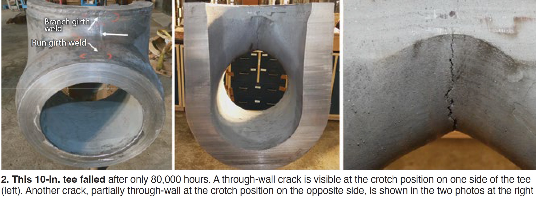

Attention turns to a failed 10-in. tee in a South Carolina coal-fired plant after 80,000 hours. This occurred at just over 25% of the expected life of a P91 tee.
Primary areas of damage are a through-wall crack at the crotch position and cracks at the toes of both the run and branch girth welds (Fig 2, left). The through-wall crack at the crotch position is ID-initiated. Cracks at the toes of both the run and branch girth welds are OD-initiated.
Henry stresses that the plant experienced similar damage in multiple tees on two units. Material specification for all was Grade 91.
He then reviews details of the cracking on both the OD and ID surfaces, and specifics of damage profiles and crack development (Fig 2, right). He emphasizes wall thicknesses and notes the “short leg length” for both the runs and the branch.
Discussion then moves to chemical composition of the steel. The as-tested composition was not as specified, but neither was this the real problem. Henry explains that although composition was not the root cause, this does indicate a problem with quality control in manufacturing.
He also discusses minimum wall thickness according to Code. In this case, the center of the crotch position had the thinnest wall of the tee (Fig 3) and right at the specified minimum wall thickness of 44 mm according to B16.9.
