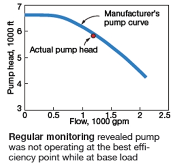

1. Performance. Performance is continuously monitored by comparing real-time operating characteristics to design curves. Real-time pump conditions are plotted against the manufacturer’s data to determine if the unit is performing as expected.
2. Pump modeling. Performance pump capacity surveys are taken biannually to ensure the pumps are operating according to the manufacturer’s “pump curve.”

Results. These techniques have given the plant the ability to identify abnormal pump operating characteristics and pump degradation, helping plant staff to quickly recognize problems with critical non-redundant pumps. For example, the plot shown in the figure indicated that the boiler feed pump was not operating at the best efficiency while at base load. As such, this boiler feed pump will be replaced during the upcoming annual outage, prior to failure.
