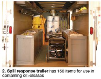

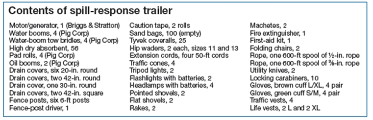

Finally, if a spill does make it offsite to the stream, the plant has put together a spill response trailer with 150 items (Fig 2) that can be used to contain oil releases on moving water (sidebar). Plant personnel periodically hold spill-containment exercises which helps them identify the best access points along the stream to intercept a spill, as well as how to properly deploy the spill containment equipment.
