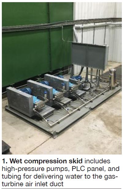

Wet compression. When used in conjunction with the existing evaporative coolers, the wet-compression phase of the project increases GT output by 13 MW—when the ambient temperature is between 60F and 90F. Wet compression works by injecting demineralized water into GT inlet air to increase mass flow, hence gas-turbine output. Unit efficiency increases as well: A 10% boost in output is achieved with an 8.5% increase in heat input. Use of wet compression at Milford increases demin-water consumption by 80 gpm.
Equipment required for the wet-compression project included a spray-water delivery system (tubes and nozzles installed in the inlet air duct); a water transfer skid with pumps, piping, and controls (Fig 1); and interconnecting tubing between the skid and nozzle array. The nozzles are located downstream of the inlet silencers and are sized to achieve a uniform spray pattern and to prevent droplet formation to the degree possible. A drain line in the air inlet duct was increased to prevent accumulation of the additional water required. This drain was piped to a collection sump for use as cooling-tower makeup.
An observation window was installed on the inlet scroll, positioned opposite of the spray array to monitor the spray pattern.

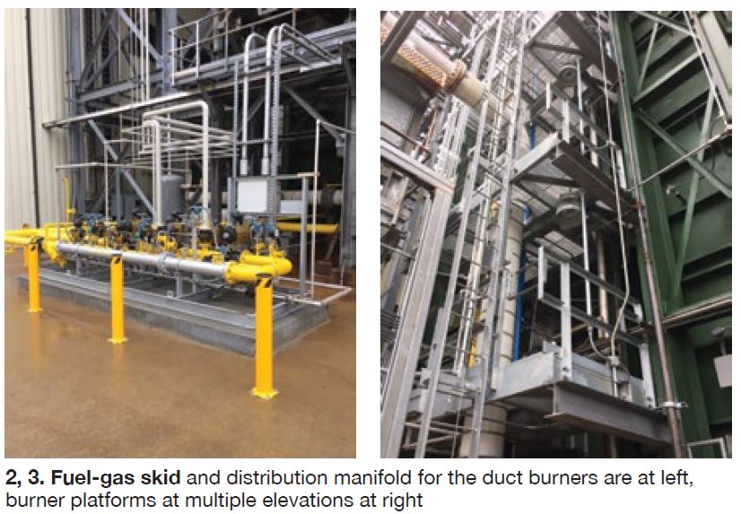

Duct burners added a nominal 500-million Btu/hr at the front end of the existing HRSG within an existing lined burner cavity (Figs 2 and 3). The seven new natural-gas burner assemblies, each equipped with pilot and flame scanner, doubles the HP steam flow to the turbine, thereby doubling electric production of the steamer.
Equipment added to support the duct-burner system, and the additional steam flow, included the following: new HP-superheater manifold piping; new trim for the HP steam and feedwater control valves; replacement of nine existing 1-in. HP-superheater drains with 2-in. valves; access platforms for each duct-burner assembly (one on each side of the HRSG), new fuel-gas piping, manifolds, and distribution skid; air blower for cooling air to the flame scanners; and a new compressed-air supply receiver for purge air.

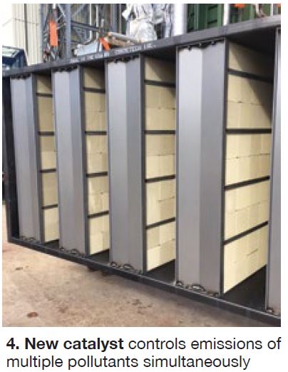

The existing SCR catalyst was replaced with a multi-function catalyst to control emissions of NOx, CO, and VOCs in accordance with proposed limits of 2 ppm for NOx, CO, and ammonia slip (Fig 4). The new catalyst combines the catalytic function of SCR NOx reduction and CO/VOC oxidation into a single catalyst layer.
Note that use of the duct burner is limited by the current ambient air plan to the heat-input equivalent of 2000 hr/yr. The pressure drop across the catalyst is 1.5 in. H2O.
The existing ammonia delivery system and injection grid were reused. The grid manifold and piping were vacuumed and the nozzle openings cleared of any blockages. With the existing catalyst removed, it became necessary to repair the upper support bracing and locking mechanisms used to secure the catalyst frames on the downstream side.

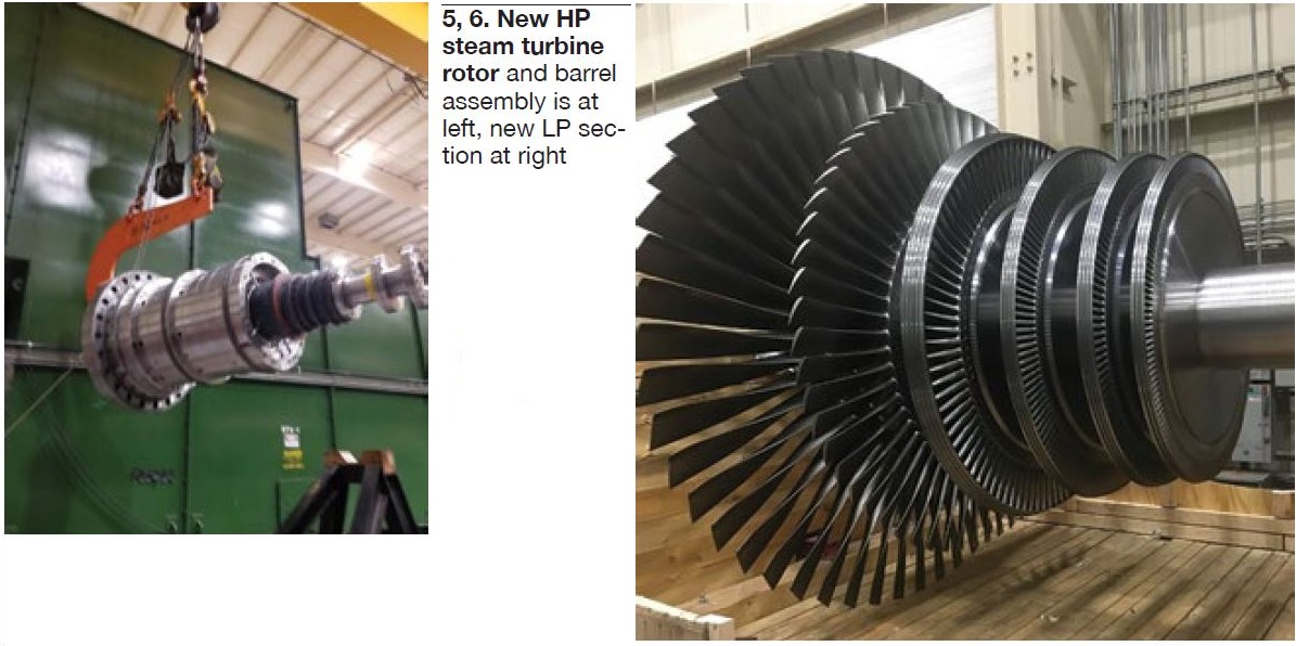

The steam turbine was uprated to 93 MW from 42. The new HP cylinder features a more robust blade-path design using the existing casing and inlet control valves to address the higher steam flow (Fig 5). The new LP turbine also was designed with a robust blade path, as well as other improvements (Fig 6).
The original mechanical overspeed trip was disabled and a new hydraulic trip block with speed probes to support integration of the replacement electronic trip system within the Emerson DCS was installed. Additional monitoring and performance measurement instrumentation was added to both the HP and LP turbines in support of the project’s final testing.
Steam admission and extraction valves were disassembled and inspected, with some suggested OEM service-bulletin betterments applied. The HP casing was inspected where indications were found in the area of the HP inner gland and valve seat areas. These were removed as recommended by the OEM with no further corrective action.
New thrust-bearing shoes and liners were installed along with the inspection and reuse of existing journal bearings. An internal alignment of the new LP diaphragms required elevation changes to both the diaphragms and bearing pedestals.

- High noise levels from the fuel-gas skid for the duct burners was discussed in the planning process but no solution was provided for mitigation.
