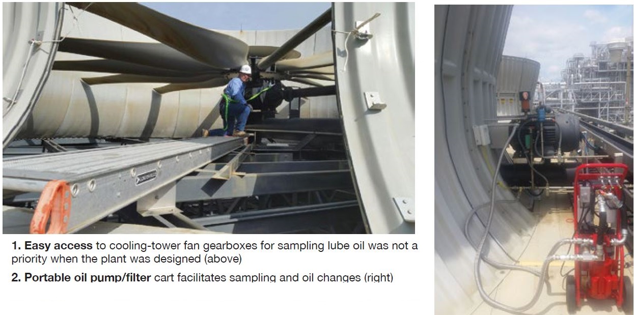

Challenge. Oil in cooling-tower fan gearboxes is sampled/tested monthly. When the tower was built, safe and easy access to facilitate sampling was not a priority (Fig 1). Some personnel considered the sampling process dangerous and time-consuming. It involved (1) LOTO of the necessary breaker and circ-water valves for the affected cell, (2) unbolting of part of the fan shroud, (3) installing a walkway to reach the gearbox, (4) locking the fan to prevent its rotation, (5) putting on a fall protection harness, (6) walking to the gearbox, (7) tying off to an anchor point, and, finally, (8) removing the filler plug and drawing an oil sample.
After the oil sample was retrieved, the entire process was reversed to return the tower cell to service. Weather permitting, this evolution would take at least two hours to complete.
Multiplying that by 10 fans means a minimum of 20 man-hours was required monthly to pull oil samples from the cooling tower.
The same process was followed for gearbox oil changes. The time it took to drain and fill each gearbox made this job difficult to plan and perform.
Solution. Develop/implement a safer, more efficient way of obtaining oil samples, and of performing oil changes. Staff decided the best method would be to modify the equipment so sampling and oil changes could be done without entering the tower cell. Piping was connected to the gearbox and routed outside the fan shroud, and hoses and quick couplings were installed on the piping near the fan motor to allow easy access to the sample/fill line.
Lastly, plant purchased a portable oil pump/filter cart to facilitate sampling and oil changes (Fig 2).
Today, all a technician has to do is hook up the oil cart, turn on the pump to circulate the oil, and retrieve the sample from the sample port. During oil changes, the cart allows for quick draining/filling of gearbox oil and provides the option to valve-in filters to remove particulates and moisture from the circulating oil.
Results. Oil sampling and changes can be done in minutes versus the hours previously. Most importantly, these tasks can be performed without putting employee safety at risk: All work is performed on the cooling-tower deck outside the fan shroud. Added benefit: When the piping was being modified, staff ran an additional line from the gearbox vent port outside the fan shroud. A desiccant filter was added to that to decrease the moisture level in the oil and increase its useful life.

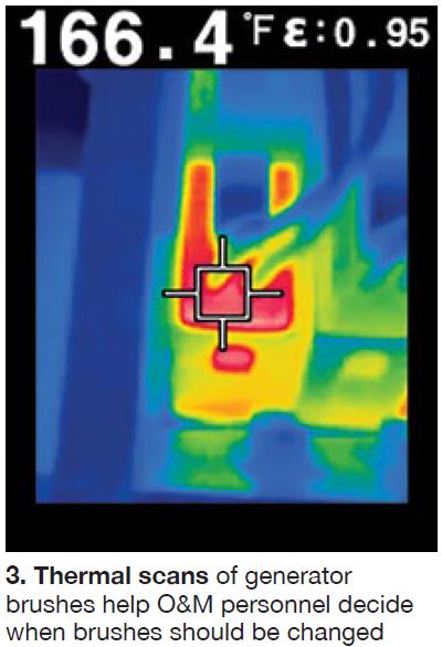

Challenge. Less than a year after commissioning, St. Charles experienced a ring-to-ring fault causing a collector flashover on the steam turbine/generator. After this event, plant staff established daily and weekly criteria for brush and collector inspections and maintenance going forward.
Staff initially adopted a procedure for weekly generator field brush checks involving use of a clamp-style ammeter, plus a visual check for discoloration of shunts, chipped brushes, excessive wear, contamination, hung up brushes, etc. The action of taking current readings by clamping the ammeter around the shunt pigtails of a running machine is a dangerous evolution even with the required arc-flash PPE—especially given the number of brushes per unit.
Solution. Mindful of the safety concerns related to online amp readings, staff incorporated infrared technology into the weekly brush inspections. An IR imager is now used to perform a thermal scan of each brush while the machine is online (Fig 3). The temperature of each brush is recorded on a spreadsheet and used to track performance over time.
Staff can now determine which brushes are carrying the most load and which are not carrying current as they should be based on the running temperatures. Data are evaluated weekly and compared to prior results to establish a priority level for the replacement of each brush and/or holder.
Results. Use of IR technology has minimized the safety risk of placing hands and equipment inside of a running machine along with eliminating the shock and flash risk associated with those actions. Staff are now able to schedule brush changes based upon the temperature profile of the given brush over time and assign priority to those that need immediate attention.
Using this technology along with normal wear-indicator inspections has greatly increased generator reliability, mitigating the detrimental effects of brush selectivity and the potential for flashover. However, the most important benefit is personnel safety.

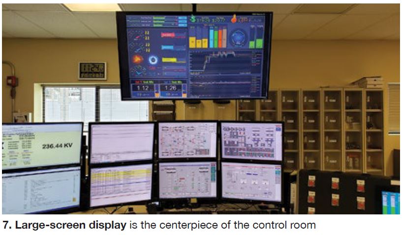

Vision Screen promotes operational excellence
Challenge. With staff changes following the assignment of a new O&M company to the facility, familiarity with the plant and its nuances raised some challenges for the fresh faces—for example, frequent connection loss with the gas-turbine flame scanners, irregular fuel-gas or plant-air pressure performance, and chemical tanks not being replenished in a timely manner.
Accessing and readily monitoring these factors while learning a new facility and trying to troubleshoot operational challenges led to an unnecessarily convoluted shift. Adding additional screens to the control room seemed to treat the symptom and not the problem.

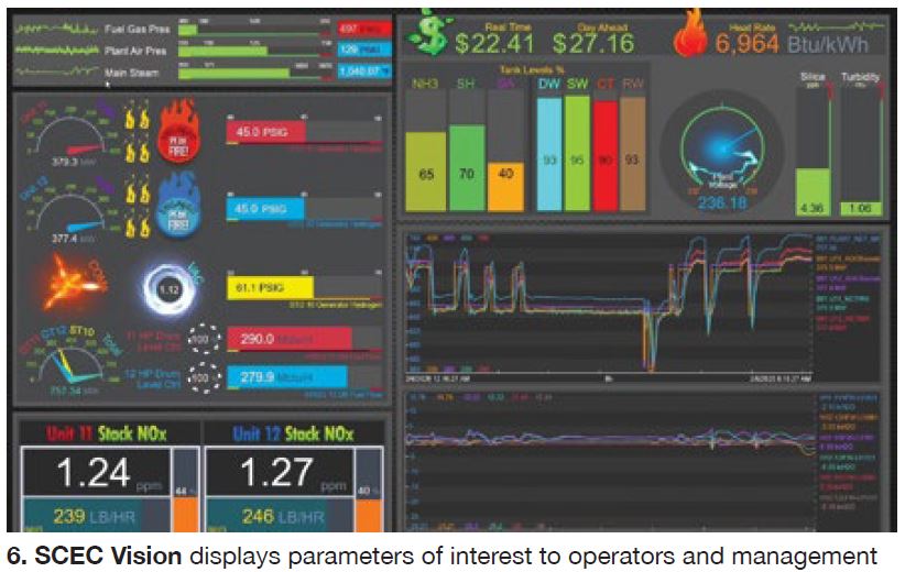

Solution. The historian PI server captures all the parameters of interest so the complimentary software tool, PI Vision, was used to build the platform that would later be named SCEC Vision (Fig 6). A large screen display was ceiling-mounted and outfitted with a 4.5-in. Intel mini-computer specifically optimized for 4K UHD resolution with a high refresh rate. Internal cyber controls and NERC guidelines were followed when implementing this concept, segregating the device from the controls network.
Screen layout required significant effort. PI Vision inherently has a very limited design toolset, so it was up to the staff to create custom images and data equations. Every icon, animation, and formula has been designed in-house. Once the initial layout was completed, a survey was taken of all data points considered important to plant health so they could be implemented.
The result was a simple but aesthetically pleasing display anchored as the centerpiece of the control room (Fig 7). The historian PI server now feeds data, in real time, to this centralized display, complete with visual cues to keep operators alerted of detrimental change.
Results. Since implementation of SCEC Vision, there has been a dramatic improvement in voltage-schedule adherence. Plus, chemical-tank provisions are ordered without delay, and flame-scanner faults are detected quickly and corrected. The fuel-gas and plant-air pressures now are tweaked to near perfection. A quick look back at the previous eight hours trends the plant’s generation and drum level controls to scan for unusual operation.
There also have been unforeseen benefits. Whether it is during the morning staff meeting, or simply passing through the control room, SCEC Vision had become a conversation piece that helps inspire new ideas and constructive criticism. As the staff overcame many of the above- mentioned obstacles, the mindset moved to improving efficiency and reliability. SCEC Vision became so valuable that screens were placed in the offices of the plant manager and plant engineer for monitoring purposes.
The importance of plant efficiency led to operator training and heat-rate monitoring on SCEC Vision. Condenser vacuum, fuel-gas metering, and vivid palettes featuring the CEMS and HRSG duct burner behavior are all contributions from operator feedback.
There was virtually no cost associated with the development and implementation of this tool— other than a $150 annual licensing fee. Use of SCEC Vision continues to grow to serve the needs of the plant and its personnel.
