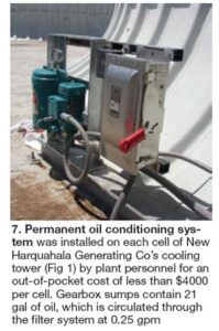

Two ways to remove water and particulates from gearbox oil are to mount the filters and water absorbent on a wheeled cart which can be moved from cell to cell (Fig 6) or permanently install the oil conditioning gear on the fan deck (Fig 7).
