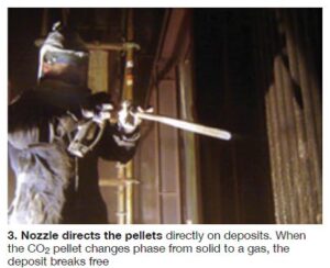

The general cleaning process is illustrated in Fig 2. CO2pellets are fed into a portable machine that is connected to a high-pressure compressor. The pellets are educted into the air stream and propelled through a hose to a specially designed nozzle that propels them at speeds up to 1000 ft/sec. The pellets exit the nozzle and penetrate the debris layer on the surface being cleaned (Fig 3).
The CO2 sublimates once the pellets penetrate the deposit. During sublimation at atmospheric conditions, the CO2 pellets undergo a transformation from a solid directly to a gas, unlike ice that must first melt into liquid water before evaporating into vapor form. When CO2 sublimates from a solid to a vapor, it expands 750 times in volume creating a “mushroom” effect inside the deposit that lifts and removes deposits from metal surfaces. A HEPA vacuum system collects the debris. Two typical HRSG tube banks shown prior to and following CO2 blast cleaning in Figs 4 and 5, respectively, illustrate cleaning effectiveness.

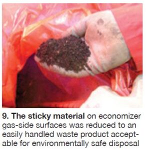

Sticky combustion products were condensing out on the HRSG economizer tubes as a tar-like substance because the flue-gas temperature had dipped below the dew point. In addition, ceramic fiber insulation blocks used in the HRSG combustion zone were deteriorating with fiber strands coming lose into the gas flow and sticking on the economizer’s finned tubes. The combined effect was a loss of heat transfer in the economizer and a rise in the HRSG gas-side pressure drop that significantly reduced steam production.
Initially the plant owner thought to replace the entire economizer module with one having a recirculation system to take a portion of the hotter economizer outlet water and return it to the inlet to ensure tube-metal temperature remains above the dew point. However, procuring an expensive new economizer module was going to require at least 40 days, thereby putting the plant owner at commercial risk for failing to supply the contracted amount of steam.
Alternative approach: The plant owner investigated cryogenic cleaning of the economizer even though there was no large boiler experience with the technology in the UK at the time. However, dry ice was used to clean small equipment—such as motors and generator windings. The plant owner sent representatives to the US to observe the cleaning process in action and the decision was made to bring the process to the UK for the first time.
The CO2 pellet blasting equipment was shipped to the UK for a planned HRSG outage. Figs 7 and 8 show the state of economizer tube fouling before and after cleaning; Fig 9 shows the debris removed from the HRSG after the cleaning was completed.
The cleaning process was very successful and at the close of the outage the plant resumed supply of the contracted amounts of steam to the customer. By selecting CO2 pellet cleaning, the owner avoided an unnecessary economizer replacement, sidestepped an extended outage for the economizer replacement, and avoided an unpleasant contract discussion. CCJ
