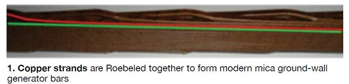

Before proceeding with an analysis of vibration sparking, some background information is in order. When modern mica ground-wall generator bars are constructed, copper strands are Roebeled together to form the bar (Fig 1). Note that Roebel transposition is a process for making stator bars in which the individual conductors that make up the bar are twisted together such that each individual conductor occupies every position within the bar at least once. This is done to reduce circulating currents within the bar.

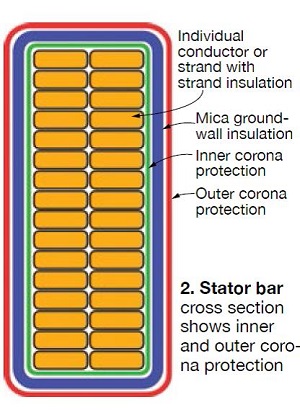

The bar usually is wound with a layer of semi-conductive tape to provide inner corona protection. Mica-based, ground-wall tape then is applied. This tape creates a wall between the energized bar copper and the grounded stator core and frame. A second layer of semi-conductive tape is applied on top of the ground wall to provide outer corona protection.
In the end region of the bar, near the slot exit, a voltage grading tape is applied in order to reduce the electrical-stress gradient at the end of the slot grounding tape in the end winding near the slot exit (Fig 2). The outer corona protection provides a path to ground for any charge that builds up on the surface of the bar and thus, by design, current flows through this layer from the surface of the bar into the stator core.

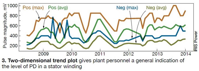

PD detection can provide simple, two-dimensional PD monitoring and data logging accessible to plant personnel, or three-dimensional PD monitoring done by trained technicians using specialized equipment. The former delivers PD pulse-height analysis plots, which provide plant personnel with a general indication of the level of PD in the stator winding and data trending that indicates whether any changes have taken place in the amount of PD in the winding (Fig 3).

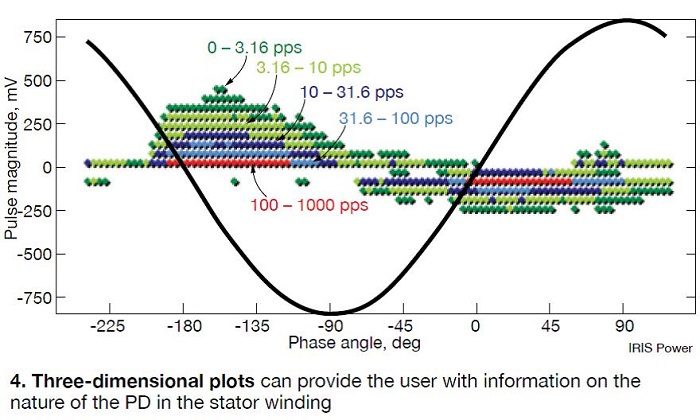

Three-dimensional PD monitoring delivers pulse-height analysis plots and phase-resolved plots of stator winding PD activity and can provide the user with a great deal of information about the nature of the PD in the stator winding (Fig 4). It also can provide information on the location of the PD (slot, end winding), relative size of the worst insulation defects, quantity of insulation defects, and whether the PD may be related to vibration sparking.
The advantages of PD monitoring are that a permanent installation provides continuous two-dimensional data logging and the ability to do more in-depth, three-dimensional data logging without taking the unit out of service. In addition, PD analyses via voltage pulse measurements have a longer track record in the industry. The disadvantages include the need to take equipment offline to install and calibrate the system and not having the ability to monitor other conditions.
