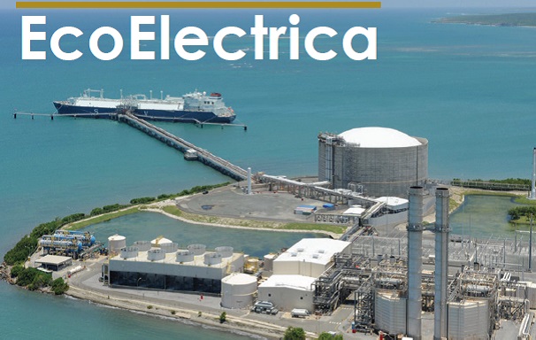

Thermal integration of the combined cycle and LNG terminal to accommodate increased vaporization capacity
Challenge. Ours is one of few powerplants in the world with an integrated liquefied natural gas (LNG) terminal. It is one of only 10 land-based terminals within US borders. The combined-cycle plant produces 16% of Puerto Rico’s electricity, which is sold to the Puerto Rico Electric Power Authority (Prepa).
Since COD in March 2000, LNG had been used solely to fuel EcoElectrica’s 507-MW combined cycle. The original LNG re-gasification system consists of two vaporizers and a closed-cycle heating system with a working fluid of 50/50 glycol/water.
The glycol solution circulates through the gas turbine inlet chillers, and through the heat exchangers and vaporizers to complete the thermal circuit. The original LNG regasification design (Fig 2, unshaded area) boosted the gas turbine’s thermal performance by lowering the combustion air temperature by approximately 15 deg F.
The design to increase regasification capacity was undertaken in 2010 to supply neighboring Prepa’s Costa Sur Power Plant with natural gas, given Prepa’s intent to modify its two nominal 410-MW conventional steam units at Costa Sur from burning oil No. 6 to dual fuel.
The challenge for EcoElectrica’s engineering team was to dispatch natural gas to Prepa in a safe and reliable manner, while maintaining or improving efficiency at the combined-cycle plant and the LNG terminal.
Solution. EcoElectrica’s technical team worked closely with project design engineers to provide insight into plant operations. Among several regasification technologies considered—including open rack seawater, submerged flame combustion, etc—the team and design engineers opted to use a side stream of the existing seawater intake to the cooling tower as a source of heat for vaporization.
The technical team was instrumental in providing feedback that led to the LNG terminal layout constructed in 2012 (Fig 2, shaded area). The LNG terminal expansion project required the following additional equipment:
  • Two LNG vaporizers.
  • Three glycol heaters (heat exchangers).
  • Three auxiliary seawater pumps.
In the plant expansion layout, one-third of the approximately 12 million gal/day of seawater, pumped from the Guayanilla Bay/Caribbean Sea, is directed to the new glycol heaters. The heated glycol is directed to the new LNG vaporizers and the cooled seawater is rerouted to the cooling tower.
The net effect of directing the seawater side-stream through the new glycol heaters is to reduce cooling-tower seawater intake temperatures for all plant services by approximately 10 deg F. Additionally, the implemented solution avoids fuel consumption and environmental impacts, and reduces auxiliary load consumption compared with the alternatives considered.
Results. The LNG terminal expansion improved combined-cycle thermal performance. The reduction of the seawater intake temperature to the cooling tower decreases the temperature of the cooling water for the steam-turbine condenser by 2 to 4 deg F. This increases the vacuum in thecondenser unit that results in a combined-cycle heat-rate improvement of approximately 35 Btu/kWh when 77 million standard ft³ of LNG is vaporized.
Since EcoElectrica is a base-load plant with approximately 80% capacity factor, over 90% service factor, and relatively high-priced fuel supply (spot market LNG), the annual fuel consumption savings have a material impact on the facility’s financial results.
