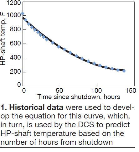

Solution. To calculate an accurate baseline, plant personnel pulled HP-shaft temperatures from shutdowns over the past couple of years. They sorted the data, then plotted it with “time since shutdown” on the X axis and “HP-shaft temperature” on the Y axis (Fig 1).
An equation was developed from this plot that allowed plant personnel to accurately predict HP-shaft temperature as a function of the number of hours from shutdown. The equation and plot were a useful tool, but our goal was to incorporate this curve into the distributed control system (DCS) so the operators could easily determine the shaft temperature at startup.

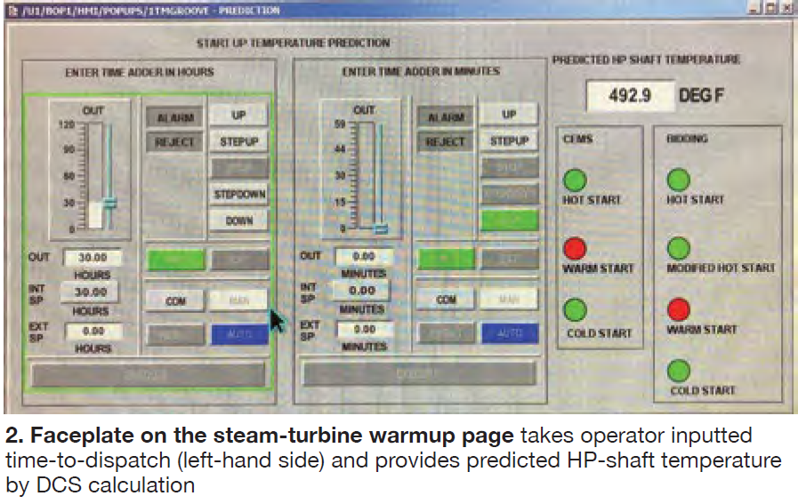

Results. The I&C staff built the faceplate shown in Fig 2 which appears on the steam turbine warmup page. If a unit is going to be dispatched, the control room operator (CRO) will total up the hours from the current time to the anticipated dispatch time, then input this number into the “hours” block on the left-hand side of the faceplate. Using the curve developed in Fig 1, the DCS will then output a predicted HP-shaft temperature.
This tool has been used many times over the past year and has been accurate down to ±1 to 2 deg F even several days in advance of a startup. This probably has saved the plant several costly Title V permit violations.
