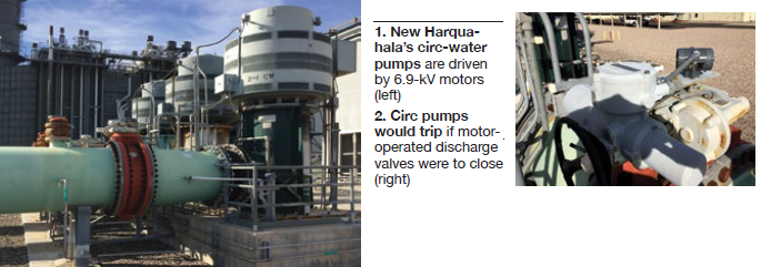

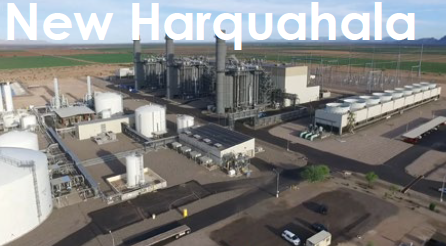

Challenge. New Harquahala’s three 1 × 1 G-class combined-cycle power blocks are served by two mechanical-draft cooling towers. The middle unit in the plant photo, equipped with two 50%-capacity circulating-water pumps, relies on both towers to satisfy its cooling requirements.
New Harq’s circ-water pumps are driven by 6.9-kV motors which receive power directly from the main power feed associated with their unit. Thus, the pumps shut down when power is lost to the unit served.
However, the supply power to the motor-operated discharge valves (MOVs) for the middle unit is split this way: Cooling tower A’s motor control center (MCC) supplies power to the discharge valves on A tower and cooling tower B’s MCC provides power to the B tower discharge valves. Power to the cooling tower MCCs can be lined up from any of the three generating units.
The logic was designed such that if the MOV were closed, it would trip the circ-water pump to protect it. The pump also would trip if the MOV lost power. This is not an issue for the other two units because they take suction from, and discharge back to, the same cooling tower.
Designers did not consider that if one of the pumps—specifically one on the unit sharing water from both towers—tripped off from loss of power with the MOV open, circulating water would be pumped directly from A tower to B tower, or vice versa. The plant is designed with a cross connect for equalizing the towers; however, circ-water flow at a rate of 60,000 gpm, it is not capable of keeping up. This would certainly cause the receiving cooling-tower basin to overflow.

Solution. Find and install the most cost-effective option that increases the reliability of the Unit 2 circ-water system to ensure against a basin overflow event. After careful evaluation, staff determined the most cost-effective option was to procure and install the secondary positioner on the discharge MOVs. Loop power from the DCS was available at the discharge MOVs already and required minimal labor for the install. After the management-of-change process for design and implementation was approved the work was completed by plant employees.
Results. This upgrade has significantly increased the reliability of Unit 2’s circ-water system and will prevent a tower basin from overflowing if power is lost to one of the two circ-water pumps while Unit 2 is operating.
