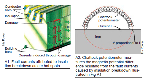

Electromagnetic Core Imperfection Detection (ELCID) is a low-excitation test with wide industry acceptance for assessing core health. Insulation breakdown causes fault currents to be set up as illustrated in Fig A1. A Chattock potentiometer (Fig A2) is used to measure the magnetic potential difference resulting from this current, with the somewhat complex equipment and circuit illustrated in Fig A3.
Bear in mind that fault currents create hot spots which can cause further deterioration to the core. If left unchecked, they can lead to damage of the stator core, windings, and the machine as a whole.
There are several setup challenges important for you to consider during analysis and trending of ELCID test results, ATCO Power’s Ryan Harrison, the 2018 chairman of the Generator Users Group, told attendees—including the following:

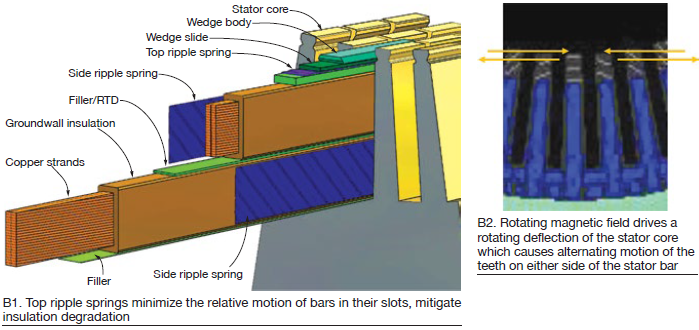

Ed Winegard, GE’s principal engineer for armatures, opened his presentation by noting the high radial slot forces that must be contained in the stators of modern power generators—ranging from 10 to 110 pounds/inch of slot. Fortunately, he said, these forces are predominately downward, adding that about half the slots in a given stator retain bars for different phases, about half the same phase.
For slots with both bars in the same phase the force will be downward on both bars, he said. When the bars are for different phases, the force on the top bar will be slightly upward. Some type of compression system—top ripple springs, for example—is required to minimize bar movement and ensure it remains seated in the slot (Fig B1).
Bar lateral forces are minimal, Winegard continued. However, he pointed out the inherent tangential motion of the slot teeth caused by radial deflection of the core (Fig B2). This motion and its effect on the stator bar must be minimized. A similar method of ensuring the bar remains in contact with the slot wall is required and the side ripple spring (refer back to Fig B1) is ideally suited to meet this requirement.
There are also important stator wedging considerations which must be met, Winegard said: material properties (stiffness, creep, thermal aging, abrasion, etc), dimensions and tolerances (design clearances, tolerance stack up, component machining quality), assembly process (standard methods and sequence, compensation of assembly variation), and inspection (qualitative and quantitative validation).

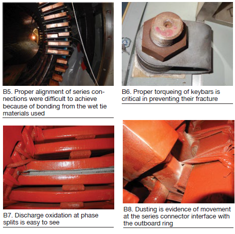

The Siemens Aeropac generator discussed by Derek Hooper, president of BPHASE Inc, a small repair, inspection, and consulting company specializing in gas-turbine generators, was rewound by Alstom in 2014 because of moderate-to-severe spark erosion (Fig B3). Numerous concerns were experienced with this rewind, including the following: injection of clear resin into the dry tie material used made it difficult to determine if the cord was fully saturated (Fig B4), difficulty in obtaining proper series connection alignment (Fig B5), and use of semiconductive packing in the phase-break gaps to attenuate partial-discharge damage.

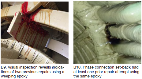

Two years later, BPHASE performed a minor inspection of the Alstom rewind. Focus was on visual inspection of the winding and evaluation of the core keybars. The keybars were intact and within torque specifications (Fig B6). While there was no evidence of keybar fracture in this unit, sister machines had suffered such fractures and plant personnel elected to reduce the keybar torque from 300 to 200 ft-lb.
There was visible evidence of discharge oxidation at the phase splits (Fig B7). There was also significant evidence of movement at the series-connector interface with the outboard ring (Fig B8).
Because of vibration concerns, it was felt that blocking should be installed between the series connections for additional support. However, this would require bump testing. The outage was too short to allow necessary disassembly and the decision was made to install series blocking in short groups to limit any effect on the global modes of the baskets.

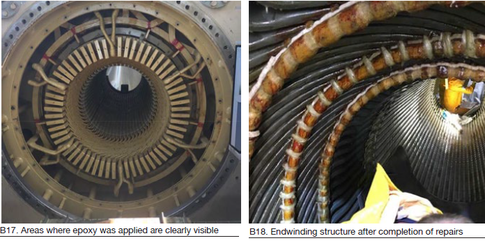

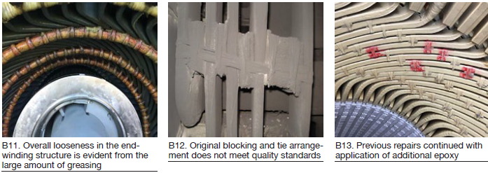

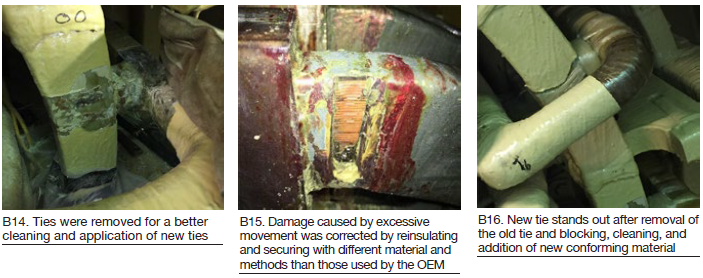

Connection-ring inspection and repairs
Inspections of connection rings typically are focused on the physical support structure-to-ring interface. While there are other factors to consider—such as the connections to bars or coils and inner cooling circuity—they aren’t as common an issue and should become apparent through other testing, MD&A Generator Specialist Keith Campbell told GUG attendees.
Thorough visual inspection is vital to an accurate assessment of the overall condition of the rings. The 10 photos here illustrate typical problems associated with undesirable movement. To begin, the ties in Fig B9 offer indications of two previous repairs using a weeping epoxy. While oil intrusion was a contributing factor, the contamination (greasing) was removed well enough to allow for an adequate repair.
Fig B10 is of a phase-connection setback that had at least one prior repair attempt using the same epoxy. In this case, the contamination was under the ties and blocking, and could not be removed by cleaning alone. Fig B11 reflects an overall looseness in the endwinding structure as indicated by the large amount of greasing throughout. This was conducive to the possibility of a catastrophic failure. Fig B12 is of an original blocking and tie arrangement that does not meet quality standards.
Fig B13 shows a continuation of the previous repairs by additional application of epoxy. Fig B14 reveals ties removed for a better cleaning and application of new ties. Fig B15 is the result of excessive movement that dictated reinsulating and securing of components with a different material and by different methods than used by the OEM.
Repairs complete, Fig B16 shows the new tie after the old tie and blocking had been removed, cleaned, and new conforming material had been added. Fig B17 illustrates the areas where epoxy was applied; the Fig B18 photo was taken after repairs to the endwinding structure were completed.

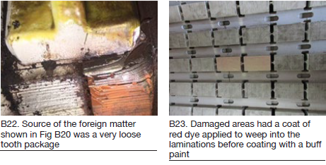

NV Energy’s Jagadeesh Srirama, a member of the GUG steering committee, profiled for attendees the recent inspection of a 391-MVA Alstom steam turbine/generator for an F-class combined cycle. This unit was put in service in 2004 and high vibrations had been recorded since installation. No issues were identified during a MAGIC (Miniature Air Gap Inspection Crawler) inspection done in 2013 and all the electrical test results were acceptable during this outage.

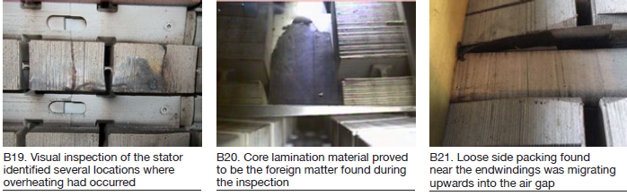

The unit was inspected again during a 2017 outage for simultaneous gas turbine, exhaust structure, and generator work. MAGIC identified four hot spots in the core iron and ELCID testing confirmed damage at those locations with exceptionally high readings of 1998, 1363, 674, and 976 mA. In addition to the hot spots, foreign material was found in the air gap. Management decided on immediate corrective action. To address the hot spots, it was necessary to remove the field—a challenge at this outdoor plant with major plant repairs already underway.
After rotor was removed, visual inspection identified several spots with obvious overheating similar to that in Fig B19; the debris was identified as core lamination material (Fig B20). Near the endwindings, some of the side packing had come loose and was migrating upwards into the air gap (Fig B21).
The lamination pieces came from a grossly loose tooth package, photographed in Fig B22. This tooth area was cleaned, inspected, and trimmed to make sure no more of the punchings would liberate. Mica then was placed in the shorted area and a tapered wedge inserted into the tooth to tighten the package. This wedge was epoxied in place. Note that the core step iron will have to be replaced when the stator is rewound in the future.
The side packing that came up from the top of the bar (refer back to Fig B21) was removed, air dry varnish applied, and new side packing installed. All damaged areas had a coat of red dye applied to weep into the laminations before coating with buff paint (Fig B23).

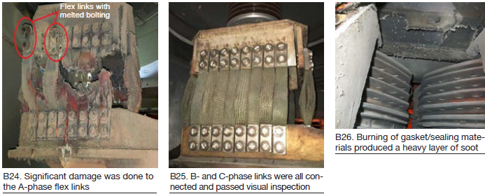

Duke Energy’s Dave Fischli, manager of generator engineering, and vice chairman of the GUG steering committee, reviewed for attendees the case history of a Westinghouse 818-MVA, 20-kV generator (COD 1981) that tripped on an A-phase neutral ground only a couple of months before the meeting. The machine’s field and stator had been rewound by Alstom in 2005.
Subsequent to the trip, a fire was reported at the lead box on the generator; site emergency responders used ABC dry chemical to extinguish the fire as the unit coasted down. External visual review showed significant damage to the A-phase lead area, with heat damage to the B-phase bushing area. Post-event data review showed some electrical anomalies starting eight minutes before trip.

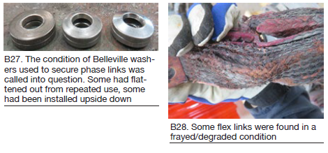

Inspection revealed significant damage to the A-phase links; none of the 32 links remained intact (Fig B24). B- and C-phase links all were connected and appeared fine (Fig B25). There was a heavy layer of soot on the CTs for both the A and B phases, plus contamination at the bottom of lead box from fire-damaged components (Fig B26).
Investigators concluded that loose connections on one or more flex links caused a high-resistance contact which allowed current to flow through the bolt rather than the link contact surface area, and the bolt melted. Thus, loss of one flex link shifted its current to the remaining flex links, adding heat to them and amplifying the loose-connection problems and degraded condition of other flex links.
The A-phase links were too heavily damaged to record torques, but torque checks performed when removing links from the B and C phases were satisfactory. Some Belleville washers removed from the B and C phases had been flattened out from repeated use, others had been installed upside down (Fig B27). Flex links from the B and C phases also revealed fraying and degradation (Fig B28). It was evident that previous visual inspections had not been sufficiently rigorous to identify degraded links for replacement.
Consequential damage. The ABC dry powder extinguishing agents include chemicals such as sodium bicarbonate, potassium bicarbonate, ammonium sulfate, and ammonium phosphate. These chemicals act as a desiccant, absorbing moisture, and under humid conditions become conductive. They are alkaline in nature and corrosive to electrical insulation and metal components within the generator.
There was extensive contamination of the lead box and exciter internals by soot and smoke particles. Basic cleaning was performed of all accessible areas without complete disassembly. Follow-up inspection and full cleaning is planned for a 2018 outage.

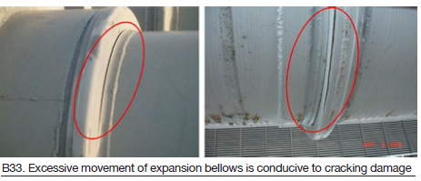

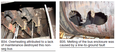

RMS Energy’s Jesus Davila reviewed for attendees the several types of bus systems and components: cable bus, non-segregated and isolated-phase bus, terminations and disconnect links, insulating materials, expansion joints, seal-off bushings, etc. Each of these requires special maintenance. Critical items on the bus duct include flex/bolted connections (current carrying), expansion bellows/joints, insulators and mountings, seal-off bushings, groundings, and insulated joints. Examples of some of the issues discussed by Davila were the following:
    • Electrical connections. Arc damage to bolted joint bus face (Fig B29).
    • Flexible connectors. Cracked laminations caused by vibration or air flow (Fig B30); flex braids damaged by rubbing and/or abuse (Fig B31).
    • Improper bolting or lack of maintenance at connection points. Damaged contact surfaces and gross heating issues (Fig B32).
    • Expansion-bellows damage attributed to excessive movement often resulting in cracks (Fig B33).
    • Bus failures. Overheating of non-segregated bus attributed to a lack of maintenance (Fig B34); line-to-ground fault causing melting of the bus enclosure (Fig B35).
Most of the deterioration conditions listed above can be detected, particularly in advanced stages, by visual examination and/or temperature monitoring. All require immediate attention to prevent major equipment failure. If the condition is found before failure, refurbishment usually can be accomplished by obvious and/or well-established procedures.
