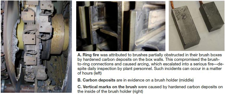

Next, a leading question: “Why would an OEM alert its customers to the need for proper collector maintenance? Sounds so mundane, and the topic rarely, if ever, is addressed at user meetings.” Fig A is the only answer necessary.

Brush gear. The conversation shifted to brush gear. “The brush often is blamed for collector-ring wear,” the Cutsforth experts said, “but the root cause typically is the brush holder. Almost always, too little brush contact pressure is the specific prob­lem, which is influenced by the brush holder and/or the spring. The brush holder contributes to insufficient con­tact pressure by restricting free move­ment of the brush.”
The buildup of small mounds of carbon inside the brush holder is one cause of brush hang-up (Fig B). Carbon particles are produced by the repetitive impacting of the brush against the hold­er wall (Fig C). Such buildup is difficult for maintenance personnel to see but it can be identified from marks made in the side of the brush.

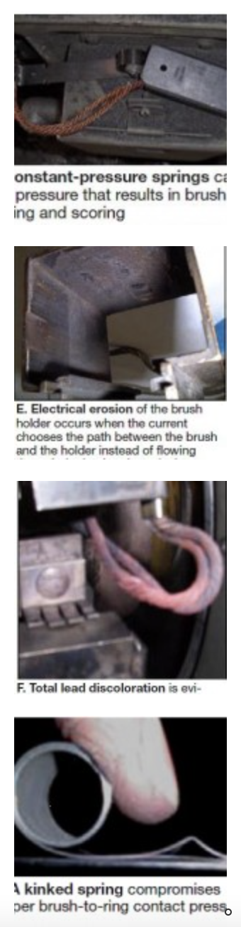

Brush binding is another cause of holder-related restriction (Fig D). It is caused by the brush dragging against the side of the holder. Angular pres­sure increases the likelihood that the brush will become stuck in its holder. Where the brush box is shorter than the brush it holds a ledge can develop in the brush and cause it to hang-up.
Surface roughness of a brush hold­er is yet another impediment to free brush movement (Fig E). This problem occurs when current passes through the side of the brush holder because of a poor terminal connection, poor shunt-wire connection, or the brush is too long.
Lead discoloration at the terminal end is an indication of a poor terminal connection. But when the full length of the brush shows extreme heating, you are looking at the results of so-called selective action. In Fig F, the brush with the discolored lead was the brush with the best connection to the system.
Spring problems. Worn, dam­aged (Fig G), or broken springs lose some or all of their tension and cause brush wear and out-of-round rings. Too much spring tension can increase brush wear but not mechani­cal wear of the ring. The Cutsforth people pointed out that most springs are attached to the back plate of the brush holder and cannot be changed without a shutdown.

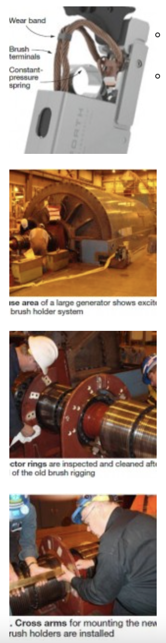

The solution. Dave Cutsforth, the firm’s president, told the editors in a follow-up phone call that years of per­sonal experience went into developing the EASYchange® brush holder sys­tem (Fig H). It assures safe removal of the brush and brush box as a unit within seconds—while the generator is operating. This allows inspection and maintenance away from the excit­er in a comfortable environment.
When the brush is changed, the spring and spring portion of the ter­minal connector are replaced as well. The spring clips into the brush box in the Cutsforth design, facilitating its replacement. Note that by changing spring and brush at the same, spring tension is maintained to be constant over the life of the brush, minimizing the potential for abnormal spring-tension-related collector-ring wear. The terminal connection automatically engages when you close the handle. Finally, brush wear is easy to gauge with the holder in place by checking the distance from the wear band to the brush box.
Application. Most applications only require one standard-size EASYchange brush holder; it serves all generators, minimizing the need for multiple models and spares. The effort required for retrofitting generators depends on the machine. Perhaps the most involved is a replacement of the type profiled in Figs I through N for a large steam turbine.
The doghouse area is exposed showing the exciter on a stub shaft at the end of the generator (Fig I). The collector rings in Fig J are easy to inspect with the old brush rigging removed. The positive and negative rings are separated from each other by the insulated frame in the center of the shaft.

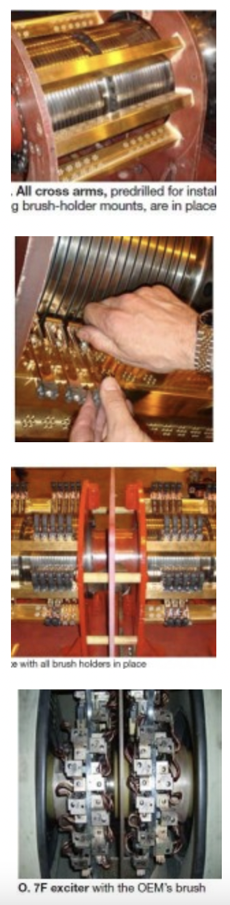

Cross arms for mounting the new brush holders are installed in Fig K with this portion of the job complete in Fig L. The holes in the cross arms are precisely drilled for installing the brush-holder mounts (Fig M) and retaining the brush holder in proper position.
The brush holders slide over the mounts and are locked in place by positioning the handle at about a 45-deg angle as shown in Fig N.
Most gas turbines, including the 7F, are easier to retrofit: A simple adaptor allows quick installation of the brush holders. Figs O and P are before/after photos for a 7F replacement.
