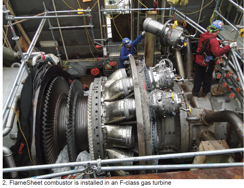

Seven 501F and 7F gas turbines (with an eighth being installed in December 2020) are currently operating commercially with a FlameSheet combustor, simply described as a burner (or inner combustor) with a conical flame sheet around it that promotes a trapped vortex mechanism which allows higher flame velocities to be maintained.
The flame is said to be “anchored” at the point of vortex (Fig 1) as defined by geometry and, therefore, less dependent on fuel constituents. Fig 2 shows a FlameSheet combustor being installed in an F-class gas turbine.

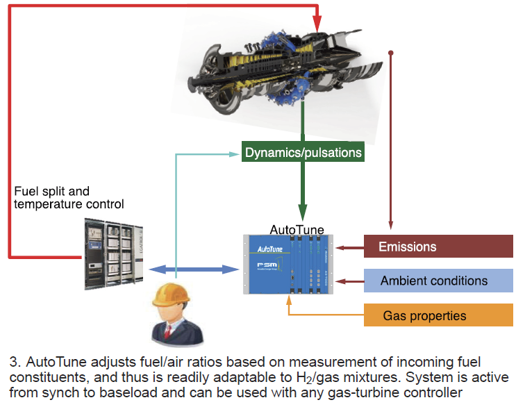

In addition to FlameSheet, PSM has demonstrated that its AutoTune controls will greatly contribute to successful H2 firing (Fig 3). At its base, AutoTune can continuously measure the constituents of the fuel mixture, then automatically adjust the combustor fuel/air mixtures to improve reliability and maintain stability. This functionality is already in practice today for a variety of shale gases with variable heating values. Even within the Marcellus and Permian regions, natural-gas heating value can vary significantly.
Differences in combustion properties with higher and higher H2 fractions are not trivial, stresses Benoit. Combustors are typically designed for a narrow range of natural-gas properties. H2 has higher reactivity, and “wants to oxidize quicker,” which can lead to high flame speeds, flames migrating into the metal, and flashback. In addition to ensuring stability of combustors firing these mixtures, AutoTune solves a variety of combustion challenges.
The GT-agnostic AutoTune product is already installed on more than 80 units (total anticipated by the end of 2020)—including 9FA, 7FA+e, W501F, M501F, 6B, 7E, GT26, and 9E engines.
GT owner/operators don’t want to lose their cycling and start/stop flexibility. While AutoTune has proven it can handle transient upsets, Benoit notes that “you don’t want to start up or stop the machine with high H2 fractions, so it’s best not to start on H2 from a safety standpoint, but instead transfer to an H2/gas blend at full premix mode. He also notes that many customers purchased FlameSheet specifically to improve load-following.
Finally, maintaining low NOx and CO emissions is a challenge with H2, but premix combustion is key here and even more critical. Although conventional premix combustors are limited in their ability to burn H2/gas mixtures, PSM sees AutoTune, combined with the aforementioned combustion technologies, as the key to successful firing in such GT-equipped machines.
