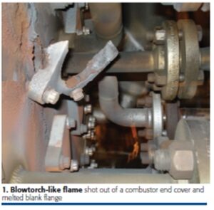

The scene: Simple-cycle 7FA startup on a quiet Sunday afternoon. About 30 minutes after the button is pushed on the gas-only unit, compartment thermocouples read 300F; 15 minutes later, 350F. Operator checked the engine and saw a blowtorch-like flame shooting out from a combustor end-cover. The unit was shut down immediately. Inspection revealed the flame had burned through the blank flange covering a superfluous liquid fuel port (Fig 1).
The cause: Investigators found that the seal ring under the blank flange permitted air in-leakage (Fig 2), thereby reducing the pressure drop across the fuel nozzle and allowing the flame to attach itself to the nozzle (Fig 3). An attached flame causes events such as the one described.

Investigators determined that a leak at the blank flange, if large enough, can cause hot gas at the nozzle tip to flow back into the end cover where it ultimately will cause a complete failure of the blank flange. This failure cascade was consistent with the observed nozzle and end-cover damage.
The leak at the blank flange described in the CTOTF presentation was caused by a seal failure. One of the two seals employed by the OEM at this location is manufactured with a thick cladding which can oxidize heavily and break down at typical 7FA-e operating temperatures. Engineers also found that the bolts used can be too short to fully engage the Heli-Coil locking feature. These findings, alone or in combination, can lead to an air leak at the blank flange and initiate the failure observed.
