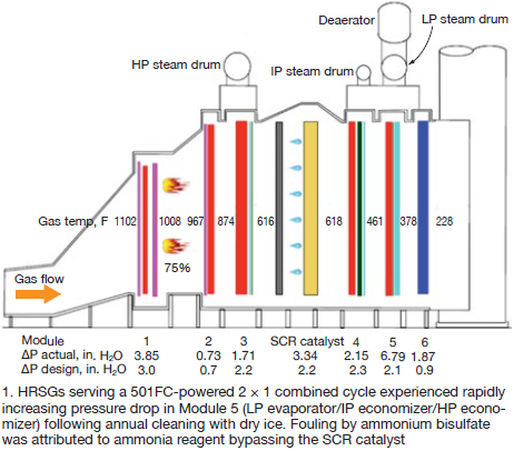

Case in point is a 2 × 1 combined cycle powered by W501FC+ gas turbines that had experienced a high exhaust-gas pressure drop through its HRSG’s fifth modules since plant startup in 2000 (Fig 1). The fifth module includes the LP evaporator, IP economizer, and HP economizer sections. There was one change in ownership over the years.
Each of the HRSGs is equipped with an oxidation catalyst and SCR to keep CO and NOx emissions within permit limits. The gas-only plant’s continuous full-load rating is 480 MW with duct firing at a maximum ambient temperature of 120F and 15% relative humidity.
Majority of the fouling in Module 5 was occurring in the LP evaporator section, the tubes contacted first by exhaust gas flowing through the module. Cause of the high pressure drop was ammonium bisulfate (ABS) deposition in the tube bundle, caused by high local ammonia concentrations that pass through the SCR in those areas (slip). Ammonia, as a 28% aqueous solution, is injected at a rate of 150 lb/hr at plant design operating conditions.
The HRSGs were cleaned annually by dry-ice blasting, but the pressure drop quickly increased after cleaning, from 2.1 in. H2O (clean condition) to 6.8 in., or more. Fig 1 gives typical data taken from the plant DCS when Module 5 was experiencing high gas-side pressure drop attributed to fouling.

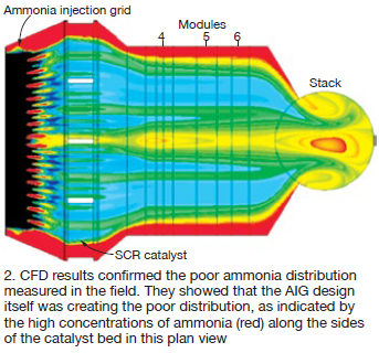

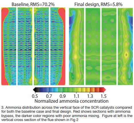

CFD identifies problems.  Without delving into the complexities of the full-system CFD model, suffice it to say that detailed contour plots of exhaust-gas temperature, pressure, velocity, and ammonia distribution were developed throughout the entire HRSG—including the AIG grid. The model found that although the velocity distribution was quite uniform at both the CO and SCR catalyst inlets, the ammonia distribution was very poor at over 70% RMS—well beyond the goal of 10% RMS—at the inlet to the SCR catalyst.
The bottom of the CO catalyst support structure was of a design that allowed large areas of recirculation. Ammonia quickly collected there and along the sides of the HRSG where the casing expands and additional areas of recirculation existed. These two regions cause the ammonia to be “pulled” in and stay concentrated near the bottom and vertical walls before being propagated downstream into the SCR catalyst. Such problems typically are caused by too few injection holes in the AIG and the lack of mixing of the ammonia and the flue gas (Fig 2).
Concord Environmental’s CFD modeling confirmed that ammonia was concentrating heavily along the side walls as well as in the top and bottom corners of the catalyst bed. However, the CFD model revealed that the AIG design itself was creating the poor distribution with high concentrations along the sides of the catalyst. The AIG supplied with the HRSG was located 4 ft downstream of CO catalyst, in a section of the HRSG casing expanding towards the SCR catalyst.

With the addition of AIG mixing baffles and CO catalyst ducting baffles, gas flow from the CO catalyst now flows uniformly into the AIG injection area. When compared to the baseline AIG pressure drop, the new design added only 0.2 in. H2O. More importantly, the final CFD design reduced the ammonia velocity distribution to 5.8% RMS, well below the design goal of no more than 10% RMS (Fig 3).

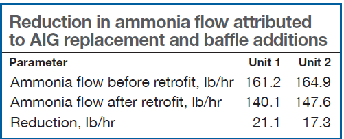

Operating data after startup. After the outage was completed, initial startup data showed significant reduction in ammonia flow, which translates into reduced localized ammonia concentrations (table).
Ammonia usage has decreased by 15% to 25% depending on load, and pressure drop in Module 5 has held steady for the past six months based on station instrument readings. The result has been a reduction in plant operating cost through the reduction of ammonia usage, avoiding the operating efficiency loss experienced with ABS fouling of Module 5, and will greatly reduce the future cost to clean the ABS from Module 5 tubes.
