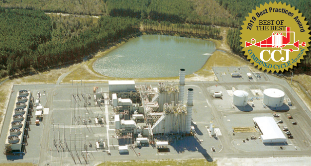

Effingham County Power, owned by The Carlyle Group and operated by Cogentrix Energy Power Management, is a 525-MW plant in Rincon, Ga, equipped with a 2 × 1 combined cycle. General manager is Bob Kulbacki.
