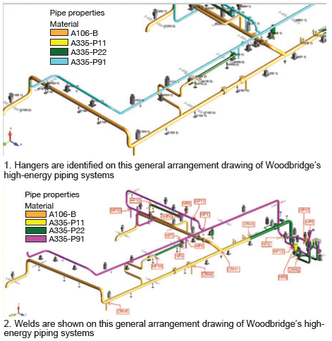

Like any new facility, all of the programs and procedures needed to operate and maintain Woodbridge Energy Center had to be created from scratch. One, the High Energy Piping Program (HEPP), immediately stood out to the plant team as an area that could benefit greatly through customization and simplification. The challenge was how to make a relatively complicated and lengthy program efficient and easy to understand by operations personnel while creating a sense of ownership through participation
HEPPs have two main goals: Safe operation of the site and long-term reliability of the plant’s piping systems. To achieve these goals at Woodbridge, its 22,000 ft of piping was broken down into 495 data points (425 pipe supports and 70 welds). Those data points were then condensed into a form making inspections easy to perform, understand, and track over the life of the site. Typically, this area is where most HEPPs fall short because of the massive amount of data needed for inspection and formatting of the results.
Team Woodbridge decided the first area to go after was the actual inspection form itself. With the goal being a form that was visually easy to follow and understand, Plant Engineer Michael Armstrong took the general arrangement drawings for the different piping systems and added indexed markings showing the location of the hangers (Fig 1) and welds (Fig 2) included in the program.

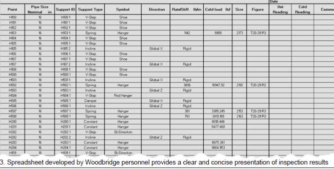

The last hurdle was the clear and concise presentation of the inspection results. A spreadsheet was developed (Fig 3) that listed the index numbers from the referenced drawings along with related design information (pipe size, pipe support ID, growth direction, plus support type, symbol, and stiffness) for each pipe support/hanger. It also included a section for hot readings, cold readings, and comments.
This enabled the individual performing the inspection to take the annotated piping system drawings with the inspection forms and walk down each support/hanger easily and efficiently.
Regarding weld inspections, a similar sheet was developed; however, the site team is not trained to perform the vast array of necessary inspections so the drawings and inspection forms are provided to the third-party contractor prior to starting work.
The bottom line: An otherwise complex program was developed into an efficient and easy-to-understand process that (weld inspections excluded) the team can self-perform. The ability to self-perform the hanger inspections already has proven valuable when issues were discovered by plant staff that likely would have gone unnoticed by contractors not familiar with the site. Being able to catch these problems in-house greatly increased the team’s confidence in its own ability to quickly identify issues without having to comb through multiple levels of contractor-provided documentation.
