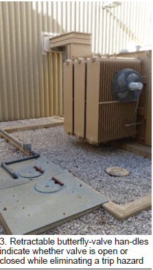

Another thing considered in creating a sound spill plan was the design of containments and containment drains. At GCE, transformer containments all have administratively controlled drain valves. Following a rain event, operations personnel visually inspect the water in the containments to ensure there is no oil or other contaminants. They then open the drain valve, which allows rainwater to flow to the oily water separator.
Some sites—not GCE—have position-indicating valves (PIVs) for these drains that visually indicate whether the valve is closed or not. It is critical to keep containment drains closed during normal operations so that, in the event of a spill, the containment can do its job. The lack of position indicators on underground containment drain valves at GCE created an opportunity for an administrative error. Thus, the plant’s plan required continuously visible indication on these valves so the operations team could ensure that they stayed closed at all times.

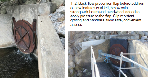

Spill containment solution: GCE has a back-flow preventer at the Arkansas River discharge location that provides an isolation point for all of the water flowing from the plant (Fig 1). The challenge was to find a simple, cost-effective means of installing a positive closing device at this point. Staff decided on an I-beam strongback with a modified handwheel designed to put positive closure pressure on the back-flow flap. Technicians designed and engineered this device using scrap material and parts from an old valve.
The largest expense was the rubber sealing material placed between the cast-iron flap and the 48-in. pipe lip. To ensure that any employee could close this valve, a platform with a slip-resistant grating and handrails were installed to allow safe access in any weather (Fig 2).
The drain-valve indicator issue was addressed by replacing all gate valves with one-quarter-turn butterfly valves. Extension handles then were fabricated to assure quick, easy valve operation. The handles are retractable to eliminate any trip hazard (Fig 3). The positions of the valves now can be seen at all times, allowing the operations group to ensure all drains are opened only during rainwater draining events.
