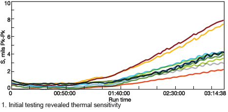

Step 2. With no initial finding for the cause of the vibration, Quail Run management decided to perform a balance and thermal sensitivity test on the rotor in a high-speed balance pit. This included the following:
    • Perform dial-indicator runouts and slow-roll TIRs (total indicator runout) of journals, TE coupling, retaining rings, and collectors.
    • Perform a rough balance.
    • Perform flux probe run.
    • Perform overspeed run.
    • Perform flux probe after overspeed.
    • Balance for thermal run.
    • Perform thermal run.
    • Perform flux probe after thermal run.
The test results (table) indicated that there was thermal sensitivity with just under 8 mils deflection (Fig 1).

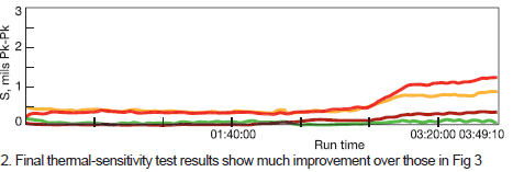

Step 4. After completion of the rewind another balance and thermal sensitivity test were performed (Fig 2), finding thermal sensitivity was no longer an issue. Maximum thermal deflection was just over 1.3 mils. Electrical testing of the rotor was performed with no issues noted.
After completion of the inspections, testing, and rewind, the rotor was returned to the plant and installed in the generator. Vibration was monitored on restart to ensure performance had returned to design specifications. This was confirmed.
