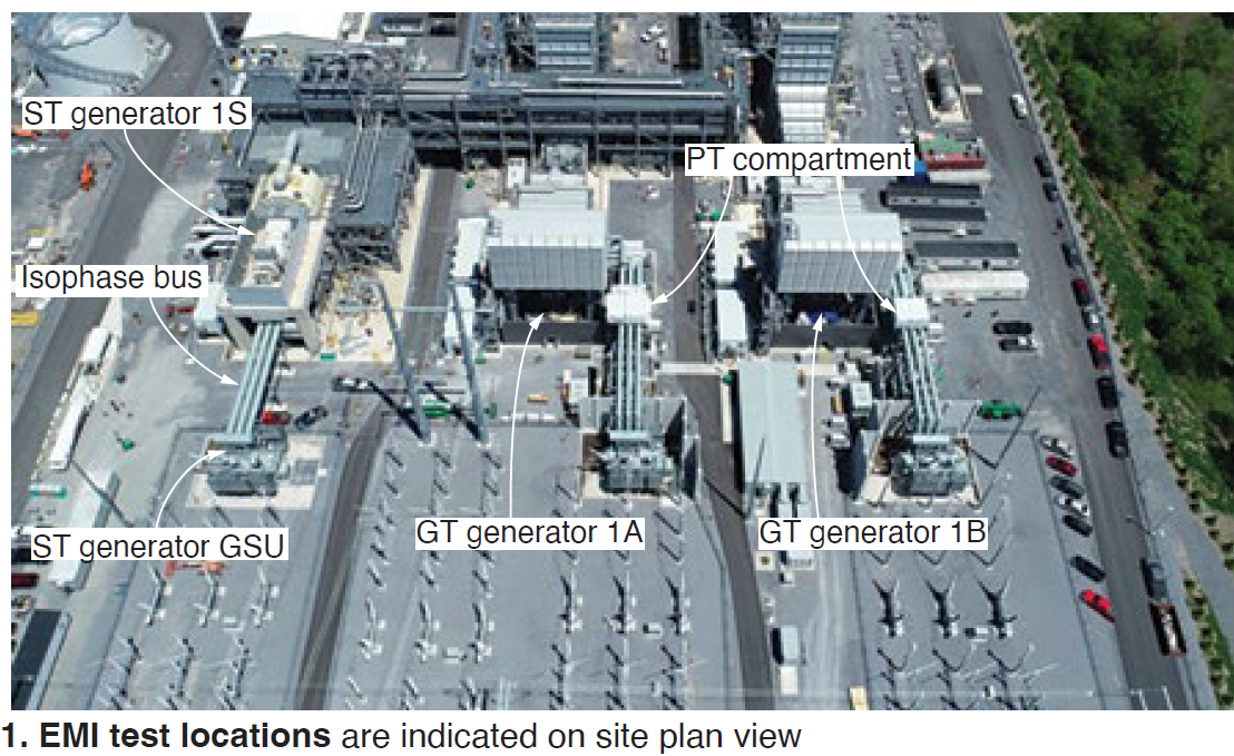

Challenge. Soon after commissioning, one of Fairview’s gas turbine/generators experienced stator-ground-fault trips attributed to isophase-bus (IPB) water ingression into potential transformer (PT) cabinets, followed by persistent lower-than-expected resistance readings. Doble Engineering was engaged to perform electromagnetic interference (EMI) testing on several components of the plant’s three power trains to assess their condition. Generators, step-up transformers (GSUs), unit auxiliary transformers (UATs), and IPB were suspect in each train (Fig 1).

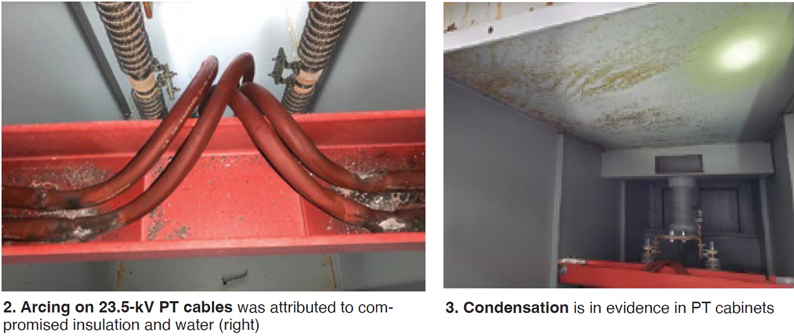

Following the first trip on stator-ground-fault 64 relay, damaged cables and condensation were found in a PT cabinet (Figs 2 and 3). To learn more on the importance of addressing grounding issues in a timely manner, read “IEEE standards may not sufficiently address grounding issues in rotor, stator windings,” by Clyde V Maughan, CCJ, 2Q/2013, p 7.

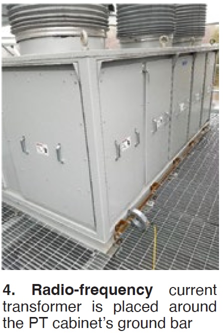

To perform an EMI diagnostic, a radio-frequency current transformer is placed around the neutral, a safety ground, or power conduit of the asset (Fig 4) to measure and identify the signals generated from the component or system defects. The EMI diagnostic method measures a broad spectrum of radio frequencies to evaluate signal patterns—including, but not limited to, corona, partial discharge (PD), and arcing.

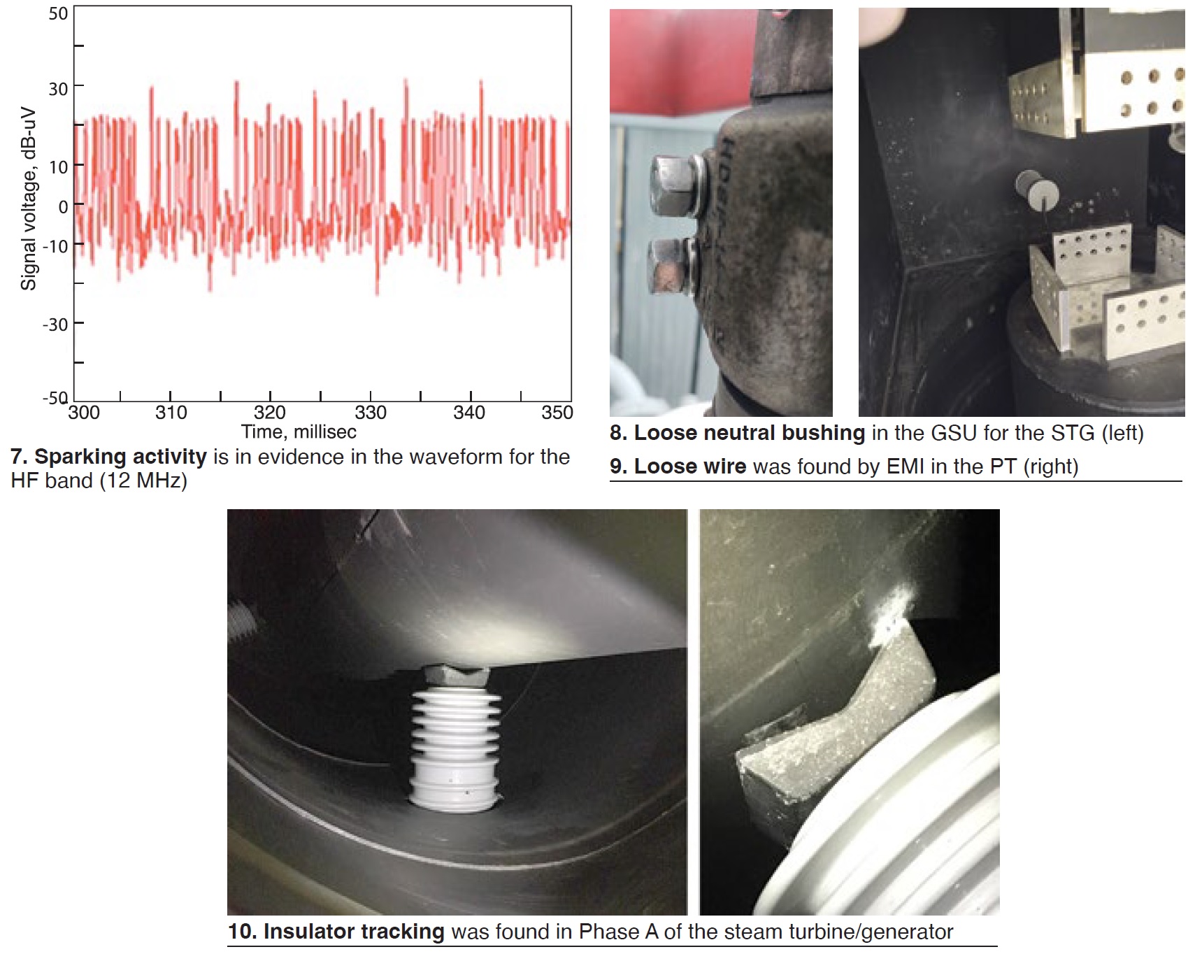

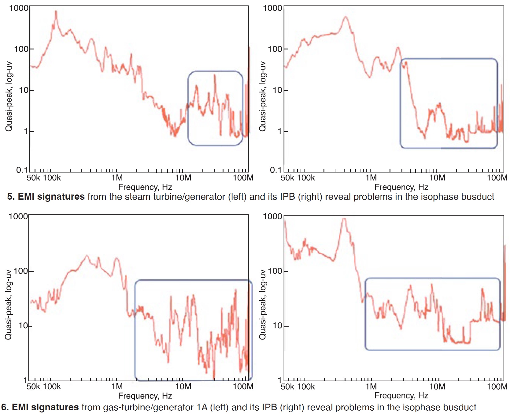

The generator, IPB, UAT, and GSU for each of the three units were tested and inspected. The table summarizes the most relevant findings. The EMI signatures in Figs 5 and 6 were acquired at different grounds on each component. The frequency ranges indicated on the EMI signatures, upon further and detailed analysis of the waveforms, revealed abnormal PD and sparking activities. Fig 7 is an example of a sparking waveform.
The activities detected typically are associated with insulation deterioration, defective connections, and loose hardware inside the IPB. To pinpoint the locations of the defects, a scan was performed with a handheld device to identify areas with high radiated EMI. After a thorough analysis, an internal inspection of different sections of the bus system was recommended.
Referring to the detailed EMI report provided by Doble, the locations identified in the table were highlighted on electrical one-line and 3-phase drawings. These marked-up prints were used to plan lockouts, scaffold erection, and inspections at the next planned outage. Figs 8-10 show examples of the findings in locations identified by EMI testing.
