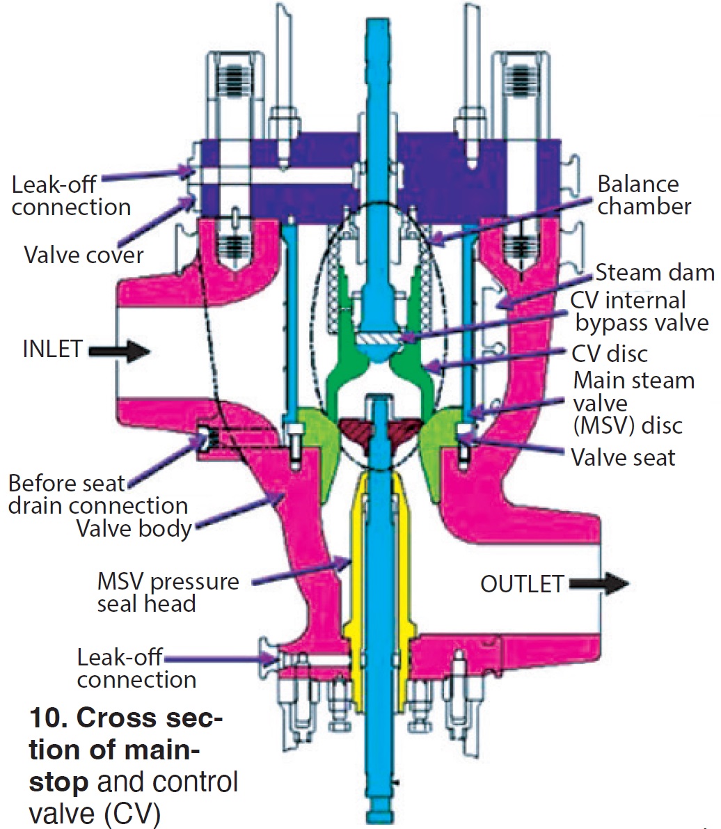

“Steam Turbine Valves: Flexible Operation Damages and Testing/Monitoring Methods,” Constantin Chitic Foldi, EPRI
The throttling required of steam-turbine valves during load cycling poses additional stresses and risks. Slides review valve basics and functions, effects of cycling on specific components, condition monitoring and maintenance strategies, and the following online and offline tests: actuator spring pre-load and valve travel adjustment, hysteresis and ramp, hysteresis step response, stroke, seat tightness prior to startup and during scheduled shutdown, and steam leak-off (Fig 10).

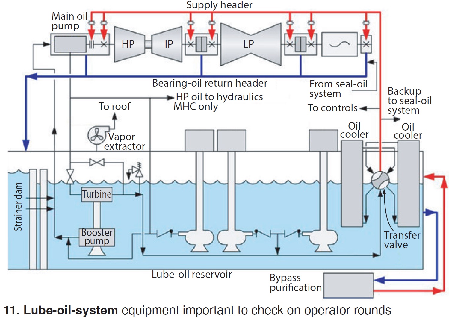

“Lube Oil System: Maintenance and Commissioning,” Randy Steele, EPRI
Essentially a summary of generic lube-oil-system (Fig 11) best practices, or what you’d find in a EPRI Report 1025331 (2012), “Turbine Generator Auxiliary Systems Volume 1: Lubrication System Maintenance Guide,” and companion reports (all listed at the end).

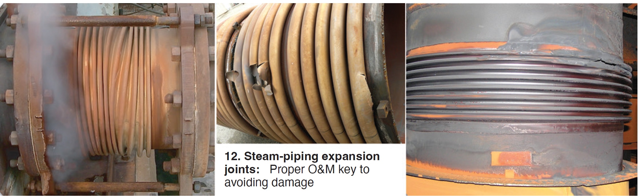

“Steam Piping Metal Expansion Joints,” Eric Davis, Senior Flexonics Pathway
If you (1) want to avoid what is illustrated in numerous “wreck on the highway” photos (Fig 12), (2) need a refresher on the types of metal expansion joints and how they behave under operational stress, (3) could use some guidance in developing a comprehensive inspection plan, or (4) are curious about “in-plane squirm, “loss of convolution parallelism,” “pressure thrust,” or column instability,” you won’t want to miss this slide deck.

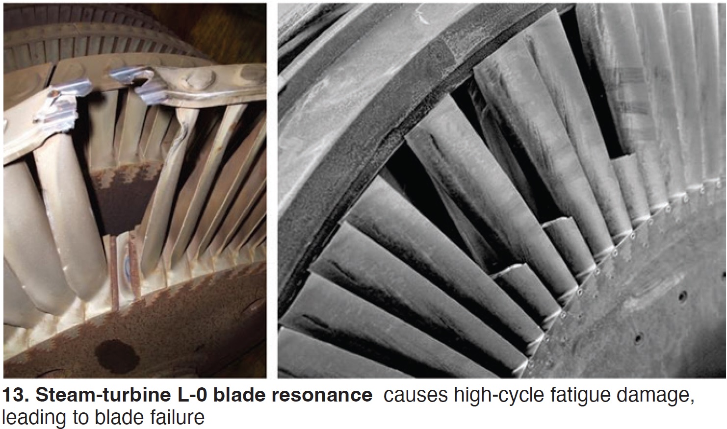

“Boiler-Feed-Pump Steam Turbines: Recent Issues and Challenges,” Hector Delgado, EthosEnergy
What, you worry, if your boiler feed pump steam turbine (BFPT) is over 30 years old and your plant has undergone significant load cycling? Yes, says author, because the unit was designed for baseload ops, blades cannot be tuned to avoid resonance (unlike generator drives), alloy material naturally degrades over time, and blades are subject to low-, and high-cycle fatigue (Fig 13). Author reviews remedies and mods developed through testing programs from the ‘80s and ‘90s. Bonus section covers BFPT control system upgrades.
