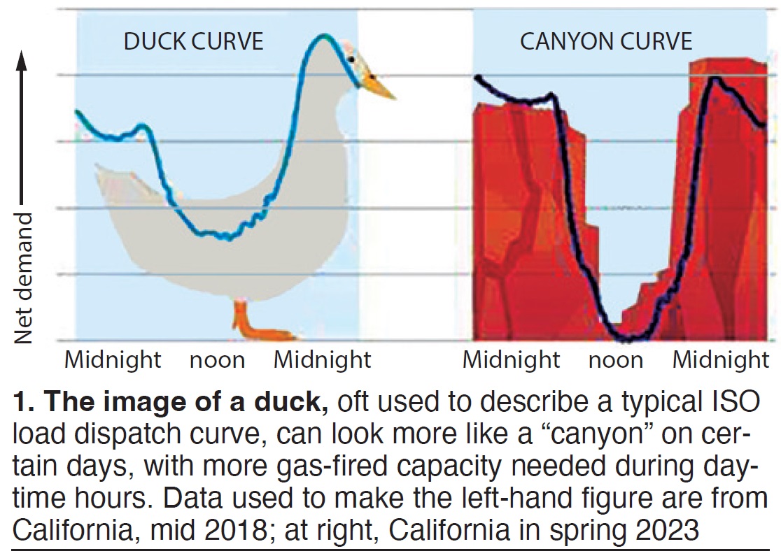

For more than a decade, combined-cycle plants have been following wind and solar with greater load cycling and more starts and stops. Today, many of those plants are cycling more frequently for even shorter periods with as much capacity as they can muster. One reason: The well-worn “duck curve” has become a “canyon,” referring to the changes in dispatch curves where more gas capacity is “in the money” during daytime hours (the canyon floor) compared to five years ago (Fig 1).
But if three of the facilities highlighted in the user-driven presentations last year are representative, some plants are having to adapt to radically changing missions, like being scheduled for shutdown in a few years, but then suddenly being called upon to run for years more—if not one or two decades. This presents obvious challenges in many areas, including safety, obsolescence, staff knowledge, and others.
Even the newest, most efficient H-class machines installed over the last five years or so are not running baseload and are “cycling all over the place,” said an OEM rep, who also noted that earlier model gas turbines expected to be retired in 2045 are now having to plan on operating another 20 years.

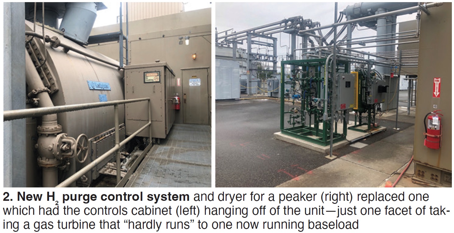

Imagine how many challenges a more than 40-year-old simple-cycle plant might face going from peaking, which is “hardly ever run,” to baseload ops. This presentation focused on the H₂ purge system for the 501D5 generators, proving that even the replacement of a relatively minor subsystem can lead to major headaches (Fig 2).
When your H₂ purge dryer breaks as a peaker, maybe you can get away with leaving it and locking it out and continuing to suffer from the control cabinet hung onto the unit which had presented many problems over the years (for example, vibration). Also, the skid was located outside. Solution for baseload service was to replace it with a new purge control system, dryer included, and change all the lines to stainless steel.
Project challenges included failure modes resulting from an OEM design disagreement between a fail-open or fail-safe valve; integrating the new equipment with an old, not optimized, CO₂ system; lots of wires to be pulled and P&IDs to update; islands of automation and “heartburn” over PLCs and HMI; infant mortality; cabinet purge; regulator issues; and components not designed for outdoor service and requiring heat tracing. Many others are discussed in the slides. Thankfully, the plant arranged payments based on engineering deliverables, rather than lump sum.
Generic lessons learned include:
- Involve the controls staff early in the process and make sure to check design against engineering standards.
- Identify equipment supply from the vendor before finalizing the contract.
- Demand (or ensure) that operating manuals are adapted to your site.
- Decide whether failure modes for valves are specced for safety or reliability.
- Make sure your skid is designed for the right service—for example, simple cycle, combined cycle, etc.

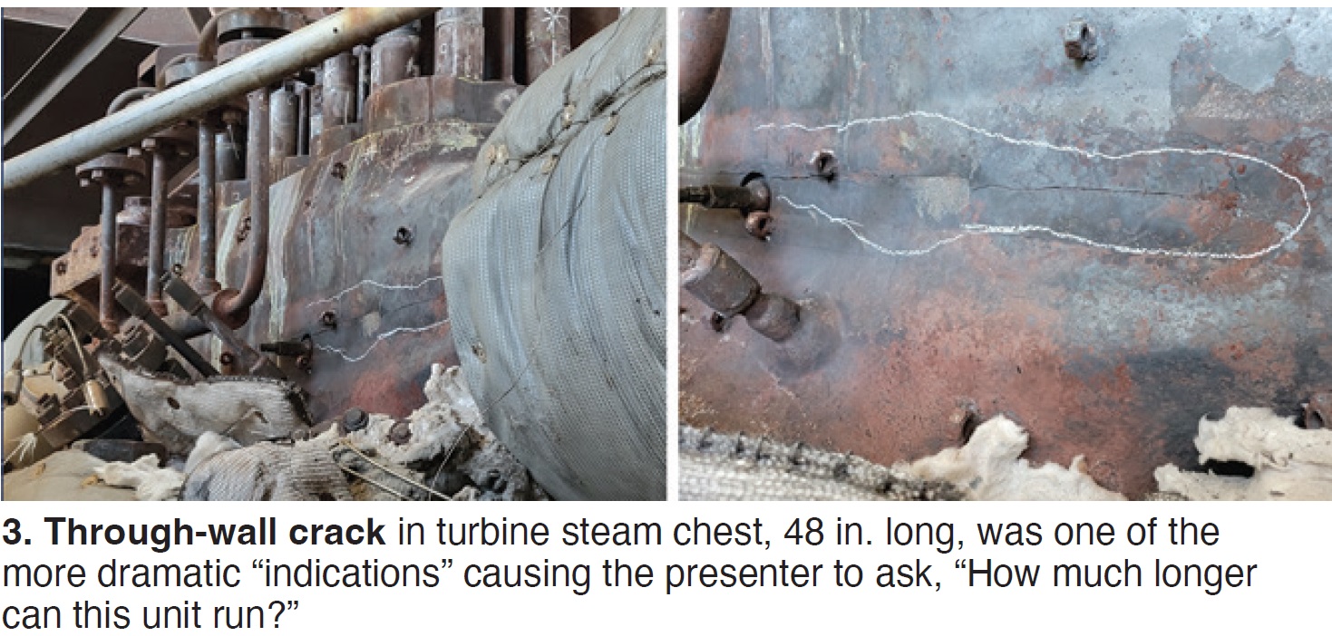

“ST Casing and Valve Body Indications Strategy” addresses the questions of how long and at what capacities can a unit run with multiple indications in the main-steam valve chest, HP and IP inlet leads, and HP-to-IP packing head fits. A 48-in.-long crack in a steam chest wall is particularly notable (Fig 3).

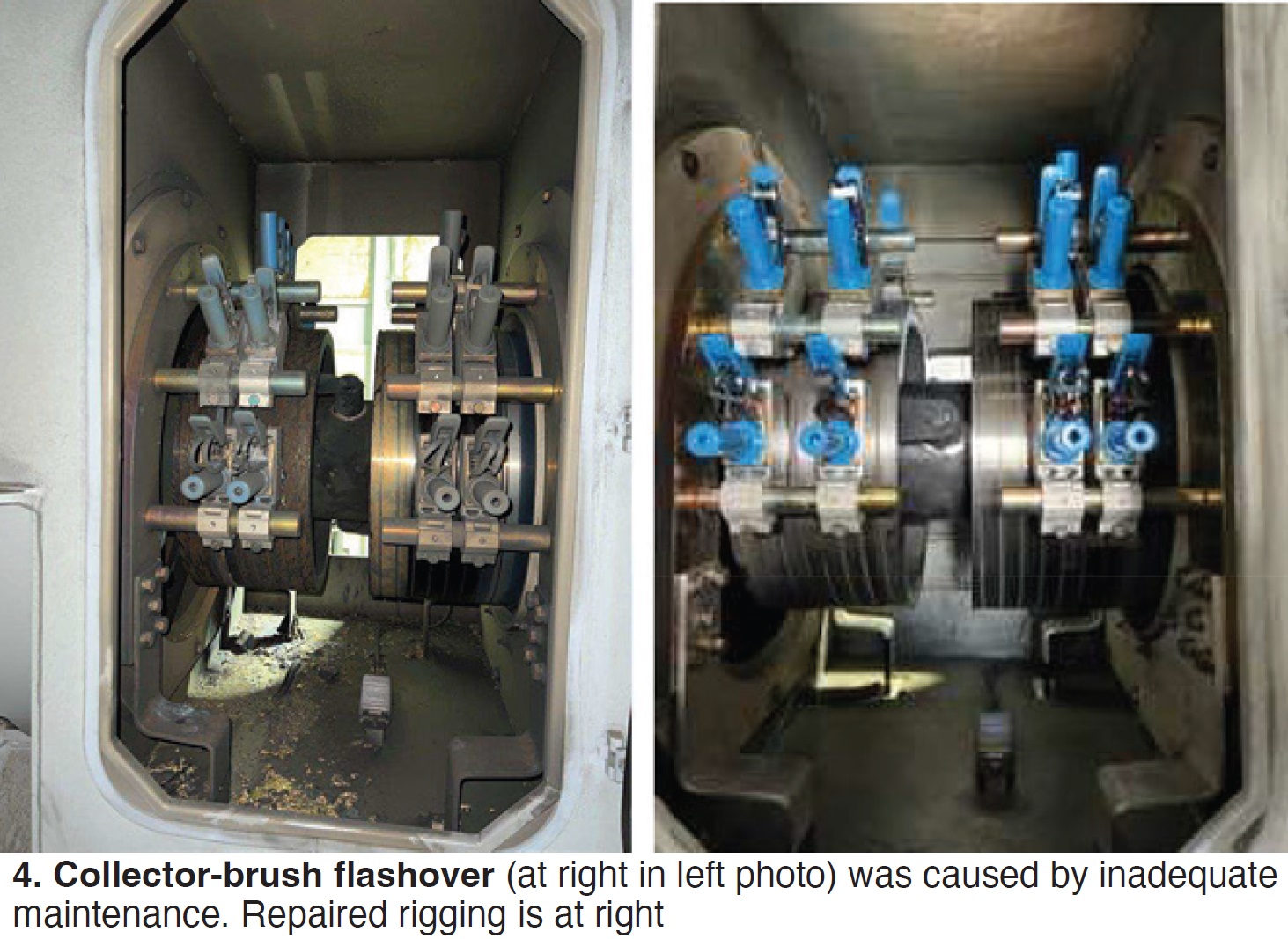

“Collector Brush Flashover Case History” pertains to a trip of a 148-MVA unit (critical to the grid) attached to a steam turbine after which inspection of the collector house indicated brush rigging failure (Fig 4) was caused by inadequate maintenance. Inspection, repairs, recovery, and subsequent shop repair of the rotor main leads during a scheduled outage are covered.

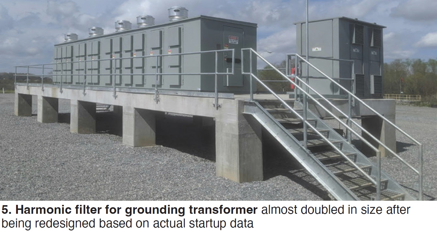

“Battery Storage Energy System (BESS) Black Start” describes in remarkable detail a BESS added to a site with a 2 × 1 combined cycle and one simple-cycle unit but one section notes that the BESS harmonic filter design, which was based on the Load Commutated Inverter (LCI) load for the simple-cycle GT (BESS is used to start the GT), had to be doubled in size based on actual startup data. If a BESS for similar duty is under consideration for your site, this is a must-read (Fig 5).
