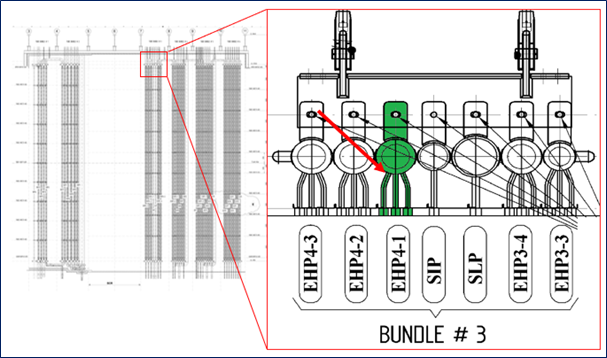

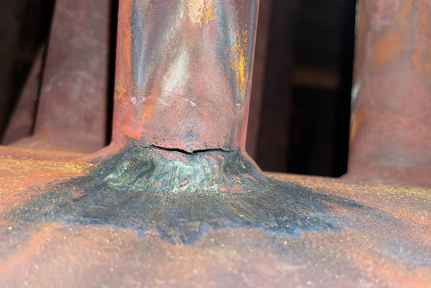

Inspection. Inspection performed with feed water pumps LOTO ON and HP economizer left full of water to easily check number and position of crack(s). One leak is observed on EHP4-1R tube on to lower header welding, on tube side, as shown on pictures below.

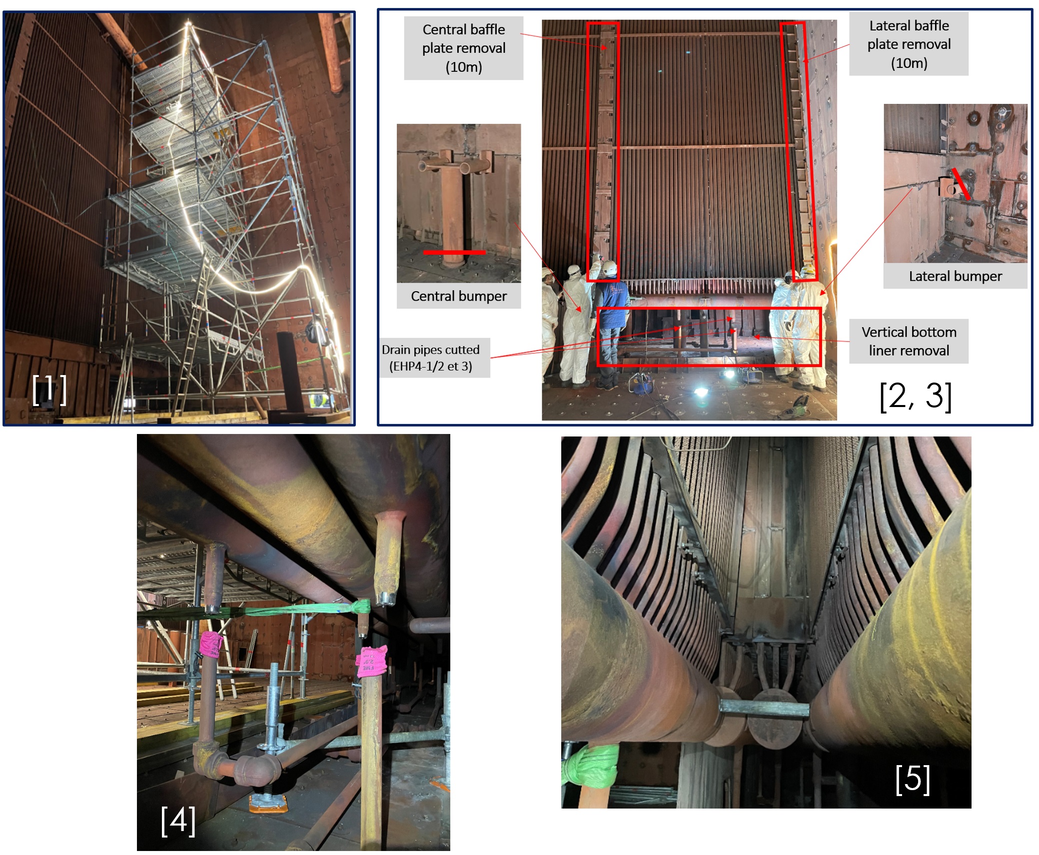

Repair method. HP Economizer exchangers are installed just after a SCR reservation in Bouchain HRSG which gives some access opportunities for repairs. As displayed on beside picture, EHP4-1 is installed in the middle of bundle 3 between IP superheater and EHP 4-2.
To reach this area, we proceeded with the following sequence and seen in figures below:
- [1] Scaffolding erection in SCR reservation from bottom to half height of the HRSG (approx. 10m),
- [2] Side baffle plate removal till 10 m,
- [3] Bottom bumpers removal,
- [4] EHP4-2 and 4-3 pulling with pull lift hanged on cut drain pipes,
- [5] Securitization of spread exchangers with one welded tube on both exchanger sides.

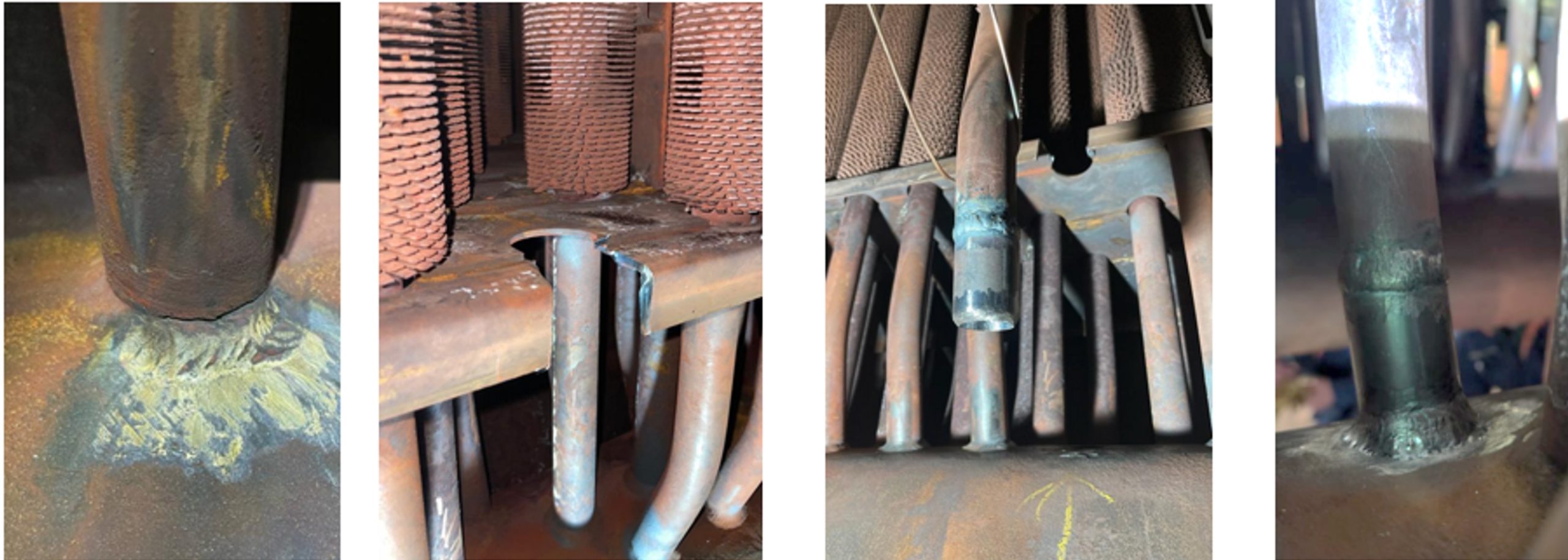

Crack repair. Once access became available, the crack was visually inspected and then PT performed. The crack is located on the root of the tube-to-header weld on tube side along approximately ½ of the circumference of the tube. Slight erosion of the header is observed which, after measurement represents only 1/10 mm over 42 mm thick header.
Cracked tube area is cut and extracted for RCA purpose. A tube spool is prepared and welded in place of the removed tube. As shown below, tube sheet has been cut to make tube preparation and but welding easier:
Once repaired, the sequence explained previously is redone reverse.

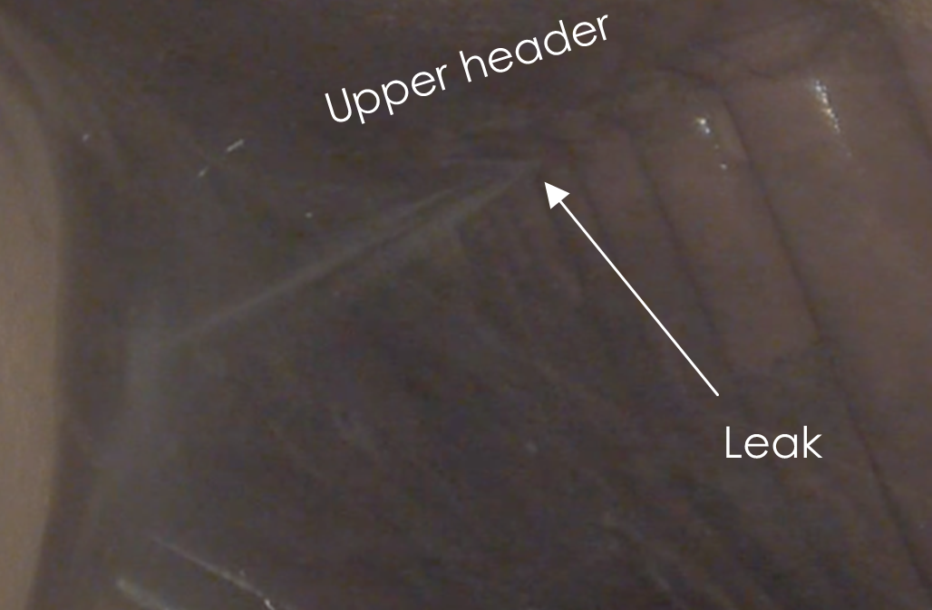

Unit is restarted immediately after this forced outage and producing during several weeks without interruption before annual planned outage. Visual inspection is performed on lower and upper headers during this outage, on water side and gas side. Nothing to report. Unit is restarted and on the grid for 2.5 months until a new leak is detected by water drip observation below the HRSG.
Location. The same method as for the first leak is used for crack localization. This time, the leak is detected on upper tube-to-header weld. BI from gas side picture besides shows the leak which seems to be in the same area as the first one but on the upper tube-to-header weld.

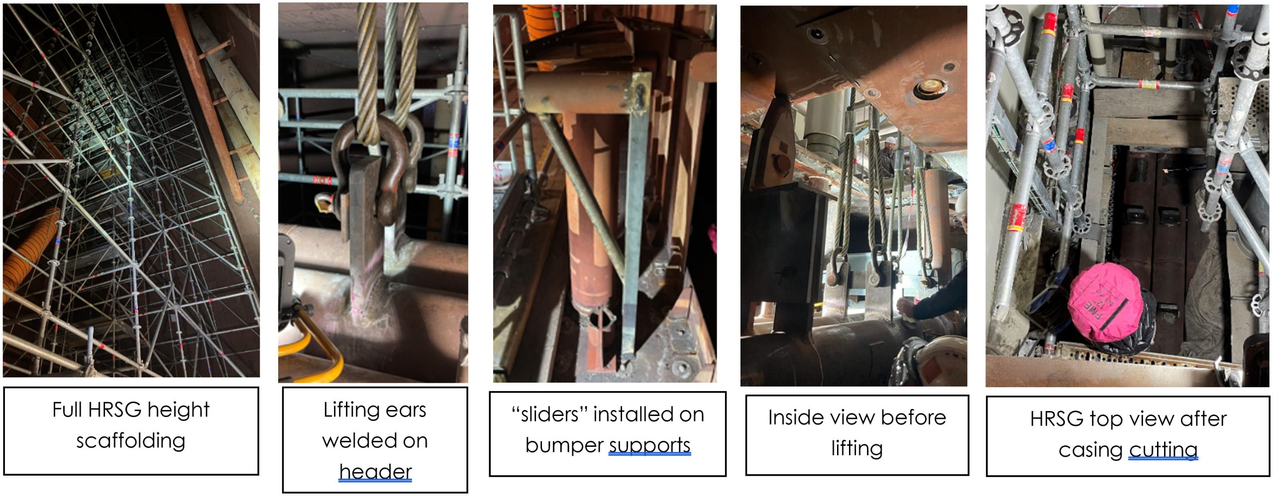

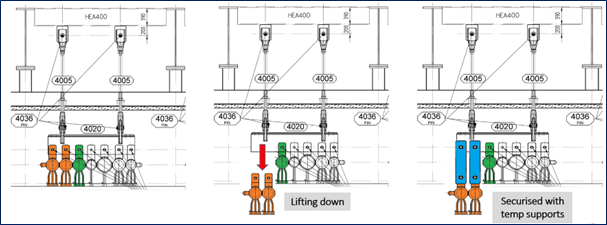

This innovative method consists in giving access to the upper tube-to-header welding area by lifting down the two front exchangers EHP4-2 and EHP4-3 of 25 tons each. The sequence principle is depicted below:
Before lifting, preparation job is needed:
- Erect a full height (20 m) scaffolding in SCR reservation
- Remove side and central baffle plates, bumpers
- Cut jumper between EHP4-1 and EHP4-2
- Cut vent pipe on EHP4-2 to EHP4-3 jumper
- Cut the EHP4-3 to drum pipe
- Weld lifting ears on down lifted exchangers upper headers
- Design and install sliders on cut bumpers supports to guide exchangers during down and up liftings
- Cut HRSG ceiling casing, insulation, and liners to provide a large access for slings and lifting devices perfectly above exchangers.

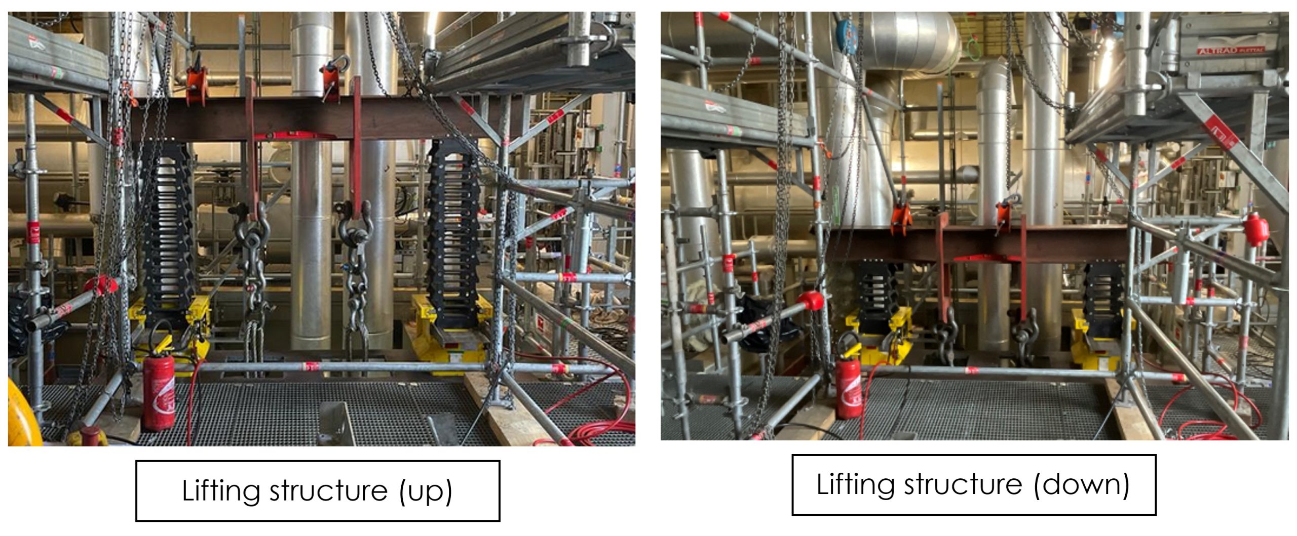

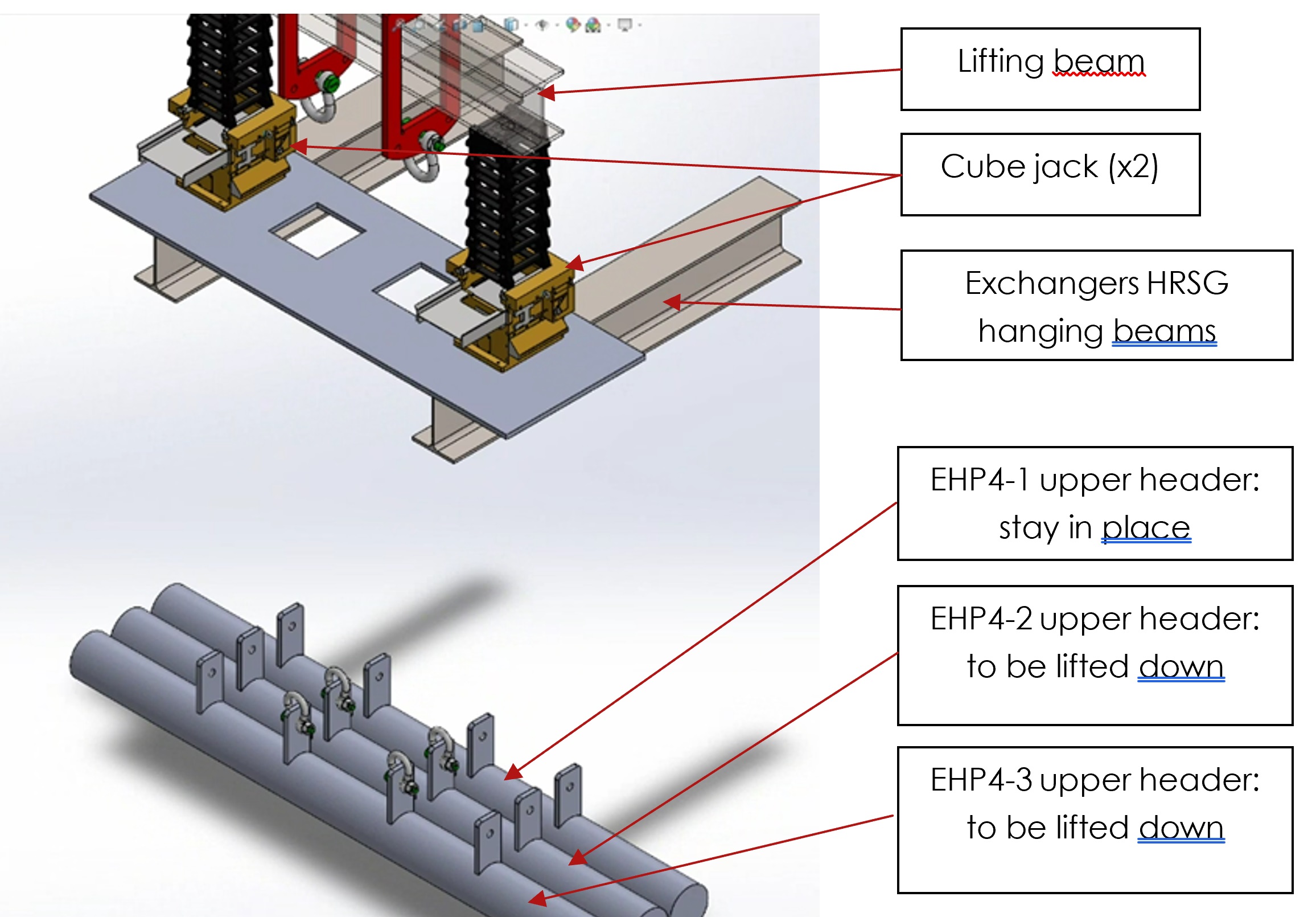

Lifting system. The lifting system has been designed for this specific operation. It is composed by two 50 t “cube jacks” and one beam installed on the top of the casing, seated on the exchanger support beam as shown on the following 3D model:

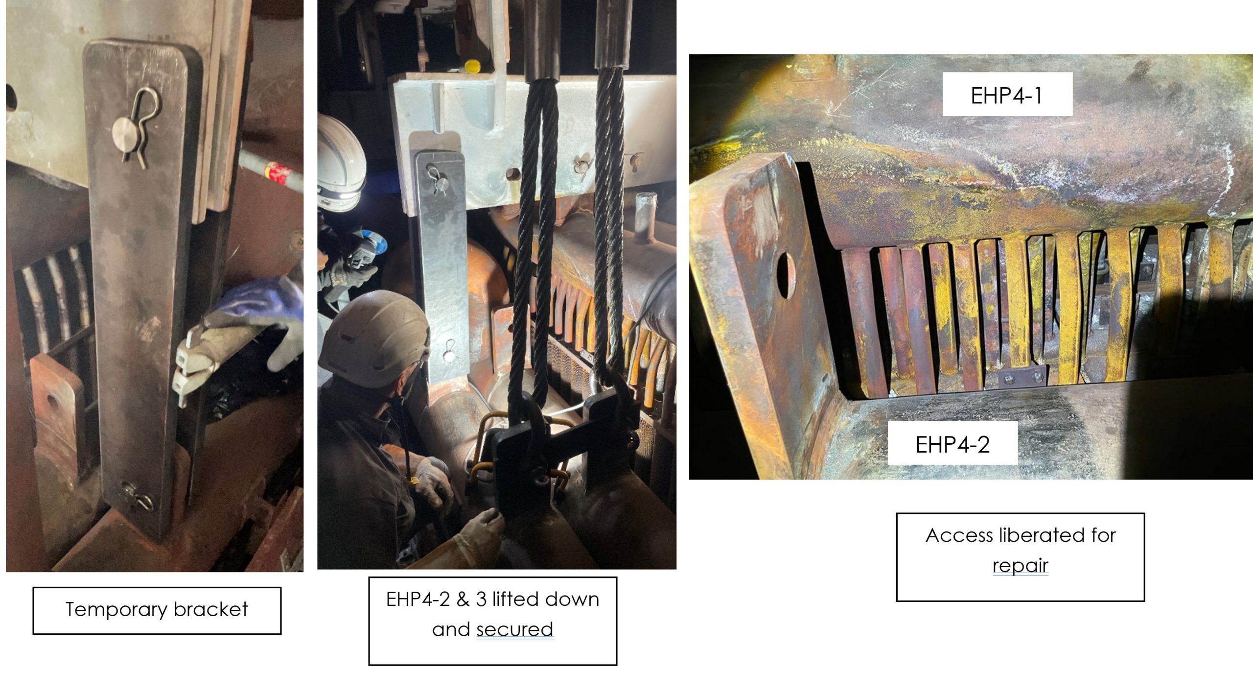

To give sufficient access for the welder, the two exchangers are lifted down around 600 mm and secured with temporary brackets:

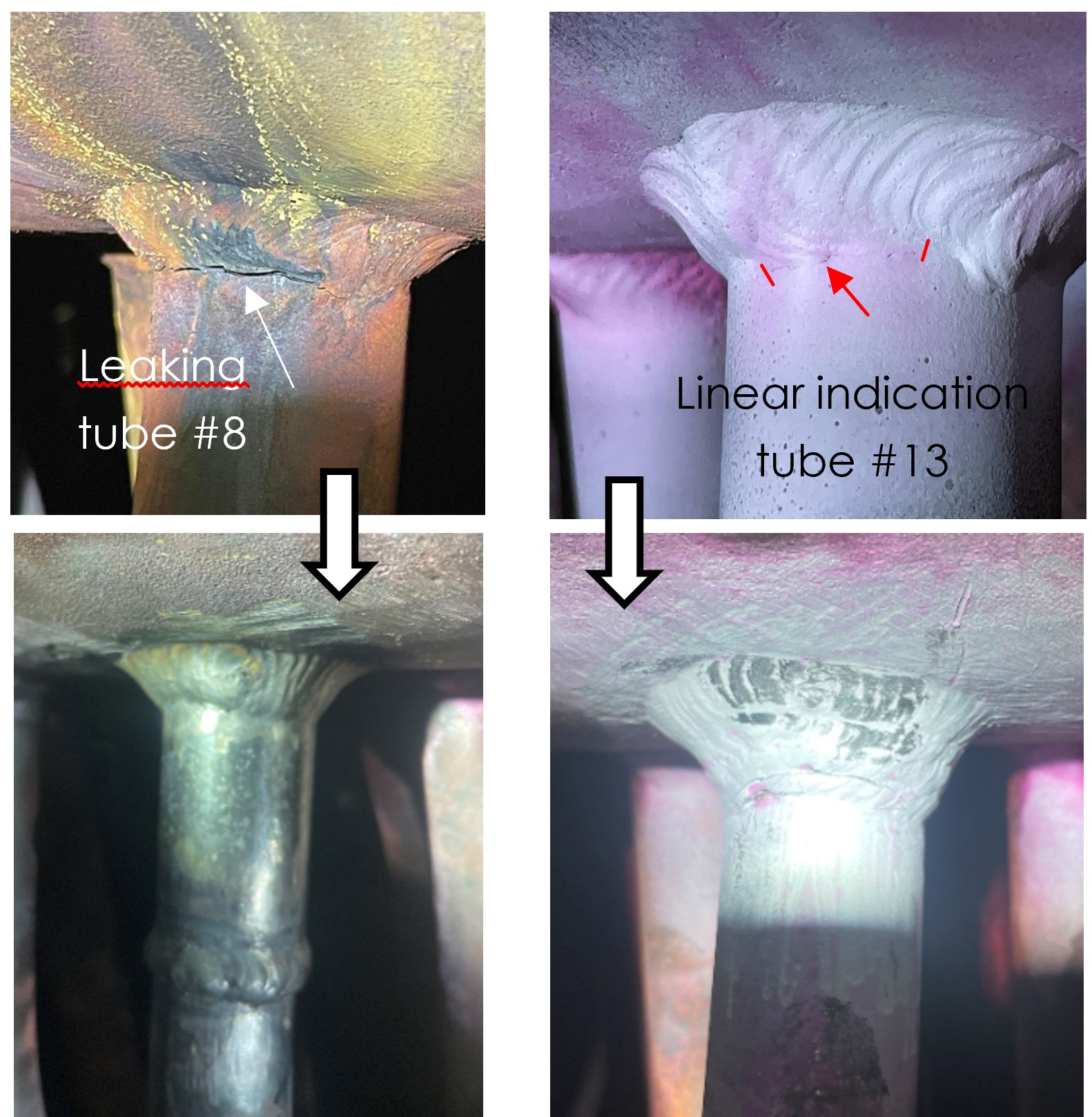

Once access to EHP4-1 liberated, penetrant test is performed on accessible tubes. One linear indication is found on Tube 13 close to the leaking one (Tube 8).
Tube 8 is repaired with the same method as for the first leak, tube 13 is grinded and rewelded.
Finding observed on Tube 13 support the decision taken concerning access method. Indeed, the presence of a crack initiated on Tube 13 represents a high risk of leak during winter. Inspection and proactive repair on this time certainly avoided third leak and associated forced outage for repair.

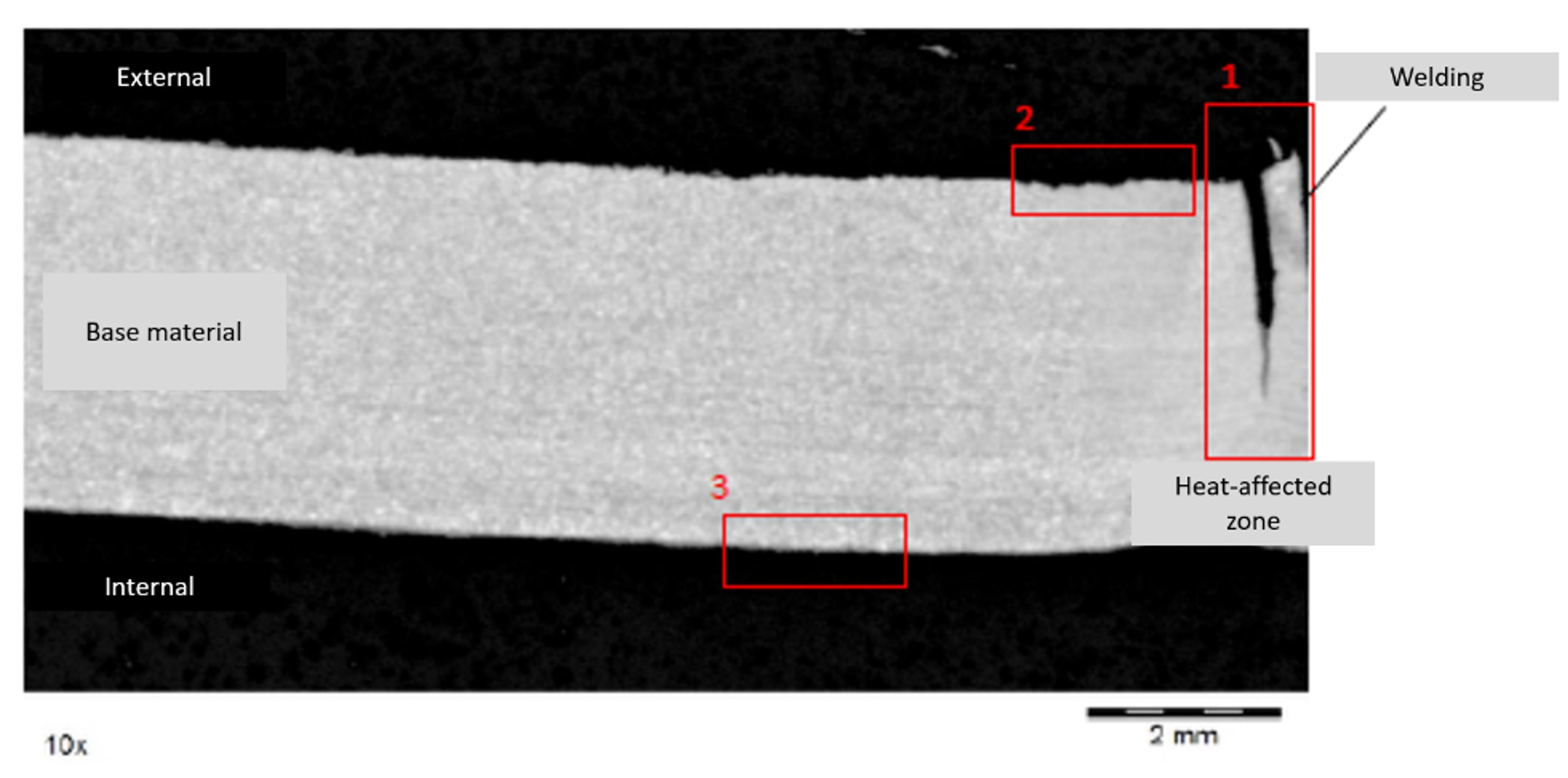

Two cracked tubes have been evaluated and are showing several thin cracks aligned, all in the root of the welding on tube side. “Leaking” cracks, eroded by water during operation with the leak are giving some clues and are already conclusive on thermal fatigue. The analysis of the second tube in a non-leaking area is showing some small cracks not completely opened and so presenting clean thermal fatigue facies.
Cracks are initiated on outer diameter of the tube and are evolving quickly through all the thickness of the tube. The connection between this thermal fatigue and the design of economizer/drum approach regulation system must be verified.
