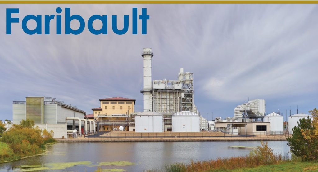

Faribault Energy Park
Owned by Minnesota Municipal Power Agency
265 MW, 1 × 1 7F-powered combined cycle equipped with a GE A10 steam turbine, located in Faribault, Minn
Plant manager: Shawn Flake

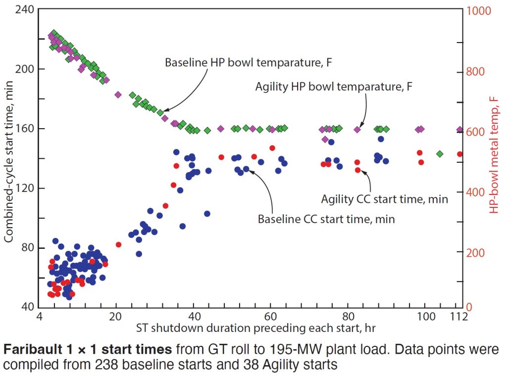

Results. Succinctly, implementing ST Agility starts has decreased fast-start time while reducing rotor stresses that consume life.
More specifically, combined-cycle start times, after a shutdown duration of 16 hours or less, have been reduced by nearly 10 minutes consistently (figure). Typically, with daily cycling, the shutdown duration is eight hours. Faster starts make the plant more responsive to grid needs while saving fuel. Shorter startup times are achieved by releasing the gas turbine at the optimal time to ramp to market based on steam-turbine rotor stresses.
Rotor stresses have been controlled by creating a stress “budget” for each startup.  Stress targets, measured in kilopounds per square inch (ksi), are used to reach minimum and maximum stress limits, allowing each start to consume a budgeted amount of life.
Prior to the upgrade, rotor stress trends on warm starts had several peaks and valleys throughout the warmup phase.  Controlling the steam temperature to hit plant’s ksi targets has removed the peak and valley effect of a traditional warming cycle.  Rotor stresses now reach the peak target, hold peak stresses through warmup, and release on the back end creating a plateau effect.
