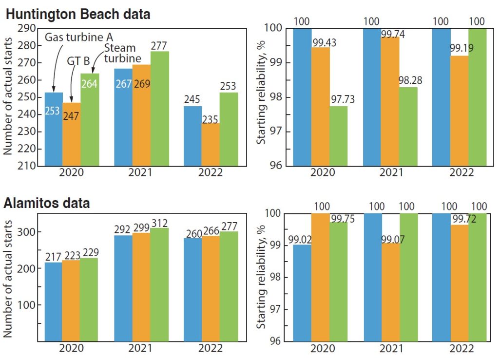

Results. Even averaging more than 250 annual starts in the last three years of operations, plant starting reliability has been averaging 99% (bar charts). This enviable achievement is attributed to the implementation of the process optimizations programs described above.
