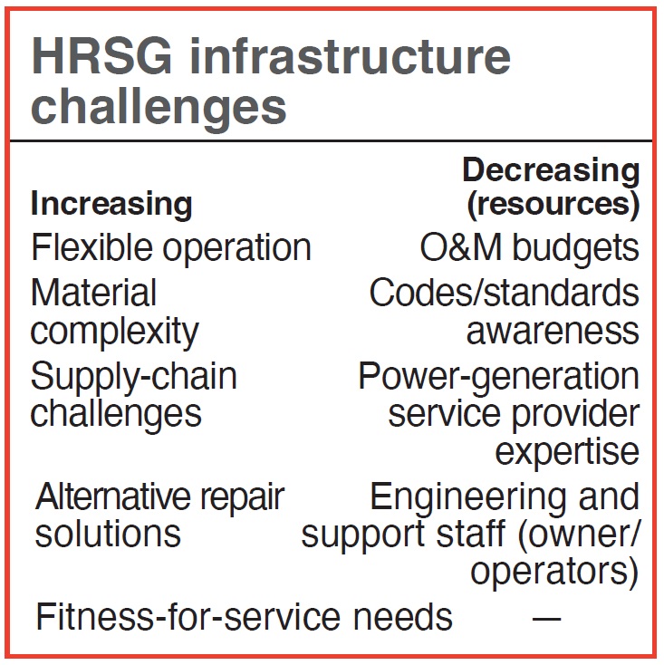

Today’s challenges
Tom Sambor offered an interesting assessment of the state-of-the-industry, and summarized HRSG infrastructure challenges (table), stating “Uncertainty is increasing; resources are decreasing.”
Sambor focused on the increasing need for an “integrated life-management” strategy, which EPRI has organized into seven parts. An integrated-life management approach for a component relies on, at a minimum, an equivalent consideration of mechanics (structural analysis, thermal hydraulics, etc), metallurgy, and nondestructive evaluation.
EPRI has numerous examples where each of these elements, he stated, are performed “poorly” by power generation service providers as they frequently lack a “rigorous approach.” See “Integrated Life Management of Grade 91 Steel Components: A Summary of Research Supporting the Electric Power Research Institute’s Well-Engineered Approach” for free download.

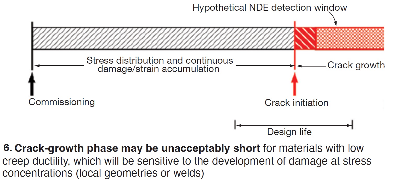

NDE and FFS. Interesting discussions followed on nondestructive evaluation and analysis. Showing large-feature cross-welds in Grade 91 material, Sambor stated that there is “limited detectability of creep damage in modern alloys via NDE.”
He also stated that “NDE alone is not an adequate life-management strategy. Mechanics and metallurgy (at a minimum) must be considered, and the uncertainty in these areas needs to be reduced as much as practical.”

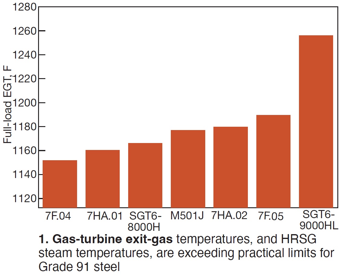

With modern gas turbines, exit gas temperatures of 1150F and steam temperatures of 1050F are exceeding the practical limits for Grade 91 steel (Fig 1).

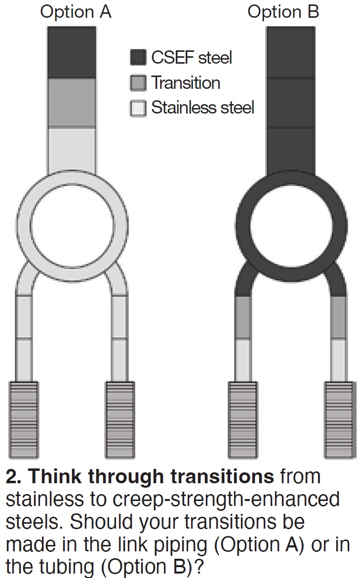

So, the question becomes: “Do you (the owner/operator) opt for advanced stainless/higher chrome CSEF steels, or push the 9Cr performance envelope?”

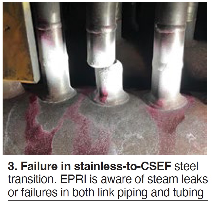

Advanced alloys offer options, but also some learning curves. For example, there could be options when transitioning from stainless steel to CSEF steel within the HRSG (Fig 2). The transition shown could be in the piping (Option A) or in the tubing (Option B).
Said Sambor, “EPRI is aware of steam leaks or failures in each case” (Fig 3).

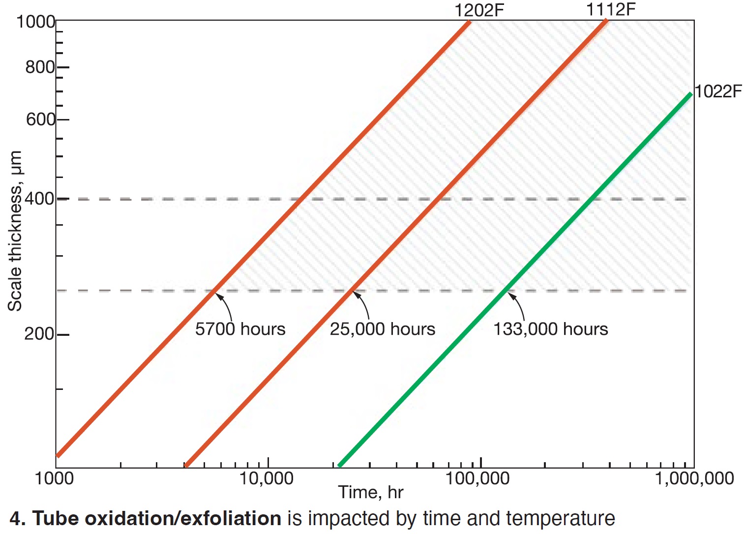

There are similar issues with tube oxidation/exfoliation (Fig 4).
Basically, care must be taken because modern gas turbines could be “abusing the HRSGs,” cautioned Sambor.

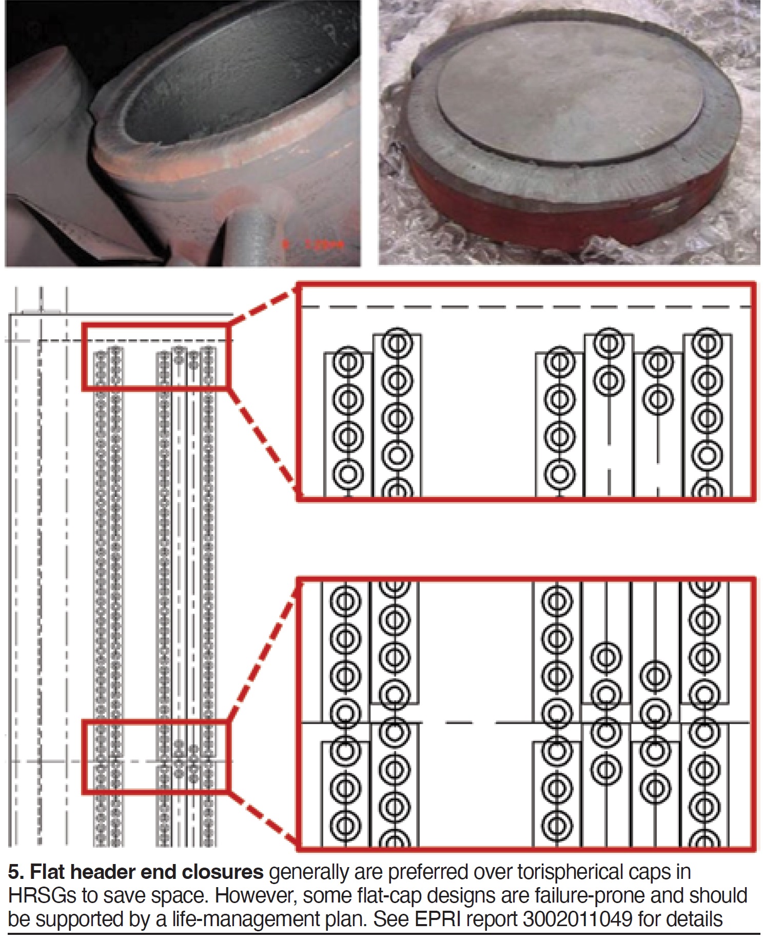

Header end caps
John Siefert next took the stage to discuss the state of knowledge and screening methodologies for header end caps, a growing industry safety concern. Flat-end closures are used in many HRSG headers primarily for their space-saving design (Fig 5). See “Life Management of 9%Cr Steels—Assessment of Header End Cap Geometries.”
While surface stresses can be high during startup and shutdown, which may lead to fatigue damage, the state of stress in the weld during normal operation also makes end caps susceptible to creep damage. EPRI is aware of failures attributed to both damage mechanisms. It is impossible to know if a failure is caused by fatigue or creep without a rigorous and integrated analysis of the root causes.
Case studies show that failure incidents are not new, and a few “catastrophic failures” were reviewed where the end cap was ejected without warning.
Siefert discussed the various end-cap designs and design rules, typical creep redistribution stresses, and cyclic operation thermal stresses, material chemical analyses, and typical inspection techniques.
EPRI’s recommendation is to implement an integrated life-management plan that considers the following:
  • Geometric configuration (including fabrication quality).
  • Design margins (excess thickness, for example).
  • Operating conditions (temperature imbalances and transients).
  • Metallurgy and risk (deformation and damage susceptibility).
  • Access for inspection, including where resulting damage is likely to occur.
  • Lifetime predictions.
  • Consequences of failure including plant operations and personnel.

Several factors, including material ductility, can compound and increase the risk to rupture for these materials (Fig 6).

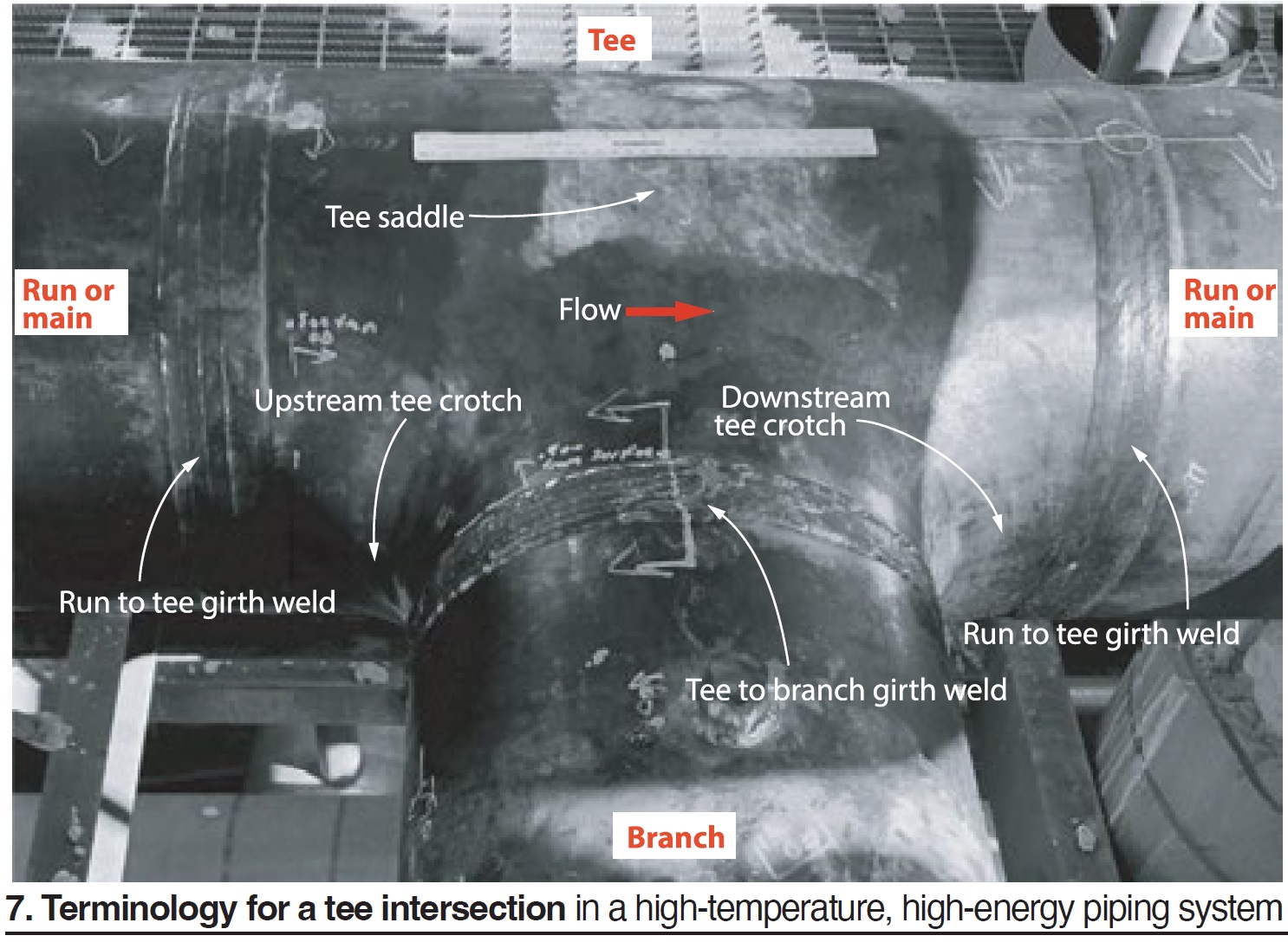

Tee intersections
Siefert returned to discuss another Safety Alert for steam leaks in high-temperature intersections, specific to tees.
An EPRI Industry Alert, Seamless tee intersections, was issued February 2023, suggesting that a single unit generally may have four to eight at-risk tees.  See Fig 7 for terminology. Discussions covered damage mechanisms, design, fabrication, operation, and metallurgy.
The damage mechanism discussion concluded that all the tee steam leaks to date could be attributed to the creep mechanism. Siefert emphasized that external metallurgical laboratory evaluation has also reached that same conclusion.
One reason for creep-related failures associated with these tees is inadequate design requirements, which may result in a lack of reinforcement and/or significant variability between supposedly identical tees.
In terms of fabrication, Siefert highlighted that the steam leaks “do not suggest gross issues linked to shop or field post-weld heat treatment,” which is a common concern with CSEF steel material. He instead identified a case where a tee crotch weld repair was performed and another case where a vee shape was roughly machined into the ID surface of the tee crotch, both fabrication issues that have affected the lives of tees.
Operation discussions summarized that units with tee steam leaks have all been operating within their design envelope (that is, operating below their design temperature/pressure), and summarized analyses that EPRI has performed to determine if cyclic operation (fatigue) is a concern.
For one case study analyzed, there is no evidence that the inelastic strain range calculated during cyclic operation would result in fatigue cracking within the number of cycles the tee has experienced, and there was no evidence to support ID-initiation for any of the observed damage.
Siefert finished the tee discussion on the topic of metallurgy, where he detailed a recent failure that is the first reported tee steam leak in a Grade 22 system, which means that this industry issue is not isolated to only CSEF steels. He also highlighted a case study where a tee was found to be the incorrect alloy, X20 rather than Grade 91, and emphasized the importance of positive material identification (PMI) on tees in the field for this reason.
Finally, Siefert emphasized the importance of metallurgical risk on CSEF steel tees by illustrating how the time-to-creep crack initiation could decrease by a factor of 10 because of increased metallurgical risk.
