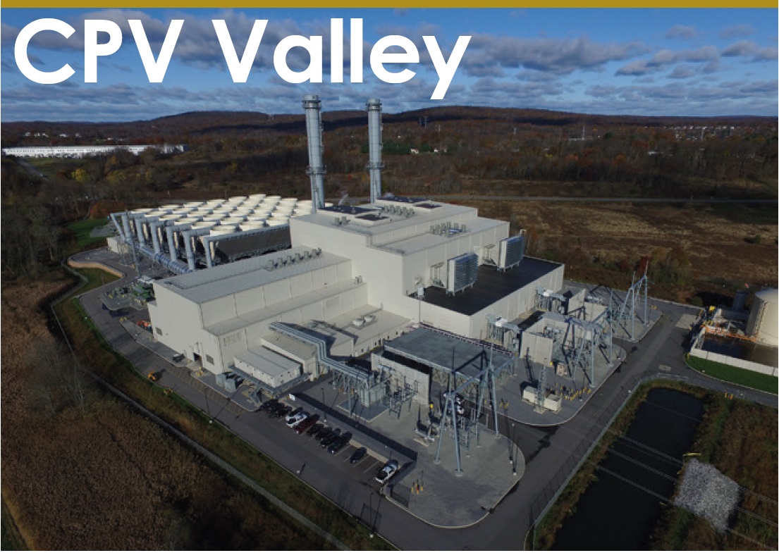

CPV Valley Energy Center
Owned by CPV/Diamond Generating Corp
680 MW, gas-fired 2 × 1 SGT6-5000-powered combined cycle, located in Middletown, NY
