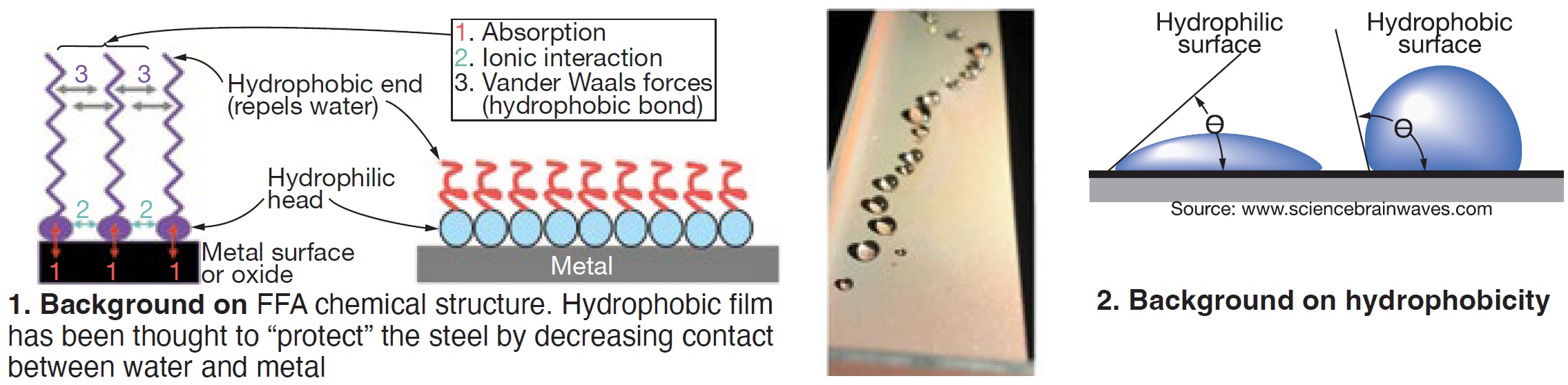

Most experience to date, he explained, is with the first category. Dooley then gave clear visual representations on FFA chemical structure (Fig 1) and the common topic of hydrophobicity.

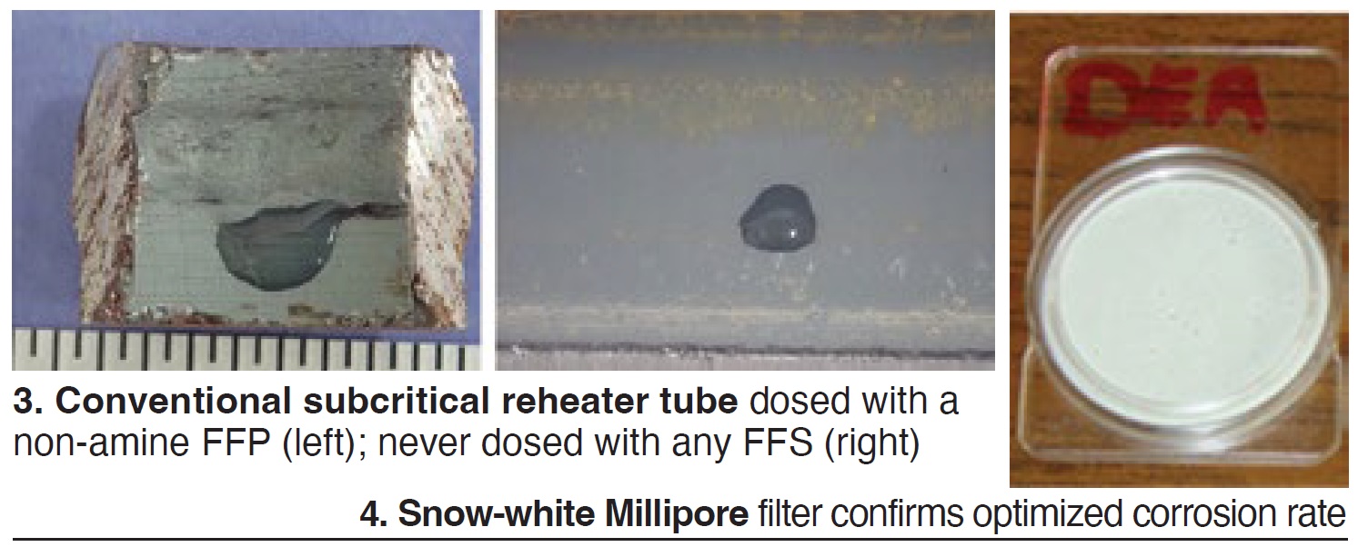

One overall caution came early: “Dancing water balls,” he explained, “are thought to indicate protection, but we now know that hydrophobicity does not necessarily mean protection” (Fig 2). This would be explained further with examples, such as Fig 3. In these conventional subcritical-plant reheater tubes, the example on the left was dosed with a non-amine FFP. The example on the right was never dosed with any FFS.
Dooley clarified that “It is unclear if hydrophobicity is a key aspect of corrosion control. In solution, some FFAs can actually be hydrophilic and increase surface wetting.”
This message reinforces the complicated nature of simple visual assumptions.

  2. There are general (visual) observations of hydrophobic films on water-touched surfaces, but “it is underlined that hydrophobicity does not prove presence of a film or any protection.” Refer back to the sketch of control angle in Fig 2.

One basic test shown for iron is the Millipore: snow white should indicate optimized corrosion protection (Fig 4). Said Hubbard, “I have never seen Millipores snow white and total iron not meeting IAPWS limit.”

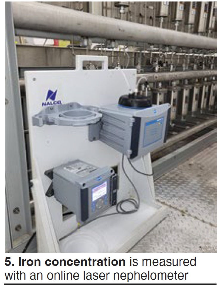

Little and Opsahl offered a case study of a 2 × 1 combined cycle in north Texas where market-driven layup practices had raised concerns about asset longevity. The plant faced wet layup of the HRSGs for long periods of time. A program was launched to reduce corrosion product transport, measured as total iron, to 5.0 ppb (EPRI action level).
Powerfilm was injected at the condensate-pump discharge. A low continuous dose (0.4 to 2.0 ppm based on feedwater flow rate) was applied during baseload operation, cycling load, and two–shifting on/off with hot standby. A high continuous dose (5 to 10 ppm) was applied for several days prior to shutdown and wet layup (1 month or less) or dry layup.
Using an online laser nephelometer, 3000 iron concentration data points were collected over a four-month period (Fig 5). Filter pad (Millipore) grab samples also were used.
Their summary of results showed that the nephelometer gave economic, portable, real-time collection of iron transport data, and concentrations remained below the target. Also, “iron reduction continued despite increased cycle events of the steam turbine.”
