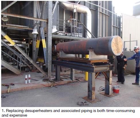

Control-valve hunting associated with steam temperature control is another relatively common problem with attemperators. It can put hundreds of cycles on your control valve daily. The consequences can be catastrophic, particularly with probe-type desuperheaters. They suffer thermal shock each time water flow is started. Rapid opening and closing of the control valve also is conducive to accelerated seat wear and a higher risk of leakage when the valve is closed.
Additionally, thermal cycles on downstream piping can lead to cracking of the protective thermal sleeve, if installed, or the base metal. Inspections should be conducted every two years given the number of problems plants are experiencing. The old inspection recommendation was every five years. Replacing desuperheaters and associated piping is both time-consuming and expensive (Fig 1).

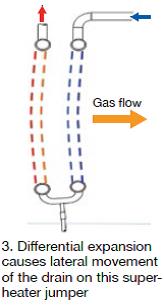

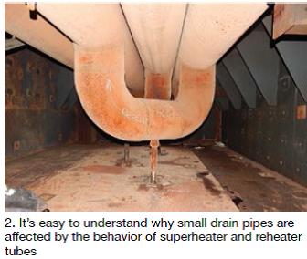

Fig 4 illustrates how the drains on superheater jumpers bend during different stages of startup and shutdown. Stanley provided several tips on how to avoid problems associated with drain-pipe stress. It all begins with a close inspection of the drains, he said. Next, upgrade floor penetration seals to allow sufficient lateral motion. This includes improving floor-liner flashing to avoid binding and lateral expansion interference. Plus, don’t forget to check tube-panel expansion guide supports for proper alignment, Stanley added: You don’t want drains serving as unintended guide points.Thermal expansion of superheaters and reheaters is an important consideration in any smart-start program. Very small drain pipes are affected by the behavior of superheater and reheater tubes (Fig 2). As Fig 3 shows, differential expansion amplifies lateral movement of the drain on this superheater jumper serving a top-supported superheater. High spray water flow to the interstage attemperator increases the risk of excessive lateral movement.
Stanley wrapped up this segment of his presentation with the suggestion that for some panel configurations, bent drain problems can be corrected by use of spring supports. They can reduce thermal stress on tubes and jumper pipes while also adjusting drain movements, he said.
