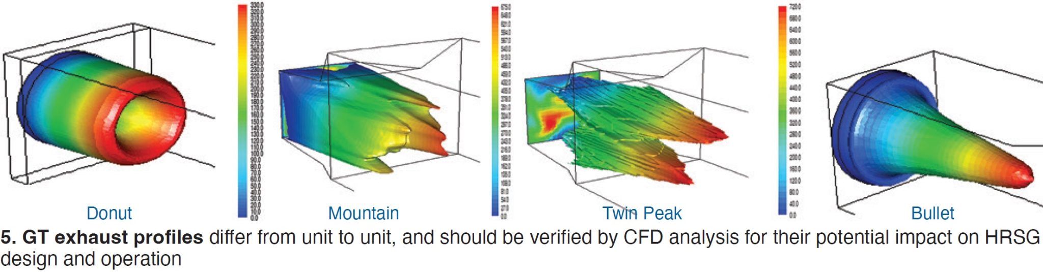

Of particular interest to CCJ readers may be that GT exhaust profiles can be quite different, depending on the design and configuration (Fig 5). And if you did already know this, at least the names are cute. There is the “donut” (peak velocities around 330 ft/sec), the “mountain” (peak velocity around 650 ft/sec), the “twin peaks” (peak velocity around 650 ft/sec), and the “bullet” (720 ft/sec). The exhaust profile should be verified by CFD analysis and accommodated, if necessary, through HRSG design modifications.

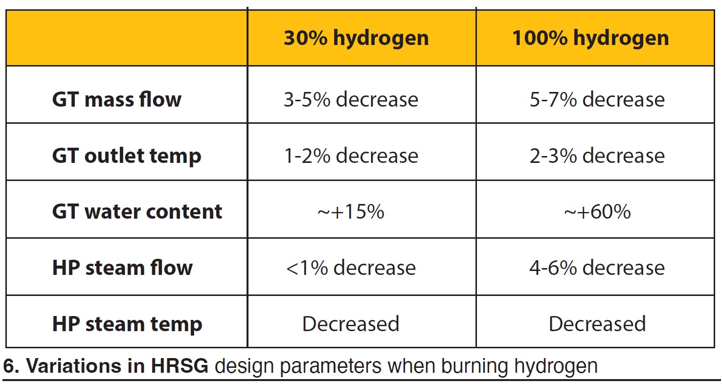

The last slide (Fig 6) is a handy guide to several important generic changes in HRSG design parameters resulting from 30% or 100% hydrogen firing. While the changes may seem modest on paper (the exception being GT-exhaust water content), an HRSG is a tightly designed subsystem and the impacts may be more than you think.
