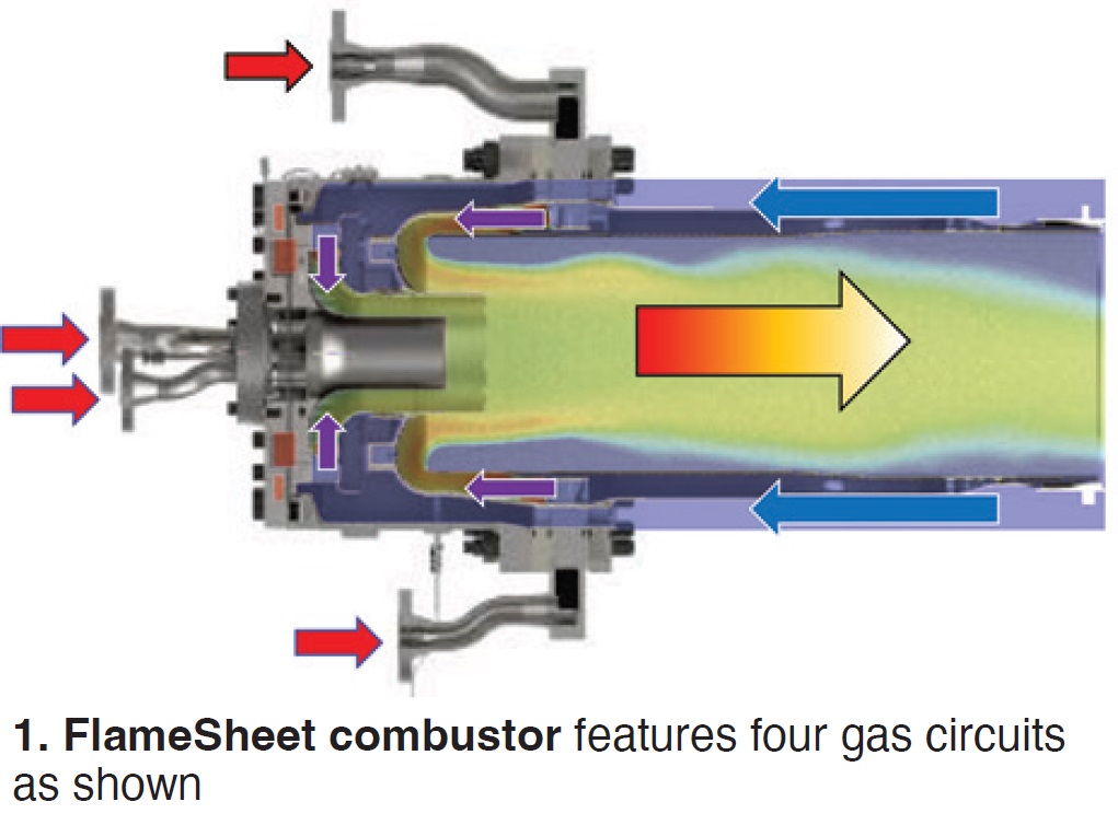

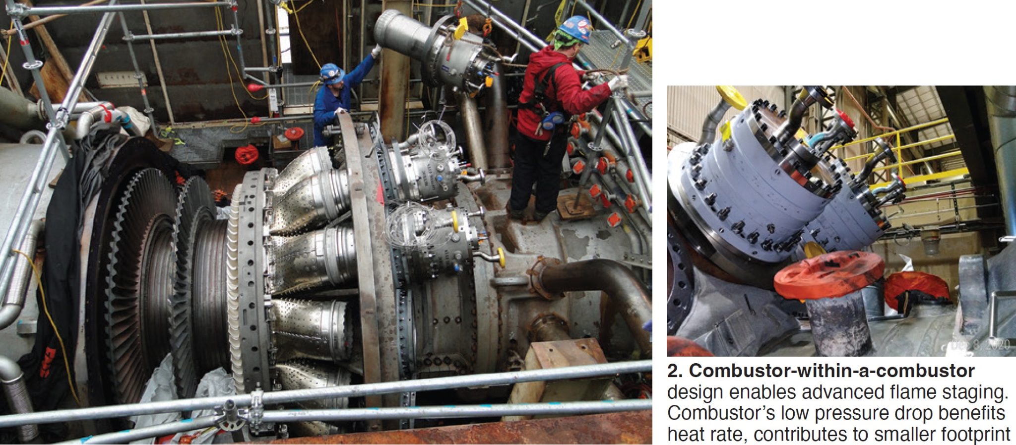

Recall that FlameSheet™ was originally developed for general operational and fuel flexibility. Simply, the concept includes four fuel circuits (Fig 1) to enable a “combustor within a combustor” design for advanced flame staging. This arrangement has two unique aerodynamic stages and relies on a trapped vortex flame to provide a wide stability margin. The pilot and main stages are effectively two independent combustors, each with its own robust flame stabilization mechanisms, allowing either combustor to operate with the other one off, enhancing operational flexibility (Fig 2).

Today’s FlameSheet™ Gen VI incorporates “micro-mixer” technology to better handle highly reactive fuels like H₂. Generically, micro-mixing refers to the goal of decreasing the “scale” of the fuel/air mixture, reducing flame length and resonance time (for combustion reactions to take place), and making the mixture as uniform as possible. This is accomplished by replacing the pilot in each can with a pilot utilizing this technology. PSM’s micro-mixing technology achieved sub-30% turndown in the 7F machine.
The four FlameSheet™ fuel circuits are called the pilot, pilot tune, main 1, and main 2. Subsystems include proprietary flashback monitoring and ignition designs. AutoTune is also part of every installation. Other salient features include these:
- Aerodynamic trapped vortex for wide stability margins.
- High pre-mixer exit velocities to tolerate highly reactive fuels.
- Robust mixing techniques for tolerance to Fuel Wobbe Index variations.
- Low-pressure-drop combustor for improved heat rate and smaller footprint.
