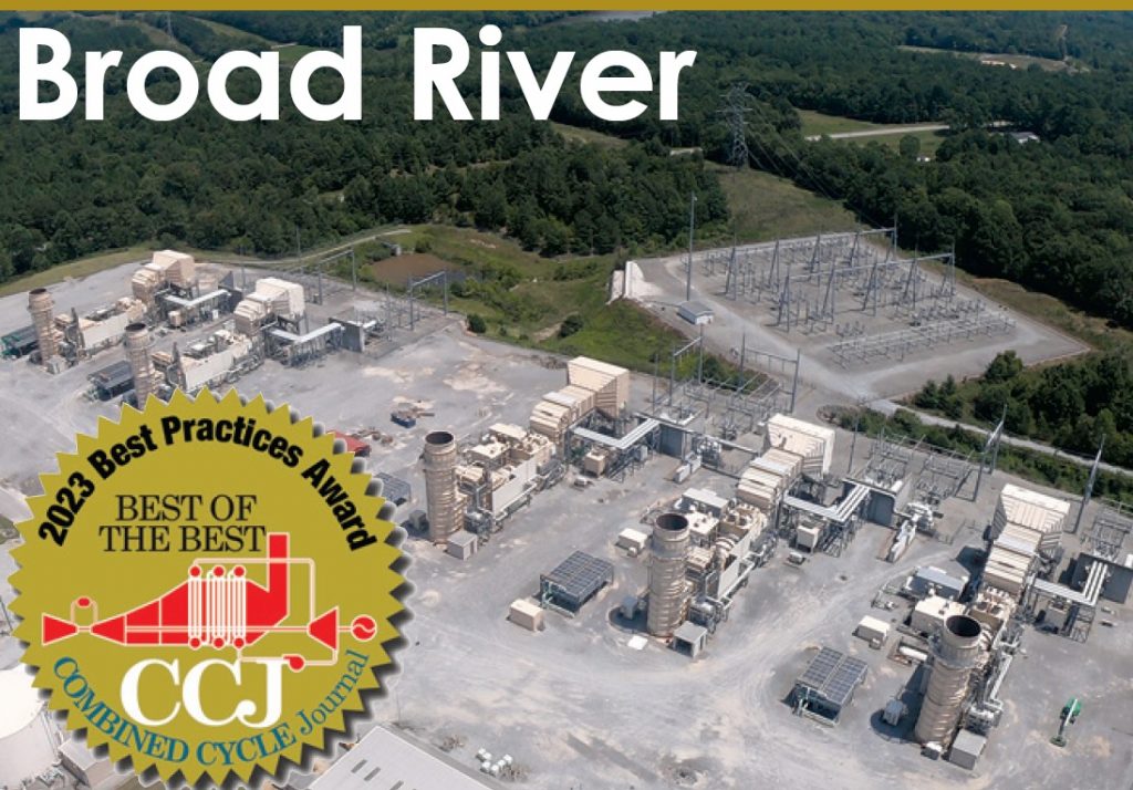

Broad River Energy Center
Owned and operated by Onward Energy
865 MW, dual-fuel facility in Gaffney, SC, with five 7FA.03 simple-cycle units, each equipped with an IST once-through steam generator
