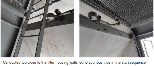

Ambient temperature TCs. At the frame site, a high differential among ambient-temperature thermocouples (TCs) was causing a “not ready to start” situation. Ambient temperature is measured with three TCs in the inlet filter house having a centerline oriented north-south. When the sun is in the West, the west-side thermocouple (W-TC) reads higher than the other two. This creates a differential that is interpreted as a “failure” resulting in a “not ready to start” status.
Examination of the inlet filter house revealed that the W-TC (photo at left), was much closer to the wall than the east-side thermocouple (E-TC, photo at right). The third thermocouple was on the centerline. The W-TC reading was affected by the proximity to the inlet-filter sidewall.
There were two compounding problems. The first is sub-optimal location of the thermocouples. For ambient-temperature measurement, it should be acceptable to install all three thermocouples about 2 ft apart in the center of the filter house. The second is that the sequence used a “no high differential” as a permissive to start—that is, a high differential would result in a “not ready to start” condition.
Thus, one thermocouple reading much differently than the other two resulted in a “not ready to start,” a single point of failure.
Two-part solution. The first recommendation is that, at first opportunity, the site should locate E-TC and W-TC closer to the center of the inlet filter housing, about two feet from the centerline TC. This has the added advantage of allowing maintenance on all three without maneuvering a step ladder while also avoiding the nuisance alarm during sunny periods of the day.
The second recommendation is to replace the “no high differential” from the permissives-to-start with a “two out of three TCs failed.” Having triple redundant TCs use the differential between the highest and lowest reading to determine start readiness does not make sense. With this simple mod, when one TC fails, the site gets an alarm but will still remain ready to start; two failed TCs will interrupt the start sequence.
