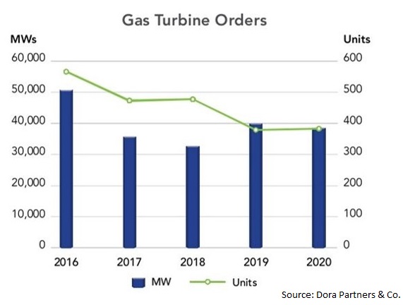

After a brief intro by Axford, Brough took over for 20 minutes of gas turbine market data, trends, and analysis. Some key stats from the presentation available for playback below:
      • Since 2012, GT unit orders down 67% and MW orders down 42%
      • Aeroderivative orders down in US by 69% but up worldwide 14% in 2020.
According to Brough, there are a variety of factors contributing to the GT market decline, outlined here:
      • Dramatic adoption of renewable energy impacts all size ranges of GTs, though the need for renewable offsets will eventually promote GT additions.
      • Overbuild of F-technology gas turbines, relegated to peak service. Though all evidence reflects these turbines are now transitioning back to their intended mid-merit and baseload usage. This means deployment of GTs <100MWs in the coming years could see an uptick, though balanced by renewable additions.
      • Technology substitution in the <15MW market where reciprocating engines have dramatically overtaken gas turbines due to a much lower acquisition cost and very good fuel efficiency.
      • The lack of comprehensive government and regulatory support for combined-cycle plants has stunted the great potential of highly efficient, environmentally friendly GT-based plant development, especially in North America.
Axford opened the meat of his presentation with the positive thought that the Covid shock to the global gas-turbine order book was not as bad as had been anticipated (Brough said about 40 GW were ordered in both 2019 and 2020, more than in 2017 and 2018) but the long-term trend is still on downward trajectory. Primary reasons he gave for the decline in orders: regulations, mandates, and subsidies.
