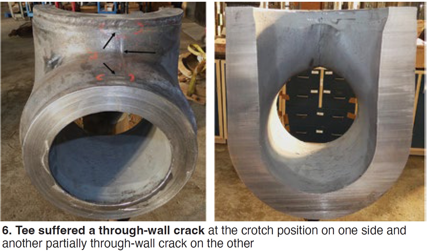

Henry began with what a recent failure suggests about the state of our industry. It concerned the failure of a 10-in.-diam tee after 80,000 hours of service (Fig 6). The component, from a 635-MW coal-fired boiler producing steam at 3700 psig/1050F, suffered a through-wall crack at the crotch position on one side of the tee, and another partially through-wall crack on the other side, both ID-initiated.
Also, cracks at the toe of both the run and branch girth welds were OD-initiated.  Multiple tees on two other units suffered similar creep-related damage.
The material specified was Grade 91. Units were built “to Code,” but analysis found that the materials did not match the plant’s RFQ specifications, although they “came from a reputable OEM.”
Other materials discrepancies were found at the plant.
This is just one example of multiple tee failures in multiple units in the US, and “EPRI has estimated the number of tees potentially at risk could be in the thousands,” Henry said.

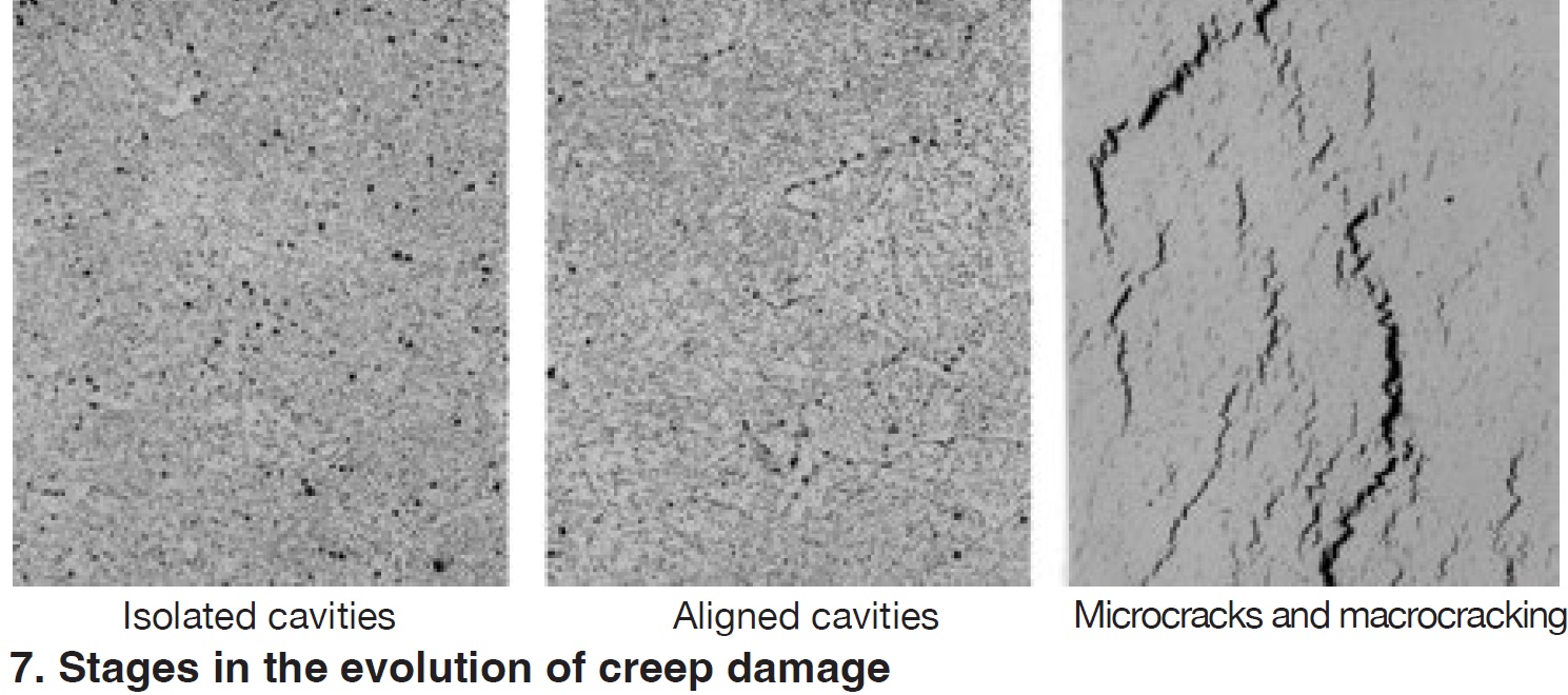

  • Pressure-part life and creep (Fig 7).
  • Creep damage in welds.

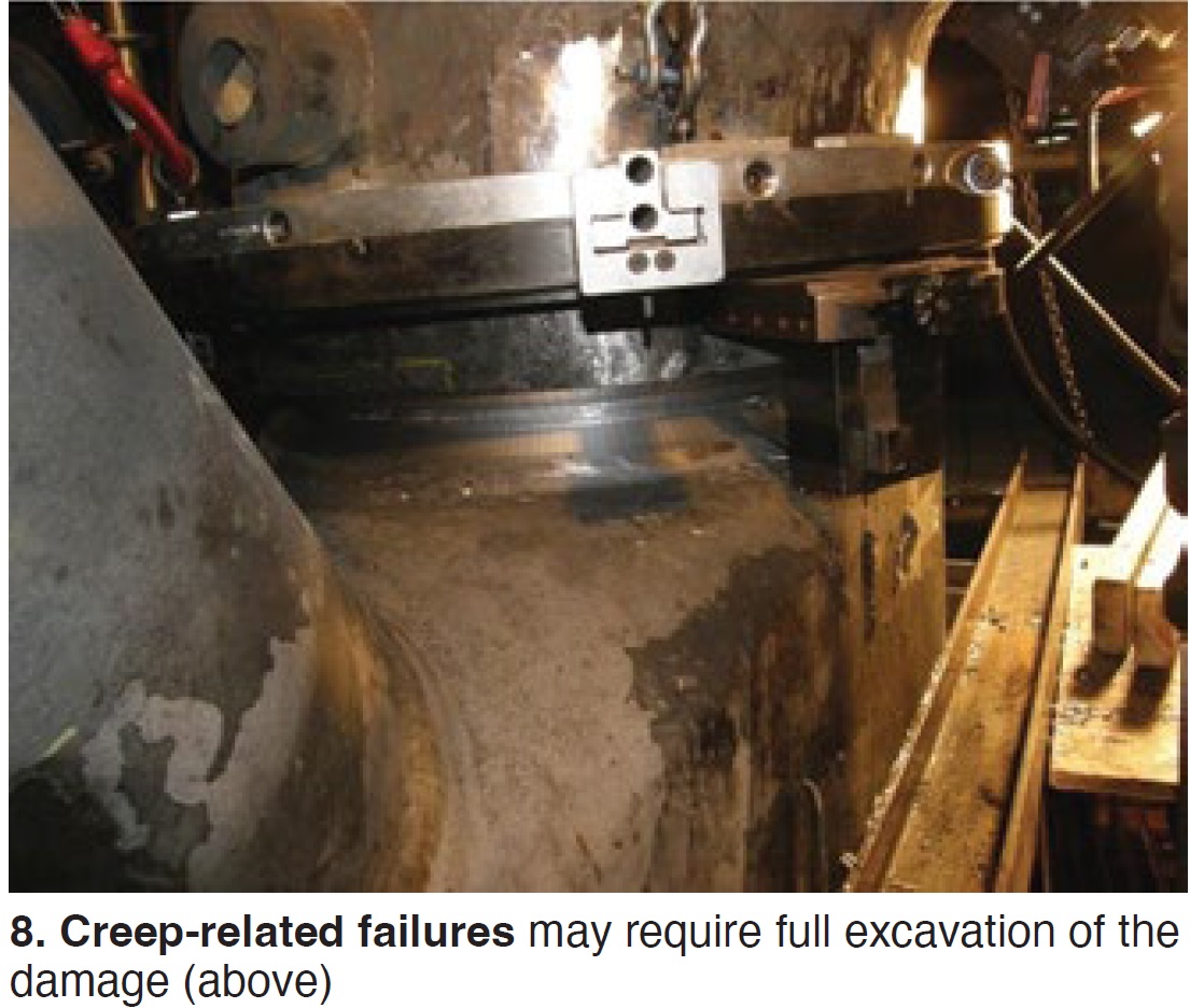

  • Define the proper repair method, work scope, and resources required. Creep-related damage, for example, may require full excavation of damage (Fig 8).

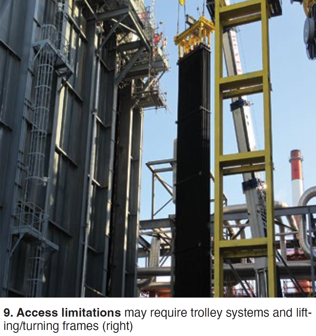

Case studies offered interesting looks at access, trolley systems and lifting/turning frames (Fig 9). Many examples are shared in the presentation.
