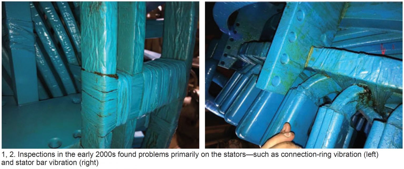

A dozen inspections were conducted on GT generators at this plant from 2001 through 2019, allowing a meaningful assessment of deterioration rate. Engineers found that generators deteriorated at a greatly increased rate when cyclic duty changed from perhaps a half dozen cycles per month to a half dozen cycles per week (especially during the summertime) beginning about 2005-06. The damage primarily has appeared on the rotating fields, as experts expected.
Inspections conducted in 2001, 2002, and 2003 found problems primarily on the stators (Figs 1 and 2). Loose wedges also were observed. Stator rewedging was performed to replace the “camel-back” wedge systems, a system of rather poor design used for a few years by this OEM.

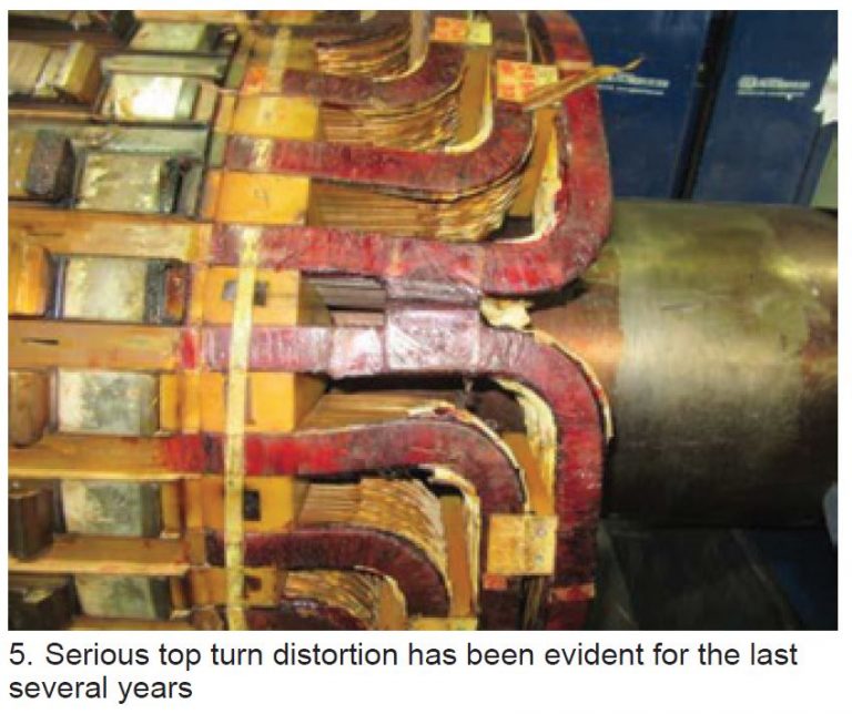

In recent years, serious top turn distortion became apparent (Fig 5). This copper distortion is caused by a combination of insufficient copper hardness, endwinding blocking design, and cyclic duty—and is a fairly common problem on fields. By 2018, distortion had reached a level sufficient to require field rewind, and the first of the fields was rewound. The second field was rewound in 2019 because of nearly identical copper distortion.

For stators this would include (1) an endwinding support structure that adequately allows for the always-present axial expansion of stator bars, (2) bonding or clamping of endwindings and connection rings to allow axial expansion while preventing vibration at contact points, and (3) proper stator wedge material selection and design to remain mechanically stable throughout the normal operating and cycling temperature ranges.
