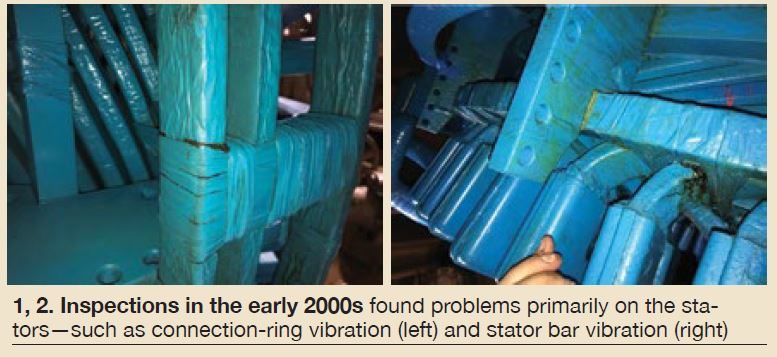

Inspections conducted in 2001, 2002, and 2003 found problems primarily on the stators (Figs 1 and 2). Loose wedges also were observed. Stator rewedging was performed to replace the “camel-back” wedge systems, a system of rather poor design used for a few years by this OEM.

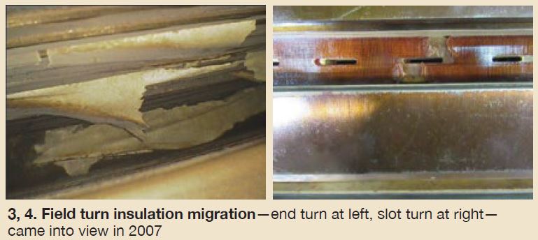

By 2007, field turn insulation migration was beginning to be noticed. By 2015, insulation migration was sufficient to schedule the first of the field rewinds; however, that work has yet to begin (Figs 3 and 4).
Load cycling causes the copper turns to have a tendency to move axially at the field body ends, and to assure the turn insulation lamination stays in place each lamination is bonded on one side to the adjacent copper turn.
The heavy cyclic duty combined with elevated temperatures over time may cause debonding and allow the turn insulation to migrate out of place. If the migration becomes severe, turn shorts begin to occur; the only repair is field rewind. This was the case on two of the generators at this site. Minor inspections resulted in finding gross turn insulation migration, forcing unplanned major outages for field rewinds.

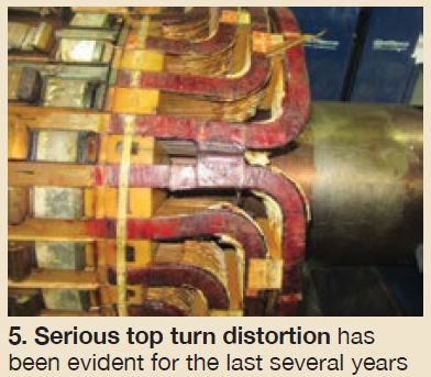

In recent years, serious top turn distortion became apparent (Fig 5). This copper distortion is caused by a combination of insufficient copper hardness, endwinding blocking design, and cyclic duty—and is a fairly common problem on fields. By 2018, distortion had reached a level sufficient to require field rewind, and the first of the fields was rewound. The second field was rewound in 2019 because of nearly identical copper distortion.
