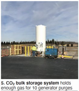

Transitioning from CO2 bottles to bulk storage
Challenge. When generator purges were needed, Hunterstown relied on portable 160-liter CO2 bottles. Pressure in the bottles decreased over time (outdoor storage, exposed to sunlight), rendering the bottles minimally effective. Multiple bottles were needed to complete a single purge.
Plus, time-consuming operator manipulation of the bottles was needed to complete each purge. Staff had to transition between units and the CO2 storage facility and to secure spent bottles and line up new ones. Such maneuvering was critical during emergency generator purge situations because of the time required to begin flowing CO2 to a generator. On more than one occasion, nearly 30 minutes elapsed between the time a purge was started and gas began to flow.
Solution was simple: Install a bulk storage system. Key components are the following:
Storage tank with a capacity of 1550 gal (Fig 5).
Electric vaporizer to convert liquid CO2 to vapor to prevent two-phase purge flow.
CO2 condenser to convert excess vapor back to liquid, thereby preventing tank losses to atmosphere.
Safety shutoff device to ensure liquid CO2 cannot reach the generators.
Instrumentation for tank level and pressure with data routed to the DCS to monitor consumption rate and to reorder CO2 when necessary.
Results. Cost of the bulk storage system, installed in February 2020, was less than $350,000—including equipment, engineering, installation, and commissioning. Bulk storage eliminates bottle demurrage charges of about $11,000 annually and simplifies operator actions to start CO2 flow, saving several minutes over the bottle alternative.
Expectation is that the four units on site can be purged twice before a refill is needed, while retaining sufficient gas for two more unit purges (total of 10).
