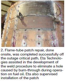

Case history 2, V84.2 flame-tube patch repair during a major outage.
A hole was burned through a combustion flame tube when burning oil (Fig 2). Eta Tech supplied and rolled patch material; then assisted in weld-procedure development and supervised patch installation onsite within the outage window.

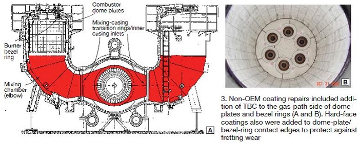

Case history 3, Non-OEM coating additions to components in the combustion section.
The inner casing on a V84.2 is a large fabricated assembly which takes the hot gases from the two combustion chambers and turns it into the first-stage turbine vanes (Fig 3). Curtis said the casing is fabricated from Inconel-617 plate and has steel radiation liners to direct and control cooling air flow over it. It and other hot-gas-path components suffer in-service deterioration—including distortion, oxidation, cracking, fretting wear at fixation/interface points, and rusting of steel parts.
The health of HGP components can be maintained by regularly monitoring the wear and tear on coatings and hard-facing and repairing damage identified. Curtis, a gas-turbine materials and coatings expert, showed roundtable attendees where they should pay attention using Fig 3A. He pointed to the burner bezel rings and combustor dome plates and offered advice on thermal barrier coatings (TBC) and chromium-carbide hard-facing materials best suited for those areas.
Following the gas path, he suggested application of TBC in areas of the mixing chambers prone to thermal stress. For the inner casing, he suggested a full coating of TBC. At the intersection of mixing-chamber transition rings and the inner-casing inlets, he recommended chromium-carbide hard-facing.
Curtis showed several photos TBC and hard-facing applied on critical components and provided one picture looking up into the combustor dome to illustrate a quality job (Fig 3B). Access the PowerPoint in the CTOTF Presentation Library to view wear areas on specific components and the work done to mitigate that damage.
