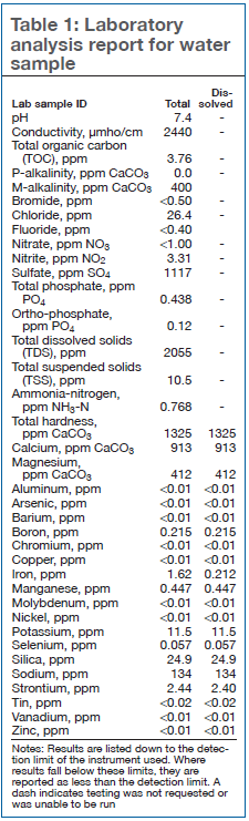

Pulling a water sample for laboratory analysis is a good start in preparing an RO design. A comprehensive analysis provides data on the metals in the water (for example, iron, manganese, and aluminum), the dissolved salts (cations and anions), the water pH (acidity), and possibly the inorganic total suspended solids (TSS). A measurement of the total organic carbon (TOC) will often correlate with the potential for biological activity (Table 1).
A TSS analysis reveals the concentration of filterable solids in the water. The concentration of dissolved metals, such as iron, will change in the water sample as they react with oxygen introduced by contact with air. This will cause some of the metals to oxidize and become insoluble. The metals that stay suspended in the water may cause the TSS value to increase significantly with many well-water sources.
Biological fouling solids will not be well represented in the TSS results. The mass of these solids will typically become negligible when the TSS filter is dried prior to weighing for results. The water could be tested for its silt density index (SDI) if the metals are first separated out of the sample. This test will be highly sensitive to the ability of biological solids to coat and reduce the flow rate through its 0.45-micron test filter. Results will correlate with the fouling tendencies of a membrane system.
No analysis is perfect, and water quality can change over time. Even the characteristics of a well-water source will change if the well is relatively shallow.
Sampling methods affect results. Some concentrations will change between sample pull and analysis. Metals may attach to the container’s inner surface. Ammonia and carbon dioxide may degas or carbon dioxide may dissolve from exposure to air. Any of these changes will cause the water pH to change. An accurate water pH is best measured onsite.
Chemical suppliers can use a water analysis to predict how much purified water (permeate) the RO might safely separate from the source before the dissolved salts become too concentrated in the remaining water and form scale within the membrane elements (Table 2). The water analysis is also used in designing the RO system, both in projecting the purified water quality and in assessing any effect of the salts on system hydraulics.

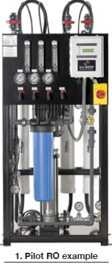

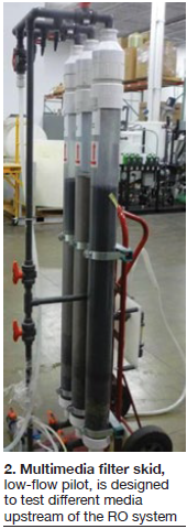

Pilot study
An RO system and its pretreatment equipment designed solely on one water analysis may not be fully optimized for the fouling characteristics of the source. It might be oversized or, of greater concern, it might not be ideal for water that has a high membrane fouling potential. This can best be determined with a pilot study (Fig 1).
A well-designed pilot study will use components that have been scaled down but still offer the same type of media and use similar flow velocities and exposure times. The pilot RO should duplicate the permeate recovery, the permeate flux rate (that is, permeate flow per unit of membrane area) and concentrate stream vessel exit velocities, along with the scale inhibitor dosage and shutdown flush methods.
When the pretreatment methods are piloted along with the RO, the system operation can be adjusted to minimize the rate of RO membrane fouling, such as by modifying the permeate flux rate or the rate at which water passes across the membrane surface and through the membrane elements. With the right equipment choices and sizing, it might even be possible to eliminate membrane fouling, which could then dramatically reduce operating cost and maximize membrane life (Fig 2).
The choice of membrane might also be evaluated. With large systems, demonstrating that a low-fouling membrane element performs better than a standard element will help justify its higher cost. Low-energy elements might be evaluated for their potential to reduce pump size and associated power consumption.
The pilot study also offers an opportunity to learn more specifically about what will foul the RO system. A membrane element from the pilot study might be pulled and autopsied. Analysis of the solids then makes it possible to choose cleaning solutions that are best suited for removing the particular fouling materials. The effectiveness of the solutions and cleaning methodology might then be verified with the pilot unit.
The longer the pilot system can be operated, the more information will be gained. A minimum of several months is recommended.

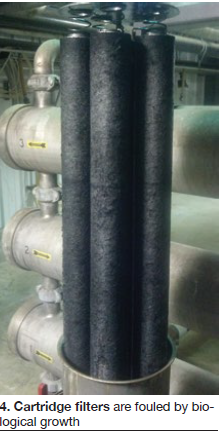

Membrane fouling
Fouling will not necessarily reduce RO membrane life if the RO is effectively cleaned. If the RO is allowed to foul too severely and cleaning is not effective, then the membrane will likely continue to lose performance.
It is common to include a filter housing on the RO inlet that contains 2.5-in.-diam cartridge filters whose pore size is nominally rated. The actual ability for removing smaller particles can vary greatly (Fig 4). Some (regardless of rating) will only protect the RO against large particles that might get caught within the membrane flow channels or damage the high-pressure pump. These are inexpensive and may last weeks before an elevated pressure drop indicates the need for replacement.
Tighter porosity filters that might remove more of the incoming suspended solids are more expensive and will also require more frequent replacement. Therefore, the use of these tighter filters becomes more economically viable if the concentration of suspended solids in the water has been minimized by upstream treatment.
Suspended solids often can be effectively reduced to reasonable concentrations for the downstream RO system with just a multimedia filter. Its inclusion in the RO water system might be sufficient to prevent a high RO fouling rate that could result in unmanageable cleaning requirements. Multimedia filters contain granules of two or more different types or sizes of sand, crushed rock, or anthracite (hard coal). Such a filter can be successful at removing most of the particles that make up the suspended solids if:
  • It is sized for a downward flow velocity approaching 2 ft/sec.
  • It has a lower collection lateral system designed to obtain uniform flow distribution across the media when the filter is operated at low flow velocity, while also allowing the entry of a sufficient backwash flow rate for a 40% bed expansion.
  • The filter is backwashed before its previously removed smaller/fine particles are shed, which may occur before there is an appreciable buildup in filter pressure drop.
  • After backwashing, the filter is forward-rinsed at its service flow rate until its effluent quality is acceptable (such as based on effluent iron concentration, turbidity, or SDI).
The preceding points do not provide all of the filter design requirements, but were chosen because these particular guidelines often are not followed (mostly because they would increase the filter’s cost).

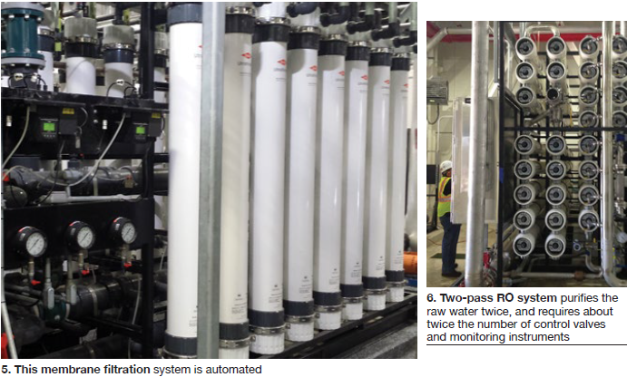

Membrane filtration
Membrane filtration is becoming more common in various applications including pretreatment for RO systems. Membrane filtration often can provide water that is more consistently low in its concentration of suspended solids than that provided by a pressurized multimedia filter. Therefore, these systems may be used as an alternative to multimedia filtration, or possibly downstream to further polish the water and minimize RO fouling.
The most common configuration is hollow-fiber technology. Fibers of an inert polymer are extruded with a hollow internal region called the lumen. The fibers may be relatively fine/small in diameter where the inlet water passes through the outside of the fibers, and the fiber lumen. It then moves toward one end of the module for collection.
Because the fibers are tightly packed, flow movement around them is not uniform. Feedwater particles will come out of suspension on the membrane surface as the water goes through the fiber. They are not concentrated within a passing stream as the particles mostly would be with spiral-wound reverse osmosis, so there is no concentrate stream. The systems are simply operated at 100% recovery, except for the water losses from frequent backwashing with filtered water, resulting in an overall recovery of 90% to 95%.
There also are modules with larger fibers that use an inside-out service flow direction. The fatter fibers offer improved membrane surface flow characteristics for better distribution of the fouling solids, while the finer fibers offer the cost advantages of more membrane surface area in the modules.
The membrane filtration systems (Fig 5) should be sized to keep the fiber pressure differential (transmembrane pressure, TMP) relatively low to prevent compaction of solids against the fiber and into the fiber pore structure, and to reduce the potential for fiber breakage. This may mean sizing the fiber for a filtrate flux rate of 30 gal/ft²/day or less.
The fiber modules are backwashed using the filtrate water at a frequency of roughly once every 30 minutes, again to try to keep the solids from compacting and to prevent particles from getting forced into the pores and subsurface structure. Some manufacturers will reduce the backwash volume by knocking the solids free with compressed air.
Backwashing alone may not fully restore the original TMP. A chemically enhanced backwashing may then be required. If this fails to restore original performance, a circulated cleaning for an extended period of time may be needed.

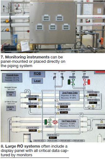

Large RO systems will include several membrane pressure vessels. These vessels will be staged so that the concentrated salt stream from one set of parallel-plumbed vessels will be plumbed into a smaller number of membrane vessels, then possibly plumbed to another stage with an even smaller number of vessels.
Staging is based on maintaining flow velocities sufficient to keep suspended particles moving and to assist dissolved salts in diffusing back into the bulk stream from the membrane surface (Fig 6).
RO systems usually are operated by adjusting the membrane feed pressure as needed to achieve the desired RO permeate flow rate. This may be done with a variable frequency drive (VFD) to control the high-pressure pump motor’s rotational speed, or by using a throttle valve located directly downstream of the pump. With VFD control, the adjustment may be automatic. The RO system will also have a concentrate stream throttle system to achieve the desired concentrate flow rate. This may be a fixed system that uses an orifice plate, or more commonly a manual or automatic valve.
Along with the permeate and concentrate flow meters, pressure sensors are installed in the system piping to monitor the pressure entering the membrane elements, the concentrate pressure exiting the membrane, and possibly the pressures within the plumbing manifolds that connect the membrane vessel stages (Fig 7). A permeate pressure sensor may be needed, especially if there is significant or variable permeate backpressure on the system.
The electrical conductance of the water streams is used to monitor how well the RO is removing dissolved salts. The RO permeate water conductivity is monitored along with the makeup water conductivity.
A percent salt rejection for the system is calculated by subtracting the permeate conductivity from the feed stream conductivity and then dividing this value by the feed conductivity. The salt rejection percentage is probably the most commonly monitored performance variable.
Additional instruments may be needed if there is variability in the feedwater characteristics, or if a chemical is being added (Fig 8). If the water acidity changes naturally or through chemical addition, then the water pH should be monitored continuously.
The pH can have a dramatic impact on the RO salt rejection. If chlorine is being removed upstream, an online chlorine monitor or possibly an oxidation-reduction potential (ORP) monitor may be used to warn against its presence.

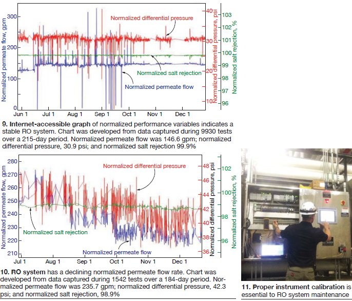

Key variables
Monitoring the percent salt rejection is important, but is limited in its ability to show the state of the RO membrane and is generally not a good gauge of membrane fouling or scale formation.
The relative ability for water to permeate the RO membrane can be tracked using a variable called the normalized permeate flow rate, which is the RO permeate flow rate standardized for the effects of operating pressures, dissolved salt content, and water temperature. The feed-to-concentrate pressure drop tracks the resistance to water passage through the flow channels of the various membrane elements. This value may be calculated for the entire RO vessel array, or if inter-stage pressures are available, it can be calculated for the individual vessel stages.
If flow rates are not kept constant when operating the RO, it will be necessary to standardize the pressure drop for the effect of changing flow rates in calculating normalized pressure drop values. This then allows direct comparison of these values over time regardless of whether any flow rates have changed (Fig 9).
Small suspended particles or salt particles that coat the RO membrane surface will cause the RO normalized permeate flow rate to decline (Fig 10). Larger particles that get caught within the membrane flow channels and subsequently block the flow will cause the normalized pressure drop to increase.
If something in the water is chemically reacting with the RO membrane, the effect will likely be apparent in the normalized permeate flow rate, and possibly in the salt rejection. For example, if chlorine is allowed to come into contact with the RO membrane, the extent of membrane oxidation will be apparent as an increase in the normalized permeate flow rate soon followed by a decline in RO salt rejection.
A thorough understanding of the state of the RO system can thus be gained by routinely calculating and graphing the salt rejection and the two normalized performance variables. But their values may be misleading if any of the instrument readings are inaccurate. It is absolutely critical that monitoring instruments be routinely calibrated and repaired/replaced if in error (Fig 11).
