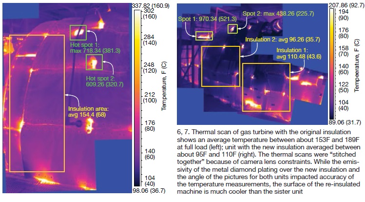

The plant benefited financially from the cooler package and lower insulation surface temperature provided by the new insulation (Figs 6, 7). To illustrate: (1) Change out of witches’ hat strainers was accomplished in less than half the time it took with the old insulation. (2) The pulling of gas lines on baskets at the bottom of the unit was done after an overnight cool-down—much faster than previously. Plus staff was happy not to suffer “hot foot” from walking on the top of the turbine. Regarding thermal performance, engineers said the heat-rate benefits would be difficult to calculate given the number of variables requiring consideration, and likely would be small in any event.

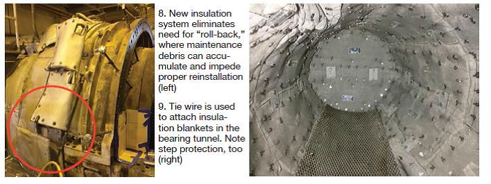

The new single-layer insulation system is relatively complex, requiring about 450 blankets for a 501FD2. The maintenance manager said he believed a technical advisor (TA) might be required if a given task required removal of a large number of blankets—just to save time. However, he added, only about one-third of the insulation must be removed to lift the upper casing. This would eliminate the “peel-back” issue that was an annoyance with the original insulation. That’s where waste material from maintenance activities would collect between the insulation and casing, impeding a proper replacement (Fig 8).

Insulation in the bearing tunnel also was replaced as part of this project. In Fig 9, note that tie wire (not pins) fastened to support brackets is used to attach insulation blankets on internal surfaces rather than the Velcro used on external surfaces. Also, wear-resistant aluminum plating protects the bottom of the tunnel.
