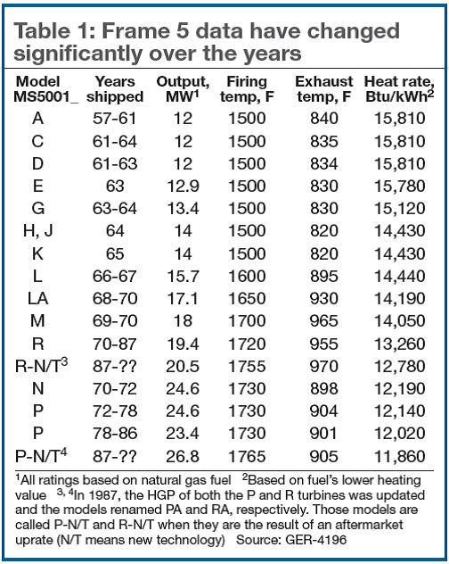

The Frame 5 gas turbine originally was manufactured by General Electric Co and subsequently produced by GE and its licensees—including Bharat Heavy Electricals Ltd, John Brown Engineering Gas Turbines Ltd, Hitachi Ltd, Alstom Power, and Nuovo Pignone SpA (later acquired by GE). Introductory Frame 5s were rated at 10,750 kW (Fig 1), with current versions up to 26,800 kW in single-shaft configuration and 31,100 kW in the twin spool arrangement (see previous article for gas turbine details).
