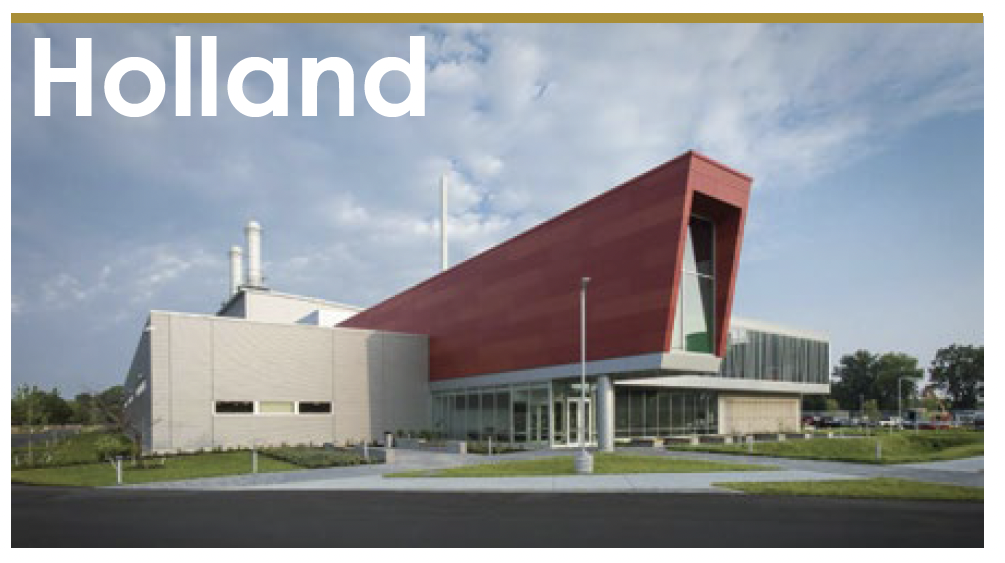

Holland Energy Park, Owned and operated by Holland Board of Public Works {RM]
145-MW, gas-fired, SGT-800-powered 2 × 1 combined-cycle cogeneration plant located in Holland, Mich
