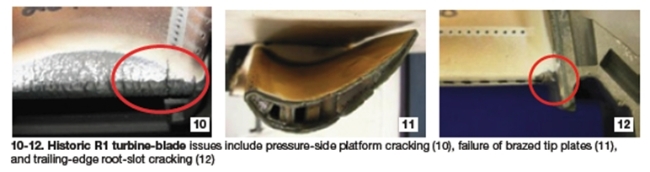

He began by reviewing some of the common failure mechanisms for R1, with a focus on blade tips and platforms (Fig 1). Lau explained that oxidation reduction/avoidance is important in both failure areas, and weld-filler alloy selection (Fig 2), improved cooling schemes, and advanced coatings are the best tools in a repair facility’s arsenal to achieve this goal.

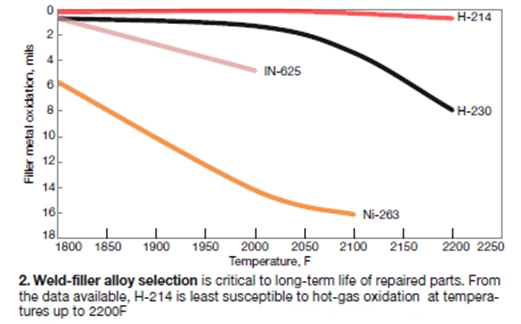

The repair expert defined the chemistry and properties of the blade base material (738LC) and repair-alloy candidates. ACT uses Alloy-214 to address platform cracking issues, Alloy-230 for tip welding, and Alloy-230 for most tip-plate replacements. He mentioned that an alternative nickel/cobalt tip-plate alloy sometimes is selected for engines in peaking service.
Lau reiterated that although properties like ultimate tensile, yield strength, toughness, and creep resistance are important, oxidation resistance is paramount for weld-filler alloy selection at the blade tip, where stresses are relatively low. Tip-cap configuration and geometry also are important and converting tips to a welded-in multi-plate design reduces the risk of blade-tip liberation (Fig 3).
On blades with severely distressed platforms, ACT uses a patent-pending process that incorporates an engineered sintered preform made of Alloy-214. Lau said that the preform’s properties are engineered with high uniformity, oxidation resistance, and low porosity. The process removes the distressed area via machining until all cracks and oxidation-affected areas are eliminated. Deep cracks are “surgically” removed and welded prior to continuing the platform restoration process.
After a proprietary cleaning process, ACT restores the area with the sintered preform and Capillary Action Bonding (CAB) process in a vacuum furnace. The final step in platform restoration includes machining of the platform geometry and the addition of cooling holes.
Although the coating systems are an integral part of advanced-technology blades, Lau  noted that diffused internal aluminides often are overlooked despite being critical to protecting newly deposited repair welds and cooling holes (Fig 4). The trick to applying internal aluminides during the repair process, he said, has been to find a cost-effective coating that does not block existing internal cooling passages.

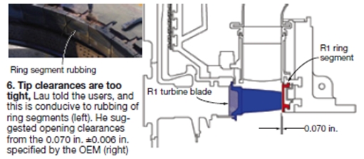

Lau ended his presenation with a discussion of blade tip heights and clearances. The design clearance is too tight, he believes, and should be increased by as much as 40% (Fig 6). Lau added that a repair shop should never decrease the spec tip clearance; he also advised attendees to consider dimensional distortion and coating clearances during the restoration of R1 ring segments.
Lau’s concluding comment to the users was that several of the mods discussed could be applied to new or pre-engine-run blades. If applied correctly, these applications can improve the repairability and overall life of the blades, thereby significantly reducing costly fall-outs.

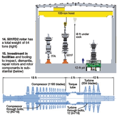

Sulzer Turbo Services’ Engineering Advisor Fernando Romero offered an instructive look at the dismantling of a 501FD2 rotor, inspection of its component parts, appropriate rotor repair methods, and reassembly (Fig 14, 15). He said Sulzer had done work on a dozen such rotors, dismantled six, and found failed components on two of the six. To learn more about rotor disassembly, read “Recovering from a wreck,” which appeared in the 4Q/2009 issue of the CCJ
The first case history Romero discussed was a rotor that had been removed from operation because of high vibration resulting from a turbine blade failure. The aft end of the third turbine stage had high run-out and a 360-deg, 1-in.-deep crack was found at the third-stage pilot. Fracture surfaces showed evidence of heating, rubbing, and beach marks indicative of fatigue. Corrosion pits were easy to see on the OD of the rabbet fit under an optical microscope. A scanning electron microscope revealed corrosion pits at the crack initiation sites.
The rotor showed no signs of intrinsic material defects that could have contributed to this failure. However, corrosion pitting was linked to the dozens of initiation sites found at the OD of the part. An insert was designed to take the place of the pilot, which is only used for assembling the machine. The design was qualified by using finite element analysis.
