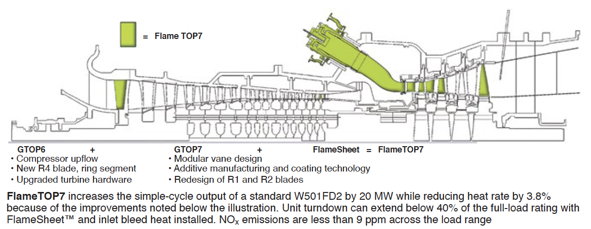

The numbers are eye-opening: 20-MW gain in simple-cycle output, 3.8% heat-rate improvement in simple cycle, a stable GT turndown to 38%, and less than 9-ppm NOx across the load range. That’s what PSM and Salt River Project’s (SRP) Desert Basin Generating Station reported at the 2021 501F Users Conference after upgrading a 2001 vintage Siemens 501FD2-powered combined cycle with PSM’s FlameTOP7 technology, a first-of-a-kind for PSM on a 501F engine (figure).
Desert Basin has been a 501F fleet leader for two decades. This pioneering installation is no exception. But as Desert Basin’s Moh Saleh and Jess Bills report, you can’t avoid a few challenges along the way.
Design aspects of PSM’s technology progression with GTOP6, GTOP7, FlameSheet™, and AutoTune have been explicated several times in the pages of CCJ (most recently, the last print issue, No. 65, 2021). FlameTOP7 essentially integrates the gas-turbine optimization aspects of GTOP7 with the output and efficiency improvements from the FlameSheet combustion system, with AutoTune thrown in for good measure. GTOP and FlameSheet are hardware upgrades, while AutoTune embodies advanced controls.
Here, the focus is on Desert Basin’s install and initial operating experience, based on material presented with PSM at the conference, and a follow-up call with Bills and Saleh.

Conversion from the original DLN (dry low NOx) hardware to FlameSheet was “seamless,” noted PSM and SRP, “the OEM’s fuel manifold was adapted to the new combustor.” However, when the units were first fired up with the new technology, the plant experienced some failed starts and incomplete ignitions. “GTs are very sensitive to fuel and air flows,” Saleh reminded.
The more stubborn problem, though, was that NOx emissions were initially much higher than expected at loads between 70% and 100%, higher than was demonstrated in PSM’s lab. The original permit limit was 25 ppm, but the new guarantee point is 9 ppm.
PSM specialists Brian Micklos, senior manager of product management, and Brian Kalb, lead tech for combustion mechanical design, described “runback events triggered by elevated flashback,” or in simpler terms, “the flame wasn’t where it should have been.” One liner experienced physical damage. The runback logic was revamped to prevent these problems, but the problem was that the combustor was running off of its design point.
PSM did some additional modeling and found unexpected air and fuel flows. Specialists added high-temperature thermocouples inside one combustor can, found some anomalies, and tweaked the FlameSheet liner with some expert welding. That helped, but a second “liner tune” was necessary. It involved “reworking the meter plate and flow sleeve” and additional welding modifications. The hardware tweaks were confirmed with CFD and air-flow testing.
Once the fuel/air ratios across the multiple fuel circuits were rebalanced, the units were able to achieve sub-9 ppm across the load range; reliability also greatly improved, as the combustion dynamics were much more stable after tuning. CO emissions were tuned to 7 ppm at 70 MW, and 10.5 ppm at 65 MW.
