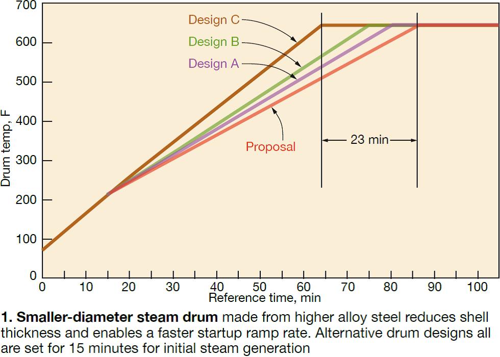

Flannery spent about 10 minutes on pressure-part design considerations to accommodate fast starts and cycling. He began with a review of the all-important HP drum, made of carbon steel, which is used for steam/water separation and to maintain adequate storage volume. The ability to reduce drum size (read shell thickness), he said, contributes to faster starts and ramps, as the table confirms. Today’s tools for finite element analysis help engineers design for minimum thermal soak time.
The table shows how drum design parameters impact the ramp rate of a typical F-class combined cycle. The standard offering described in the first column would be a 6-ft-diam drum made of 516 Gr 70 steel and having a shell thickness of 5.25 in. Storage time is the industry norm of 3 minutes, the allowable startup ramp rate 6 deg F/min.
Fast forward to Design C: With a startup ramp rate of 8.75 deg F/min it can reach rated output faster than the other options. It employs a higher grade of steel for a relatively small financial penalty. SA 299 typically costs less than 5% more than the baseline 516 Gr 70. The smaller drum is made possible by taking exception to the 3-min storage rule, the speaker suggested. The rapid-response capability of modern control systems is said to allow the reduction in storage volume to 2.2 minutes, possibly less, without compromising plant reliability. Fig 1 illustrates the advantages of Design C well. It comes up to the desired drum temperature in 64 minutes, compared to 87 minutes for the reference case.
